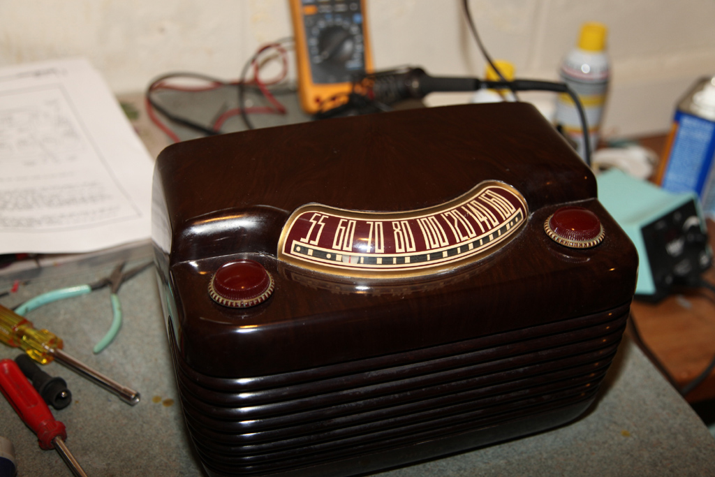

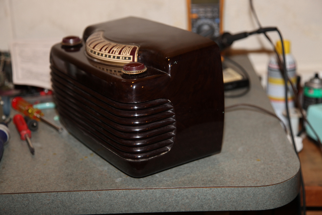

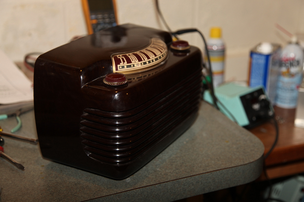

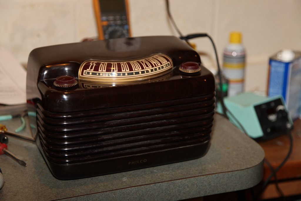

I polished it a bit, cleaned the chassis, washed the knobs with toothbrush and dish soap. One happened to be cracked inside, not visible and holds well, but was enough for the leaf spring to fall out, good thing I noticed.

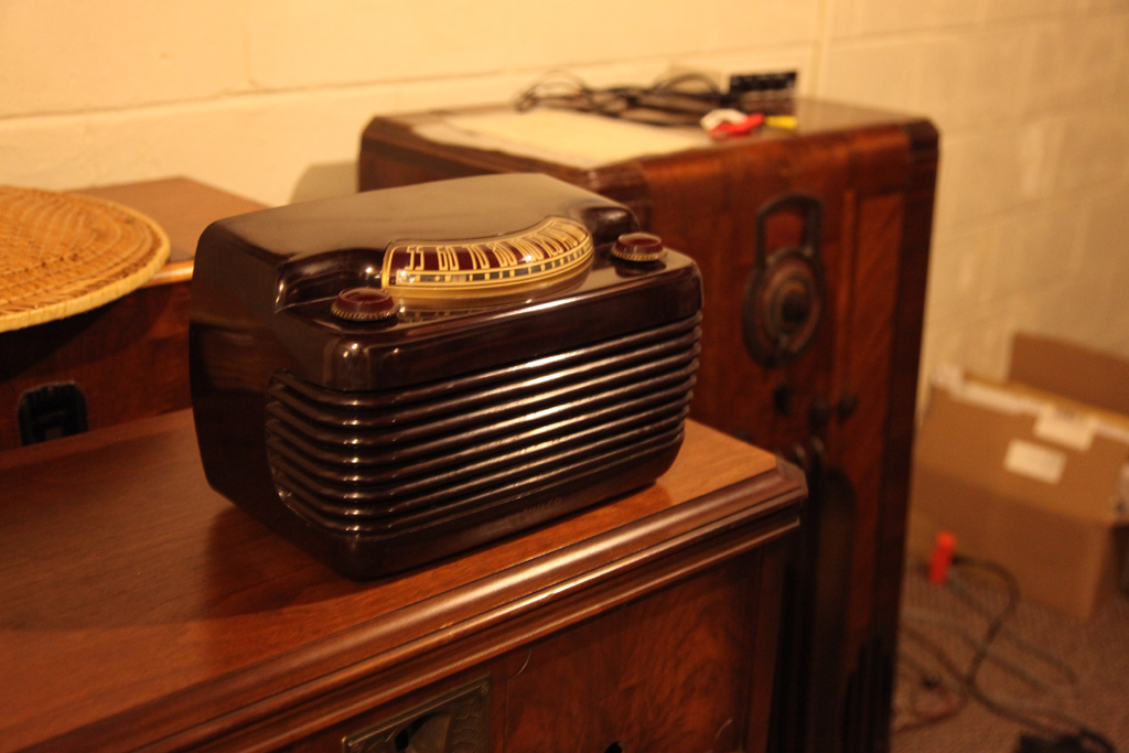

Here it is assembled.
Out of the workshop.

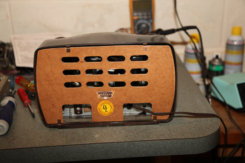

Very nice, Mike! Icon_clap You are fortunate that the back was still in place and in nice condition. Even more so that the clips to hold the back were still there. As far as I know the clips aren't available anywhere. I had to make clips for mine.
Greg V.
West Bend, WI
Member WARCI.org
Greg,
Yes, I specifically was looking for a complete radio, with the backing and all. It was a surprise it came at a very good price too.
