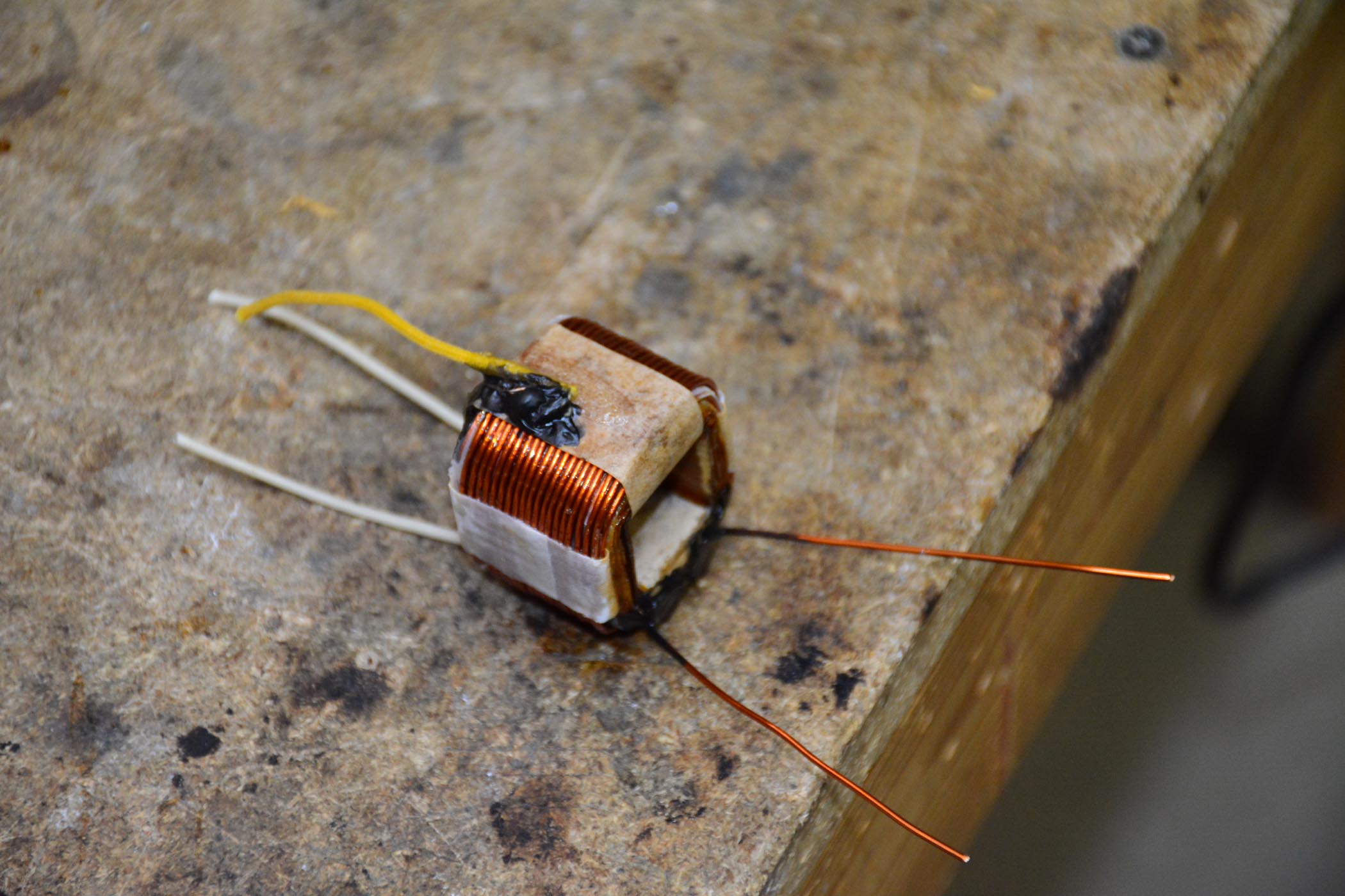

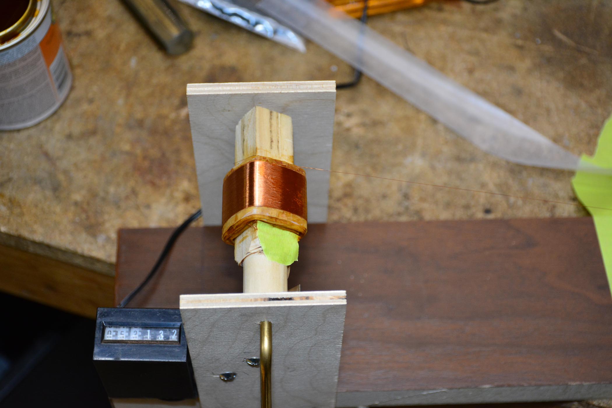

How do you hold it in place? Do you use some wax of some kind? Did you make some sort of coil winding machine that will lay the fine wire down nicely?
As far as thickness, it was interesting that between layers, there were sometimes 1 layer of paper, other times 2. Don't know if there was a reason or just carelessness on the part of the operator.

I held the paper in place with shellac (Bullseye brand from the Hardware store). Something similar was used in manufacture. I cut strips the correct width, trimming them to length after wrapping to achieve an overlap of perhaps 1/2 inch. The windings were painted with shellac, and the paper also "pasted" with it.
Yes, I built a coil winder, Please see my 16X thread here in Electronic Restorations for details of the transformer rewind setup. Looking across the 'net, there are a few ideas for this. I found it took quite a bit of experimentation (learning from scratch). The dissection process of the old windings should also be done with care, notes and pictures - once it is gone, it's gone!

I like your coil winder! Is that a hand crank on the side or do you motorize it? Also, do you find that the fine wire will lay without crossing on its own if you keep a very slight angle on it? I'll be using the 35 gauge wire for the primary as well. Pretty fine stuff.

Hand crank, for lack of a motor, but that also enabled good control. The wire will lay without crossing if one is careful to set up the bobbin nice and true. It also helps to pack it a little to bulge the sides - this particularly for the first few layers. Once the stack builds up, it tends to have convex rounded surfaces, and the wire takes up with the angle as you say. I also found it helped to put a new paper under the first layer, to smooth the surface.

I'm going to try it! Since I have a new OT for this radio, it's not the end of the world if I totally botch the job. I just think it would be fun to try. Wire will be here on Thursday, but it's going to take some time to build a winder.

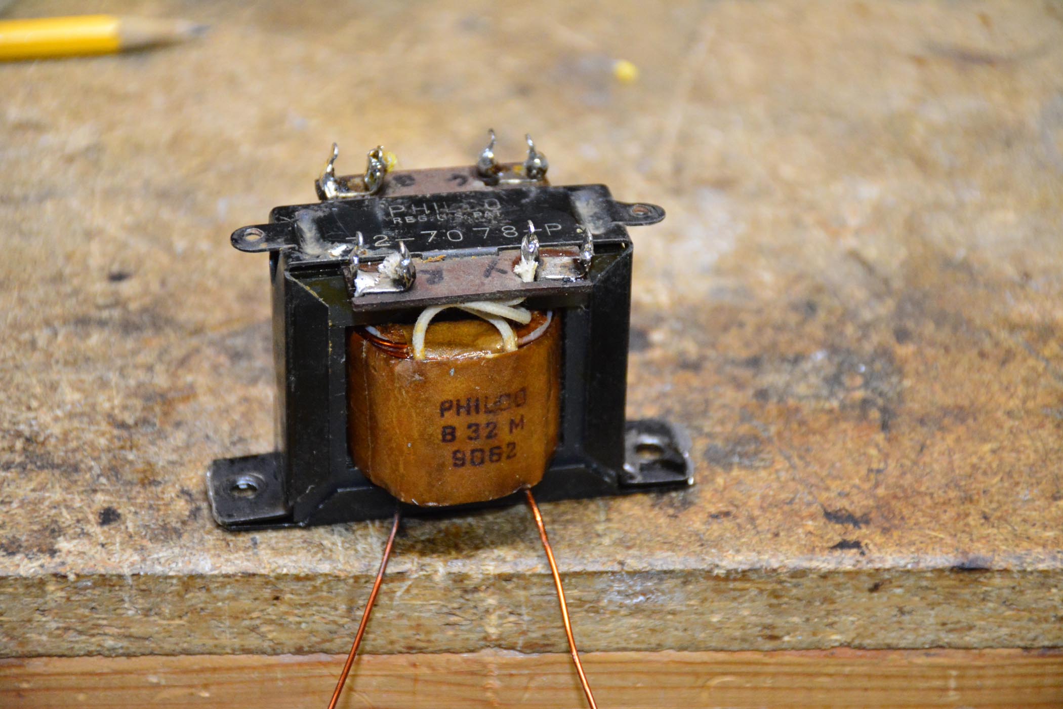

Success! Finished rewinding the output transformer for the 14. I didn't really need to since I had purchased a universal replacement that worked fine. However, My 96 chassis also has a bad output so I thought I would practice on this.
finished product works great. Heck of a lot of work, though. Now I get to do it again for the 96.

Easy!? that represents probably 3 days work and frustration! As with many things, it's one thing at a time until all added up, it's done. Even though that one transformer cost many $$ in time, there is a sense of satisfaction when it's done and it works. There doesn't seem to be a universal replacement for the 96 output transformer that matches at all closely. So, for it to be correct in the impedance area, I have to rewind it. No Doubt, the universal I have would work and no one would hear the difference. That transformer would look ugly sitting on top of the 96 speaker. I've already disassembled the 96 transformer so I have all the windings counted. Hopefully, with the previous practice, this one won't take as long. An advantage of the 96 transformer is that the secondary was inside the primary so I didn't have to unwind it or rewind it. The harder part is that the primary wire is even finer (37 AWG) than the one I just did (35 AWG). That much harder to keep the wire from crossing in the layers. Hopefully it won't go too badly.
