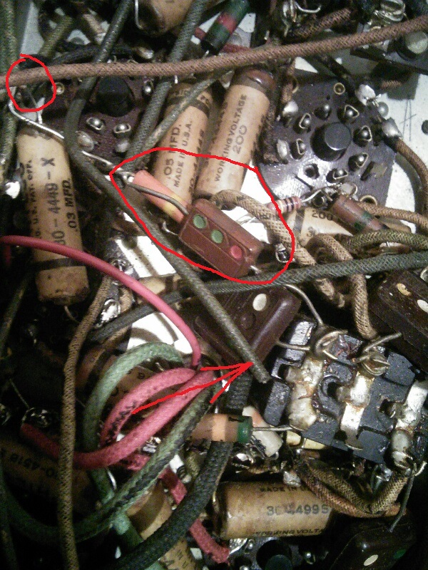

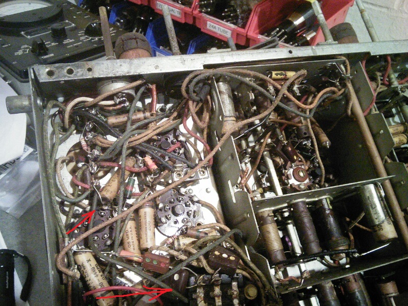

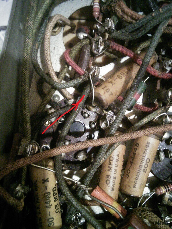

Could you do me a favor and look up one thing? I am trying to fix the magnetic tuning that somehow does not work.
While investigating I noticed a GND wire that broke of some place where it was going to from the ground lug.
These are the photos. I understand your wiring could differ but maybe it is the same. I need to trace where that wire goes to.
Mike.
This is where it ends, the broken end.
This is where it starts (GND lug)
The total pic of the wire.

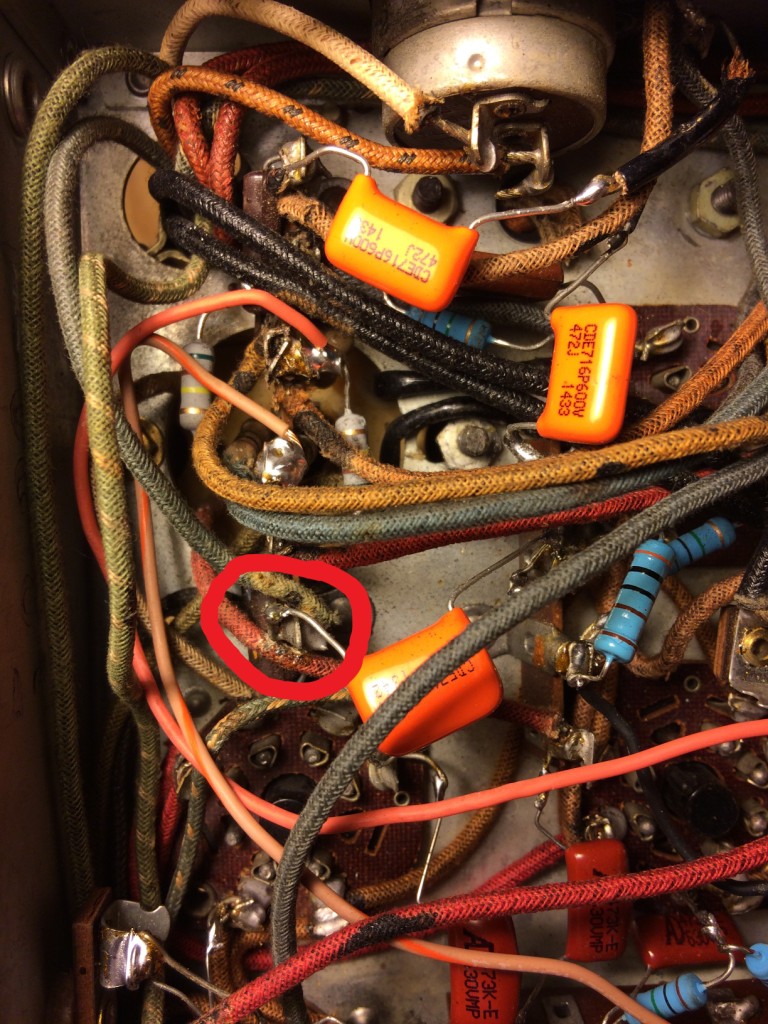

I only have one wire that goes to the cable and a cap.  I'm wondering if that is a ground for the multi-lytic #110, which I would have removed.  As you can see, I'm not a re-stuffer.  But I've been called worse. Icon_lol
BTY, you had asked if my volume goes up when I touch the antenna and YES, it most certainly does, quite a bit.  I didn't try the tube caps.  Is that the top connector on the the RF tubes?  I wasn't sure.  So does that indicate a possible open tuning coil (one of the 14 in the 690).  Please excuse if I get the terminology incorrect.  I'm still a beginner.
And here's the entire right (from top) side showing the #110 cap area.

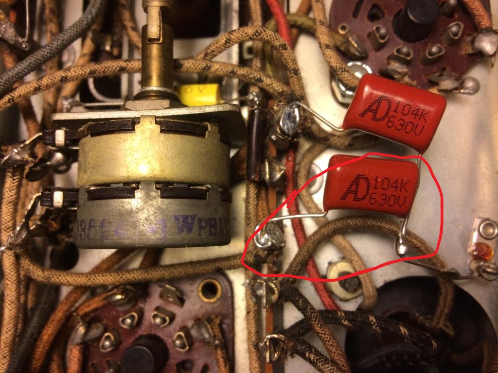

So I found a problem, don't know if it is causing the issue of the treble causing the volume to drop, but it think it could be.  The rear #67 pot has a 0.1 cap on the center terminal, which I had replaced.  Well it measures 0.65.  It's the bottom of the two identical orange drop caps.  The top one measures 0.097.  Maybe???? Icon_biggrin Icon_biggrin Icon_biggrin
0.67uF? In circuit or desoldered? In circuit it can show anything being across the resistor.
I found the photos I took before recapping, and though it doesn't show the very end, it dives under a cap, it seems it was intended to be the GND of the 5-cap lytic, and the lytic is connected, so I probably was biting off the wires and when having reconnected the lytic I used the nearest GND lug instead. Forgot to take the wire out.
Thanks for looking anyway! It confirmed what I just found.

My suspicious 0.1uF cap goes from the center terminal of the treble control then directly to ground, no resistor.  I didn't disconnect it.  I know everything is affected by everything else in the circuit, but didn't think it would in this case.  I will check it disconnected before I condemn it.

You are talking of the 0.1uF cap that goes to that 2,800 ohm pot with 500 ohm in parallel.
This will not measure correctly at all if in-circuit. You have to measure it disconnected at least at one end. It is likely good.

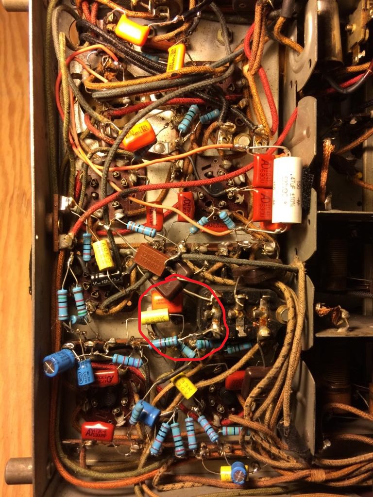

I pulled the grid cap, the tube works. I desoldered the high path (330K resistor in parallel with capacitor), only bass was left. It is there and it is ok, and is well regulated by the bass pit, but when everything is again together, the bass doesnt change dramatically. It is so low that I guess the part that goes to the high path is actually a fully balanced signal.
I didn't think my bass control did anything at first. Then after more listening, I realized it worked but didn't boost much. Also, at roughly 80% volume or higher, even though it's not very loud, cranking the bass up will cause audible clipping. So I think somewhere there is low voltage and somebody is getting starved for power. Sure wish there was a voltage chart for this puppy.
What you said about the two channels made me think of something. Would it be possible that the radio is only using the treble channel to power all 3 speakers and the bass channel is inop? That would make perfect sense of my symptoms.
This is what I was trying to make you check. Icon_smile When I ask to pull the 6K7 Bass amp.
But surest way to make sure the base is working is do what I did, de-solder the high path. It is very easy, the very first photo I posted here when asking you about that wire earlier shows it, but let me edit it to circle the parts.
The resistor and cap whose leads twisted together is the Hi-f path; the lead that has to be desoldered comes to a nice large solder post on the left (photo does not show it, it is under a wire), also circled red. Disregard the arrow - it is from the previous edit.
When you desolder it you will only have the bass left. See if it is there and if it is enough when the antenna is connected.
