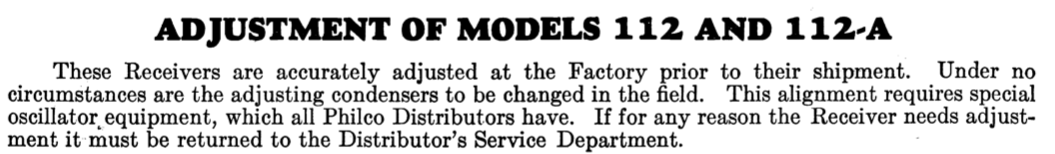

In fact the official Philco service bulletin for the 112 (#101 in the case of this model with 47 tubes) doesn't even include alignment instructions:
I guess not many service people had the right equipment when the 112 was released?
Actually there is another service bulletin (#60) titled 'Adjusting Model 112' that might have that - but I don't have that bulletin in any case.
