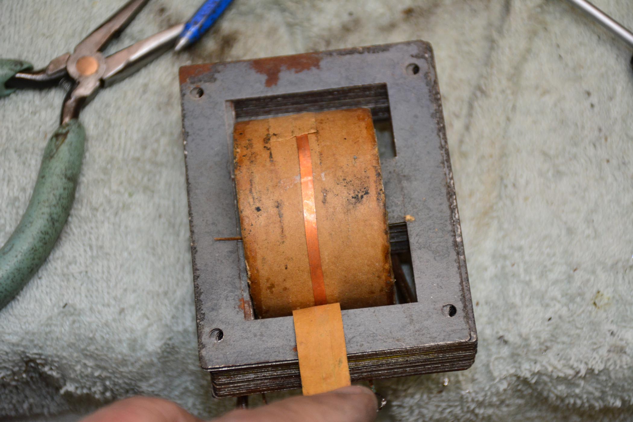

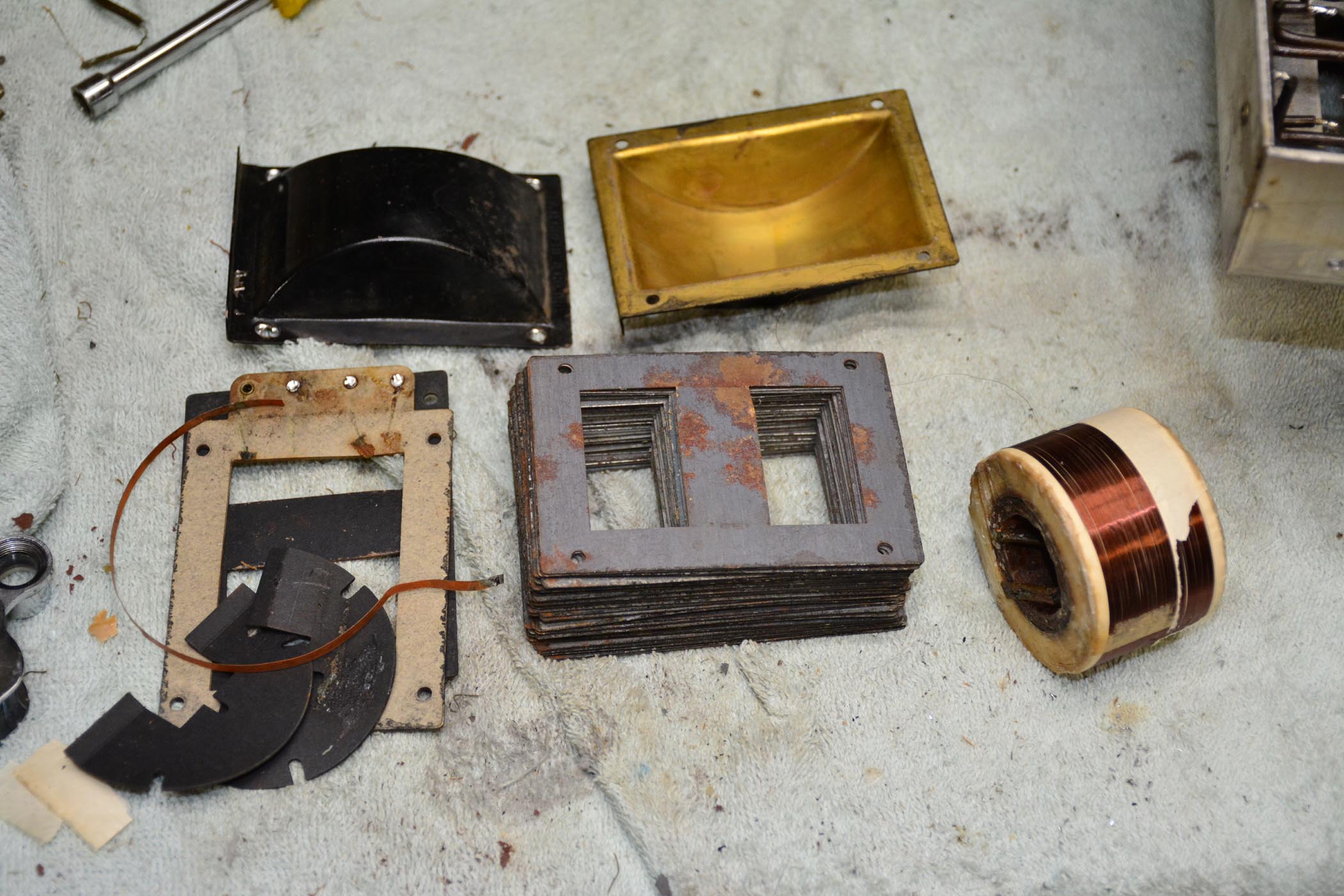

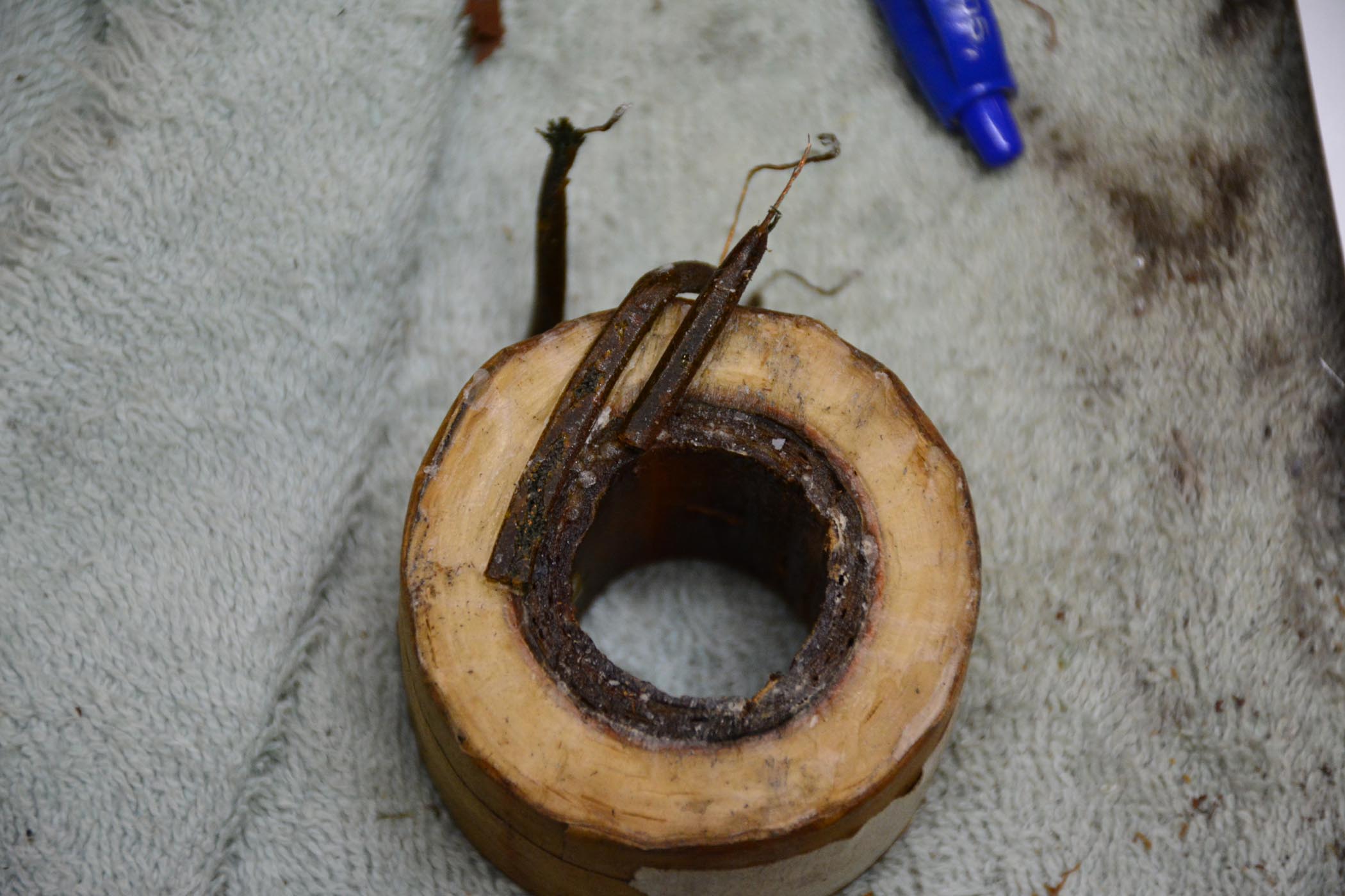

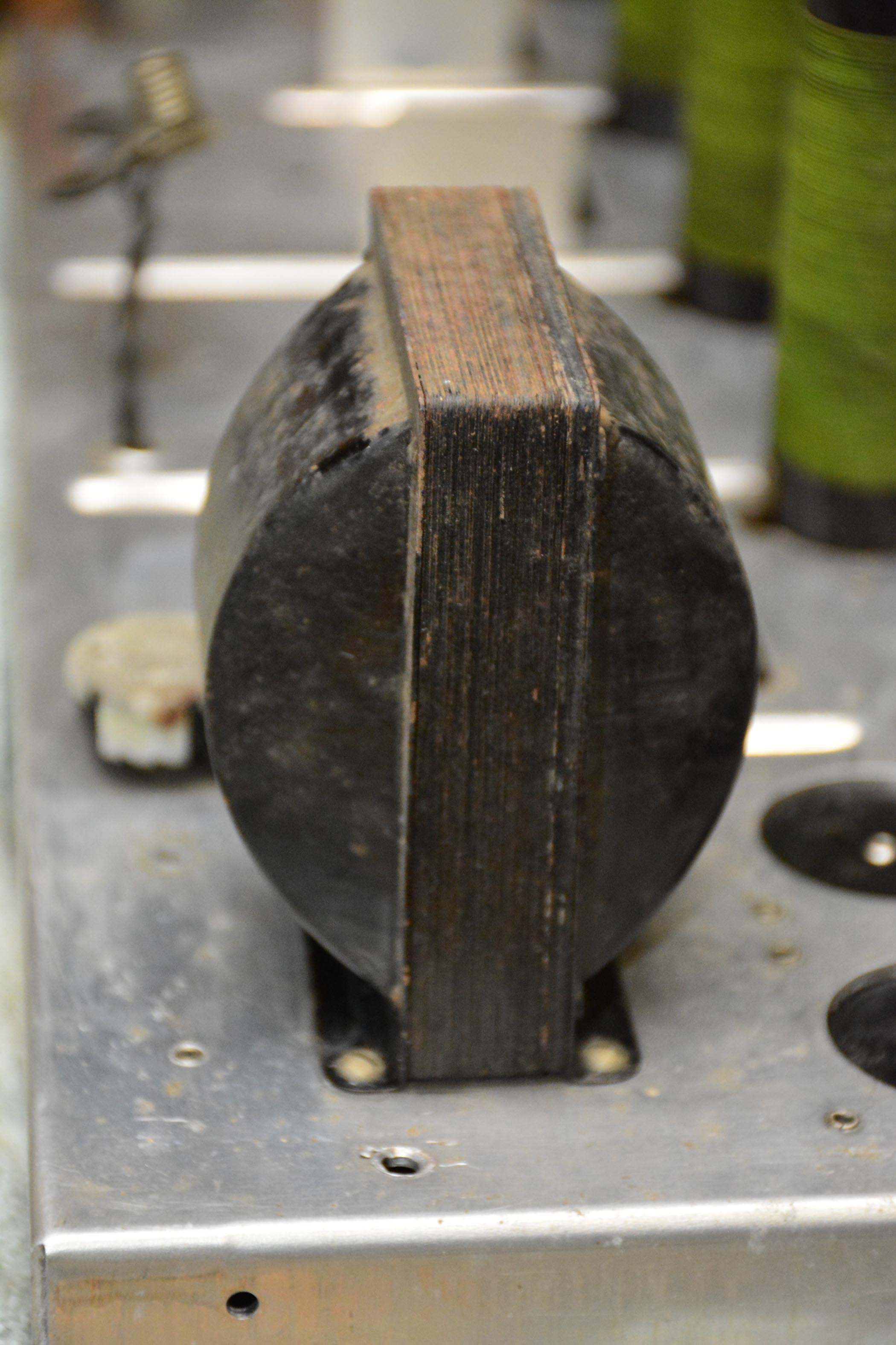

things can never be simple! another audio transformer with open secondary. this one uses 40 guage wire for the secondary and there is probably close to 8000' to wind! the primary is about 500 ohms and the secondary should be 8000 ohms. That's based on the other transformer which I believe is the same.

If the iron core is 1/2" AES has pre wound bobbins that can be fitted to the old core. They are 1:3 ratio.

Thanks. I'll look at it. I suspect that my ratio is a bit different, though. It may not be critical enough to care. I just want the radio to work. I won't be using it seriously.

Is there a picture of your audio trans? What is the core size?

I just measured the core and it's 13/16". A little big for the AES unit. To keep it looking reasonably original, I would prefer not replacing the TR. Do you have another suggestion or do I re-wind? it shouldn't be too dificult to re-wind - just a lot of layers of 40 guage!

The .75 (3/4") might work. You could remove and or file a few of the laminations.

I am really enjoying this thread, and admire the attention to detail, and the chance to peek under the covers at something of this vintage and understand the challenges it presents.
It is interesting to see that the transformers used round coil formers. It seems to have many, many layers!
If I might ask, are the laminations separate E and I forms, or are they one piece with a break in the center to allow assembly of the bobbin? I can't quite make it out from the pictures.

The laminations are 1 piece with the cut right at the end of the center pole. You can just make it out where the rust is. It appears that, when they wound the TR, they did not use varnish or shellac to set the windings in place. They are loose on the paper. I can push them side to side. This would make it easy to unwind if I go that route. The 3/4" core unit may be a possibility rather than rewinding but I would have to file down the laminations to make it fit. Right now, I'm leaning toward a re-wind. I have the wire on order. It should be easy to put the old, round bobbin on my rewind rig and count the windings as they come off with the electrically actuated counter on the unit. The no fun part is getting the wire wound with out crossovers and laying paper between every layer. As per Ed's advice, I use shellac to secure each layer's windings in place before I start the next layer. My initial measurements and calculations point to nearly 50 layers! The primary is on the inside and measures fine so I can hopefully leave it alone.
