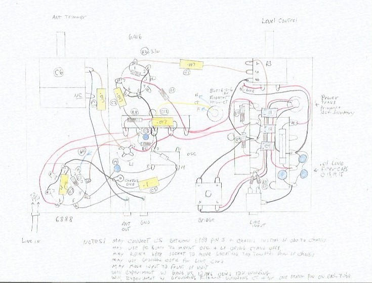

Got most of my parts in. Doing an initial mock up. Still drawing and redrawing the underside. Will try to post a sketch when I get I am satisfied with the layout. Like the schematic Sam posted. I may mod the power supply slightly to simplify. So, doing some planning and sketching. I don't know how sensitive these are to layout. I have seen some that had wires and such criss-crossing and going all different ways (not my style) and others that were very neat, like those posted here.

Tom, it might be better to use a 6v tube. Anyway, I have done a rough sketch of my proposed build. I am sure I will adapt some minor changes as needed, but this is an overview of how I plan to build. Comments or suggestions welcome. Here is a list of things I may change: I may add an LED indicator light, put the input on the front, near the level control instead of the back, and may make some changes around/about the antenna coil. There is quite a bit of room as far as height under the chassis, so some things that look like they are on top of each other, like the line cord and input jack, there is actually an inch or so of space between.
EDIT 3-25-18: I found a wiring error on my 1st diagram. Here is a corrected layout. I turned the 6888 tube to move the plate closer to the antenna tuner, but I may turn it back the way I had it first. I also may move the C5 to connect to pin 5 of the 6888 instead of the oscillator to simplify. I may mount the Osc to a PC board as well as to support the antenna coil, L1. I didn't show the filament wiring as I'm not sure how I am going to run it yet. This is from the schematic Sam posted.

I have been reading and studying, drawing and redrawing. I haven't heard anything either way, bad or good about my proposed layout. I think the biggest things are to eliminate hum, feedback and static, which I have tried to do by separation, grounding, etc. So  Icon_biggrin Let the construction begin!

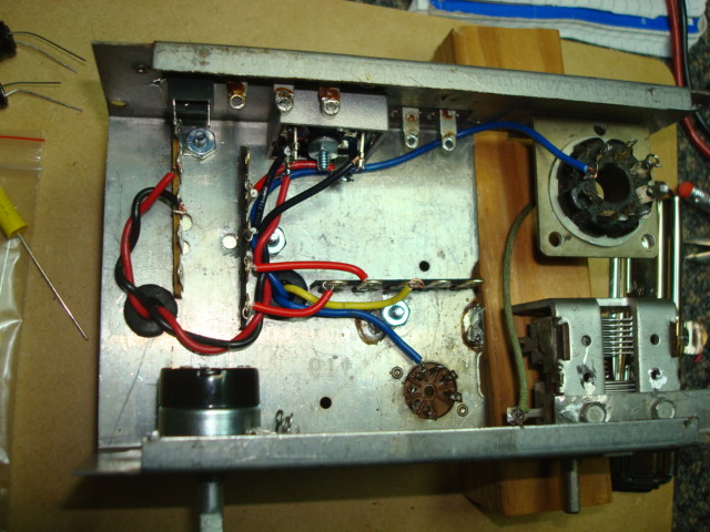

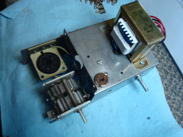

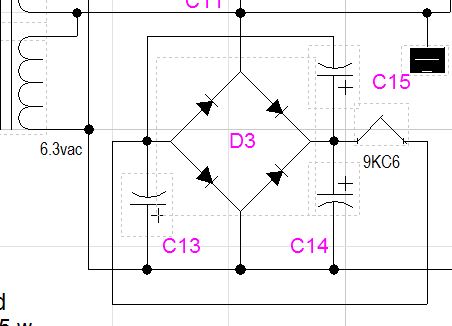

I have the bridge installed, and power transformer wiring in place. I am changing the value and size of a few caps due to space, or lack of. I am going to use 250v poly caps, since they are smaller. Should be plenty of breathing voltage wise, and slightly smaller output filter caps. I will use the specified 47 uf input cap, and going to try 22uf output caps. Figure they should be adequate since this is a full wave PS. I am debating on my line caps - schematic calls for .01, which I have, and are rather large. They would fit, but ... again, big. I may try .001 and see what I get. I don't know how much difference the size of that cap would make in filtering noise, RF, etc.
Tim
I am reviving my thread since the weather has turned colder and my work season is over. I sat and studied things last night for awhile. Kinda hung on the mounting of the osc and coil. I have some coils that I got from China in different values, (they look like resistors) and an antenna coil. I think I have an idea of how I am going to mount things. Probably making 'work' out of this... I want to get it running and have something to so I can enjoy those old radios that I am restoring.
