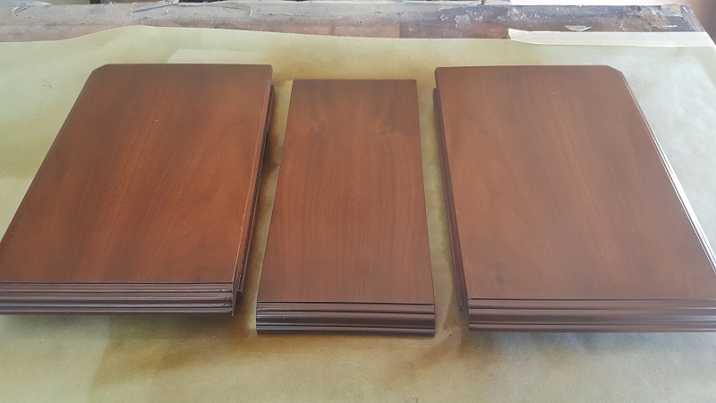

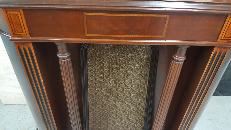

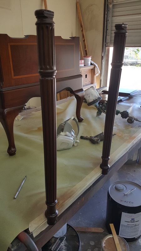

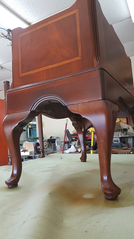

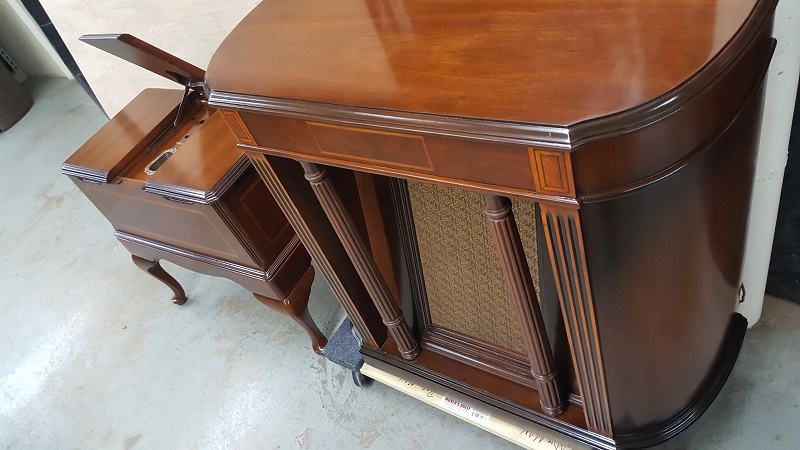

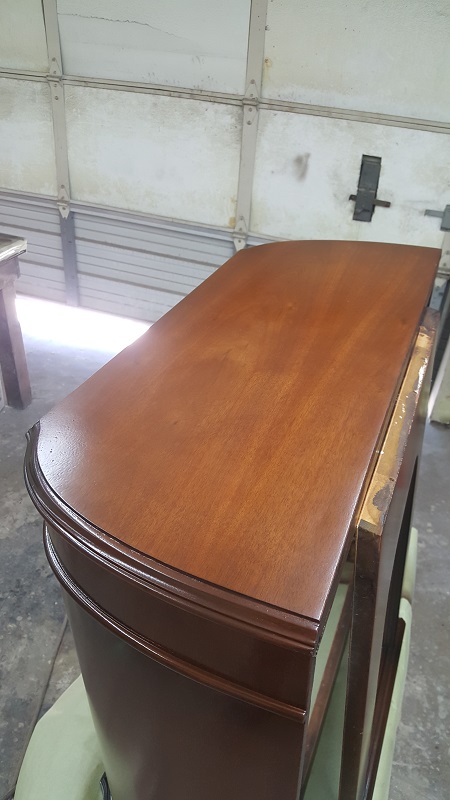

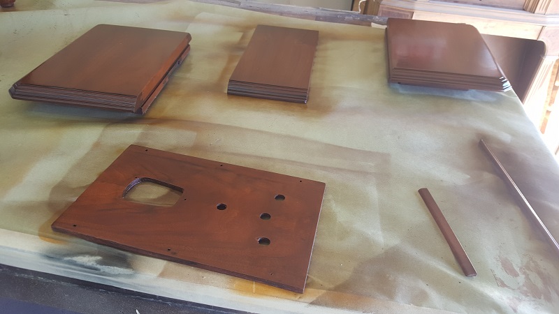

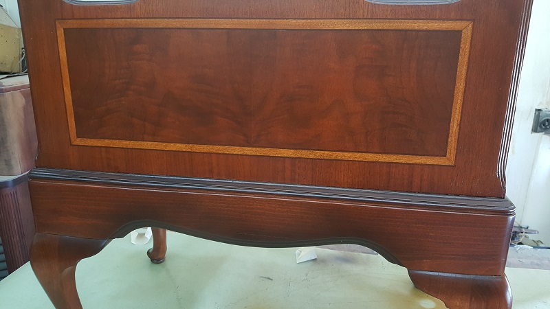

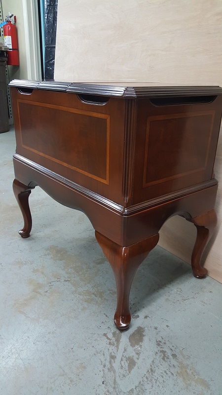

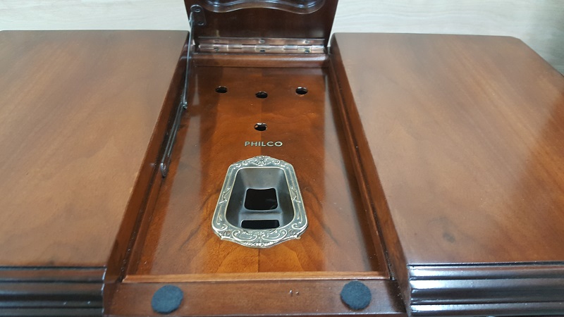

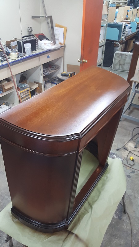

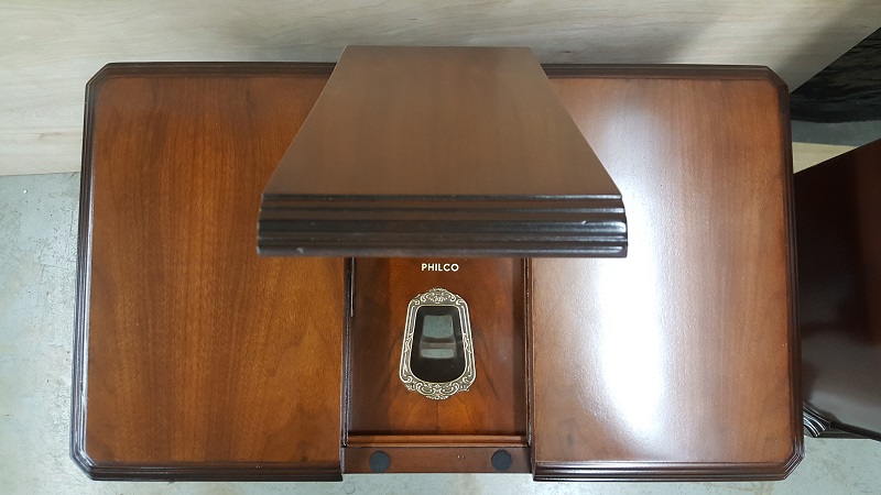

Busy as a Beetle over the weekend, had to go to regular job Saturday and paint a Mercedes Benz then I went to radio shop and worked on the Philco, sorry but no book match veneer this time on the radio top, didn't want to spend the $85 on the wood just for the top never get it back. Although the walnut veneer I put on has some very nice grain pattern running thru it it will be very nice once finished. The toning isn't factory but really looks nice, the finish isn't done yet. I have to sand the sealer which your seeing in these photos, then apply the final coats of clear lacquer and the gloss level will be higher. The speaker cabinet has new walnut veneer on the top and matches the radio cabinet, the factory had walnut running fron left to right on the speaker cabinet. Still waiting to hear from radio daze on the dial, next week I will finish the radio and speaker, new cloth for speaker and a new back cover will be made but I'm thinking about using  1/4 wood that will be stained and cleared and perhaps not drilling the holes. I'm thinking the radio may have more Bass if I don't drill the holes in the back cover, what do you thing Ron?

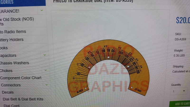

Hello Ron, radio daze has this dial its for a miodel 18lzx I'm wondering it sure looks like what I need , will this work is what I want to know. Thers a few little deferences in the short wave band numbers but not much and the size of dial not sure if same size as 91? or the 14lzx chassis.
It will have plenty of bass with the proper back. It's up to you if you want to install a plain back with no holes, though.
Will it work? Yes. Will it be authentic? No, simply because the 18RX has a different coverage on its band 2 than does the 14LZX (1.5 to 4.2 mc in the 18 versus 1.4 to 3.3 mc in the 14LZX).

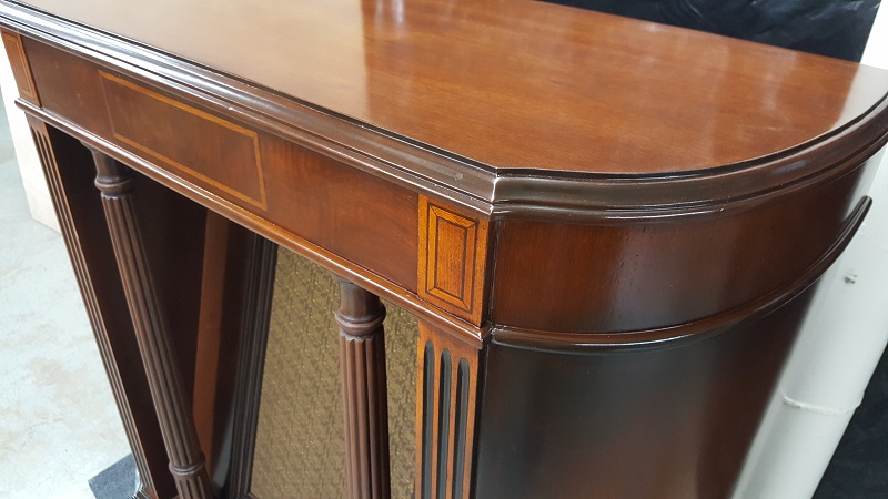

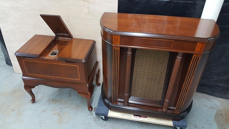

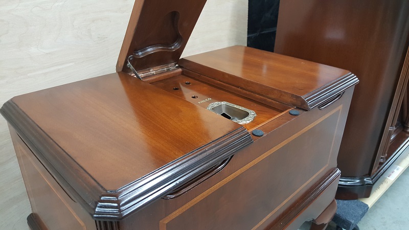

Finished up the cabinets except the back cover for speaker, the walnut veneer I replaced on both tops on speaker and radio came from same sheet and match perfectly. No book match on radio, the veneer was very expensive so I decided not to go with it . The toning was done to give the pieces a little bit more character and style , more than what the factory had done. This set would be a great addition to any radio collection. I will post pictures of the radio when I get done with the chassis and have it installed.
Few more pictures, the speaker cloth from Radio Daze and is the cloth for the 90 cathedral, so I kept the pattern in the family.
That looks good Fred.
ALL ,,I ,,,CAN say is ------SHOW ROOM Material
Fred, your work is amazing!
