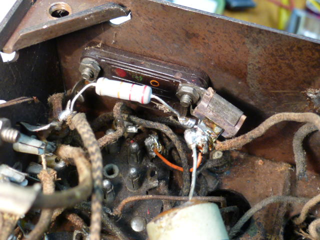

    This is turning into quite the nightmare, Can anyone tell me what this component is it is listed as #24399 on page 5-3 but not listed in the parts. Is it just a tie point?
That is a tie point. I remember trying to figure that out.

It looks to be a one lug terminal strip. The resistor goes over to the choke in the p/s and feed the hv to the audio output stage. The little brown thingy is C -27 a hv mica cap that is part of the tone compensation circuit. All those parts have hv on them. That schematic is really hard to read as the connections that cross over and ones that join are noted poorly.

Good info about about the tie point just looked weird.

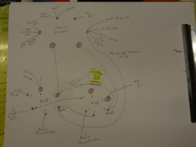

The Output ckt appears to be wrong on my radio per the print as C27 is there but not R16 (30k) and they should be in parallel with the output xformer?
Also other wires on the 41's seem to be wrong? Will post a drawing.
Here is a diagram I made sorry if it hard to make out, now something that just jumped out at me is that one of the 41's was missing is it possible that who worked on this rewired this for one 41 operation? I labeled the 41's as A & B
Yea that is kind of hard to figure, for me anyhow... If the wiring has been altered could be a challenge to put back to original but doable.

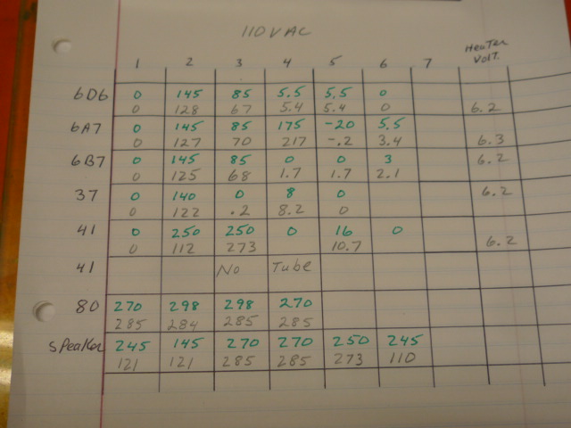

here is the voltage chart I see a problem with the 6A7 pin 5
I take it that the top voltage is should be and the bottom is what you got??
Yes the green is what the schematic says should be.

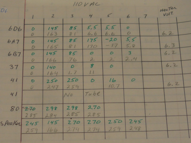

A couple of things stick out to me. Pin 4 of the 41 should read - 16vdc. Having +10vdc on it will cause the tube to draw excessive plate current. This maybe why pin 2 only has 112v. If it's a typo your output transformer is trashed, replace it.
The IF adjustments it doesn't really matter where the tuning dial is set. Inject a 370kc signal into the cap on the 6A7 and adjust the four trimmers inside the IF cans for max sound from the spkr w/the generator set @ minimum output. Note two of the four little screws have HV on them so insulate your tuning tool if it's not plastic.
It's not unusual for the grid 1 voltage to vary w/oscillator frequency (as you tune the dial). Typically it's abt -2 or 3 vdc so the .2 would indicate that the oscillator isn't working but since you have a few volts - it would seem to be ok. If you suspect it you can listen for it @ 370kc above the dial reading on another receiver.

Ok I did some poking around and went back over the paper work. The dial has to be set at 1500 kc and that corrected the .2 on the 6A7 pin 5 now -17
I rechecked the opt and it is new and the resistances were good but that got me to thinking so I swapped the center tap per Mike's print to the other side of the FC coil and the numbers came in as you can see. Still no stations but I have to leave it for now Heading to my sisters for a Birthday for Mom she turned 97 boy I wish I had her mind!
