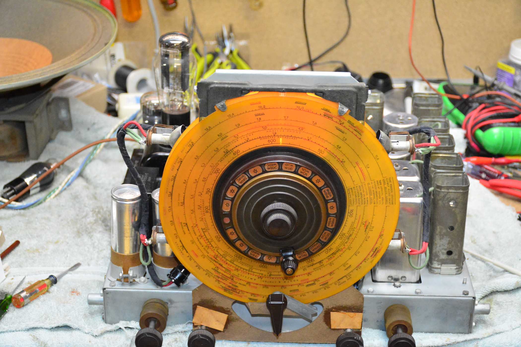

Almost completed, waiting for some wire for the speaker cable.

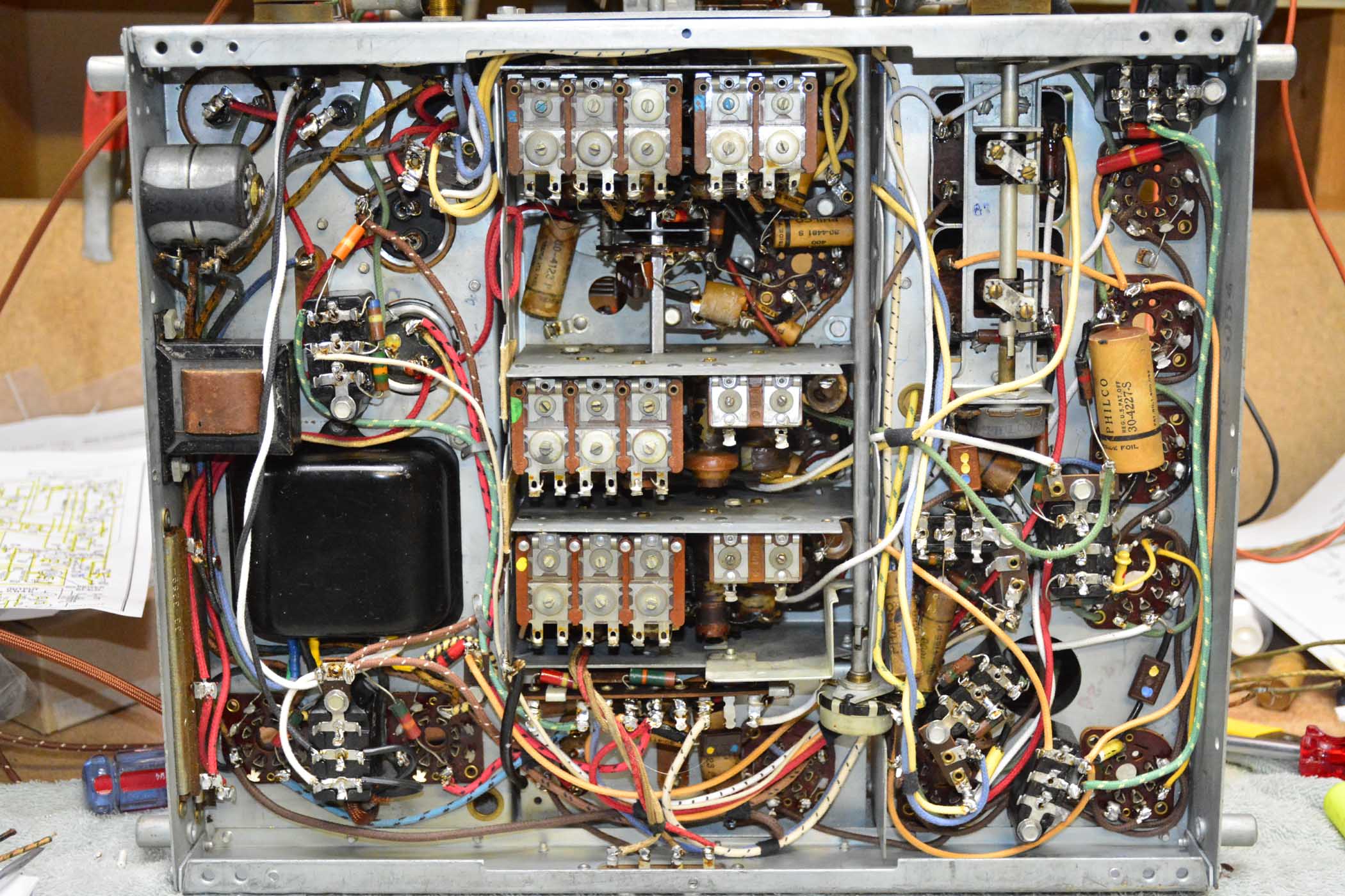

Underside.  All caps stuffed, all resistors original and good. Most of the wire replaced to get rid of the "crispy" wire.  Only the antenna wires and a little bit of the low voltage (filament) wire is original.  the wire that is original has been saturated with clear acrylic plastic corona dope to help insure good insulation.

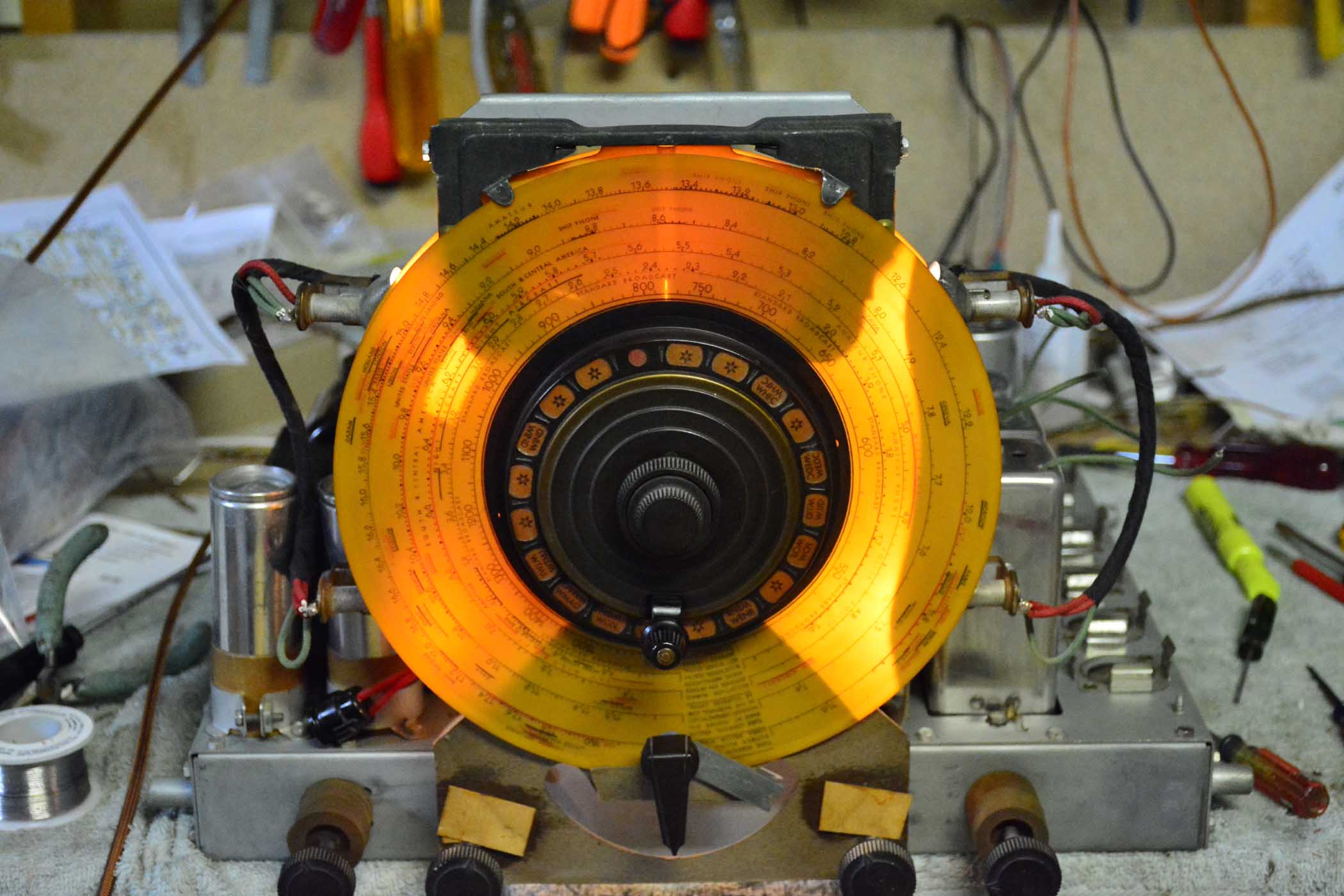

And behold, there is light.

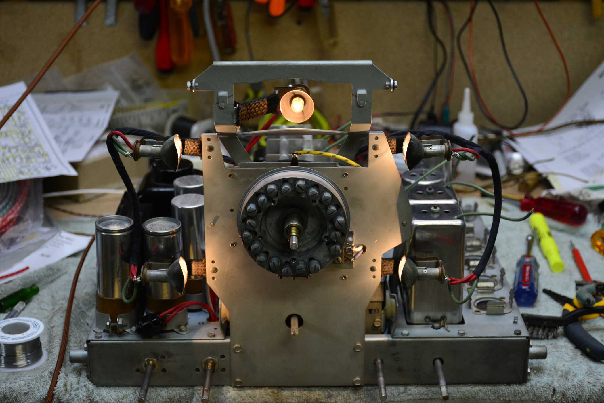

Question for Nathan, or whoever has experience with this system.  When the Magnetic Tuning is ON, the flood lights are on to light the preset dial.  I have polished the reflector ring but the amount of light that gets through to light the station identification tags is minimal.  I can see the effect when the ambient lighting is very low, but it is still dim.  The light from the reflector ring has to pass through the band selector plastic, dimming it considerably.  Originally, was the plastic, or whatever it is, that opaque?  Probably hard to know unless you lived back then!

I've never seen one of these sets that didn't illuminate the call letter tags very dimly. I think it's just the nature of the beast. Given what (in my opinion) is a poorly designed RF unit, designed with no serious thought as to future repairs, it's a wonder it illuminates at all.
I have no doubt the dial scales and the plastic were lighter when they were new, and have darkened over the decades. I don't think they were ever off-white or yellow, but were always amber. Just a lighter shade of amber. If it really bothers you, you could find some thin opaque white plastic and cut out another shadow mask (the piece behind the dial scale).
I would try to find the brightest LED lamps I could find which will fit, and try those in the call tab illumination sockets.

I admit that I haven't been following this thread until now. Where did you get wires with tracers for under the chassis?
Edit: Nevermind, I found the answer on page 1 of this thread.
http://www.riwire.com/
18 gauge wouldn't be a problem to replace what was originally 20 gauge wire. Slightly thicker, but then so is the modern reproduction "rated" wire in 20 gauge from Radio Daze and Antique Electronic Supply.
The light will become more noticeable once the chassis is inside the cabinet. I cannot complain, they illuminate quite enough.

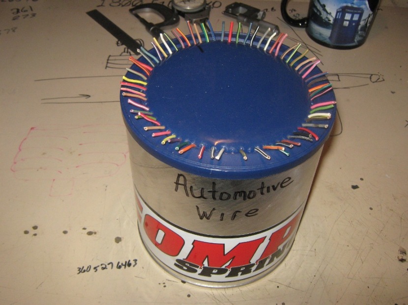

to store wire from an auto harness,, i have consolidated it by simple means.
use a small bucket with lid or kitty litter container with lid.
punch in holes into the lid with a 1/8'' drill bit or just a small punch/lether awl
bundle the whole harness and drop it into your bucket in a coil fashion.
feed each wire up into the bottom side of the lid and pig tail it on the top side
you should have enough holes for all your wires plus room for growth.
put the lid on.
when you need wire, you pull it up  and cut off what you need.

the reason i say kitty litter container is that it can lie on its side on a shelf, lid facing out,, stows away in a very small footprint on the shelf,,, which is far superior to individual wire rolls / reels which take up lots of space.

Yes Ron, the tracer wire did come from Rhode Island Wire.  They have quite a selection.  It is un-tinned, 18 gauge, stranded.  Total diameter is a bit more than the 20 gauge from Radio Daze, but less than the 18 gauge from them.  They will custom braid your own wire if you wish.  That way you could use 20 gauge, 600 volt wire.  Cost and delivery time being the constraining factor.  I'm looking for an old maypole braiding machine to do my own wire!
As far as the illumination is concerned, I'll make a judgement after it is installed in the cabinet, as was suggested.  I've got my eye out for some kind of fluorescent or led ring that I could put between the shadow mask and the dial.  Then again....too much work and not very original!
Use amber LEDs, this will light it as original as it gets.
Get old bad lamp bases, after cracking and discarding the glass, solder in the LED, put a resistor and a diode in series....done.
All tubes checked, installed, and slowly powered up.  Stations all across the dial, though low volume and distorted.  At least I had something to work with.  I discovered the wiper contact on the treble control had a low resistance short to ground.  This caused the bias on the audio driver tube to vary from -14v to ov as I turned the selectivity control.  Fixed that and the radio works great... almost.  One dead band (1.5-7.6 mHz band).  The oscillator dies and there is total silence.  Before I reassembled the tuner chassis I had checked all coils and all measured ok.  I hope I don't have to remove and disassemble the tuner chassis again to find the problem!  It's a pain and it would be difficult to test without reassembly.  Otherwise, it tuned up great and performs admirably.  It's nice to have a signal first shot out of the box.  It gives you something to easily troubleshoot.  I think this will perform as good or better than my Scott 16.  The magnetic tuning is interesting and works quite well.  Once it locks into a station, you have to tune quite far off to get it to lock into the next station.
