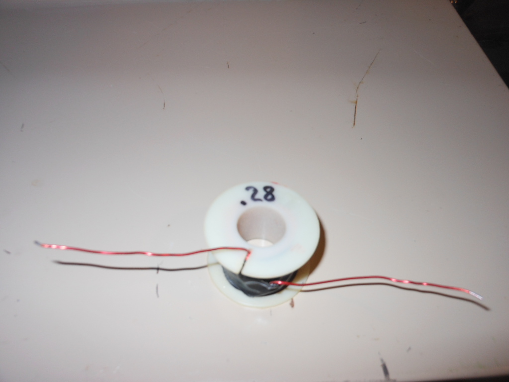

Neat little thing...it's already told me one of my coils I have in my speaker crossover stash is worthless.   Icon_eek

Oddly-enough, that is not true for these specific coils....these were probably wound right at the location
where I bought them from : Highland Heights, Ohio.  This one , I thought, was around .5mH,  but turned out to be .28 mH. ( I say 'thought' because I've removed wire from it in a guessing game). This resulting value would only be good for a crossover point of about 5kHz , . . . too high for my preference.
