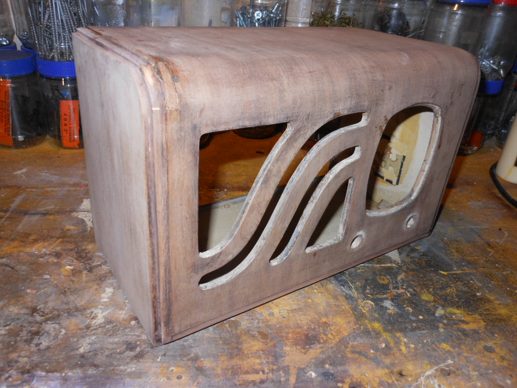

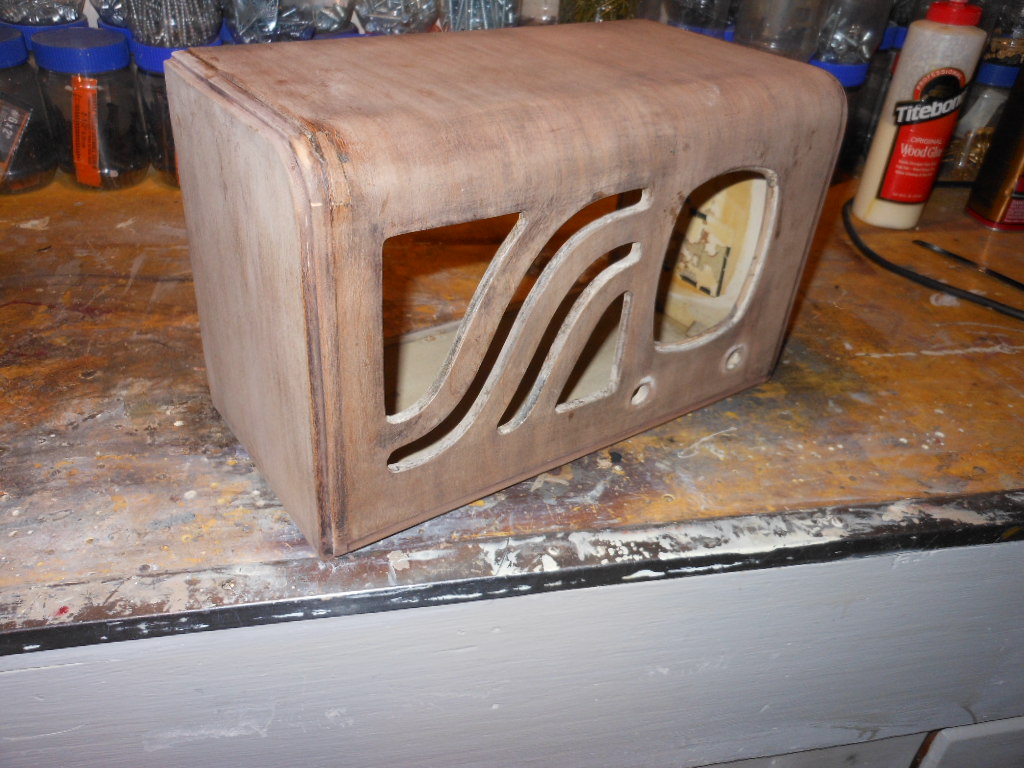

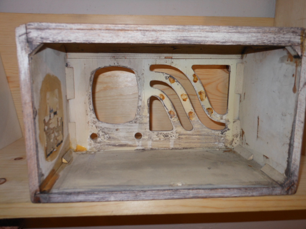

The cabinet has been stripped, and may even turn out ok, ... as long as I haven't already committed a crime by not removing the paint on it with baby oil or something.  Icon_shh   The veneer appears to still have some color to it.  In the pics, you can see where I'm trying to repair a small piece of veneer that chipped off on the upper left corner.
The inside of the cabinet looks like it's painted with a pale yellow paint. I'd like to repaint it also. Maybe someone has some suggestions as to the best paint to use.
