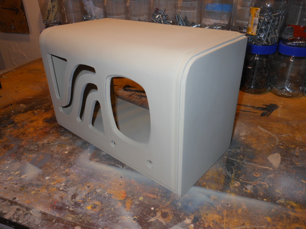

After searching at numerous auto stores for a pale yellow primer in a spray can, I was referred to a specialty auto paint shop not far from me. They had this (shown below).  It's the closest I found to a pale yellow primer. "Off green-yellow is the new beige! ( I had this exact same issue come up with my "beige" replacement windows, which are the same off-green-yellow color!) The cap shows the paint has a green cast with the camera flash,  but in incandescent light, it does look more yellow than that, (See the stripes where the incandescent light shines thru the grill onto the inside of the cabinet).

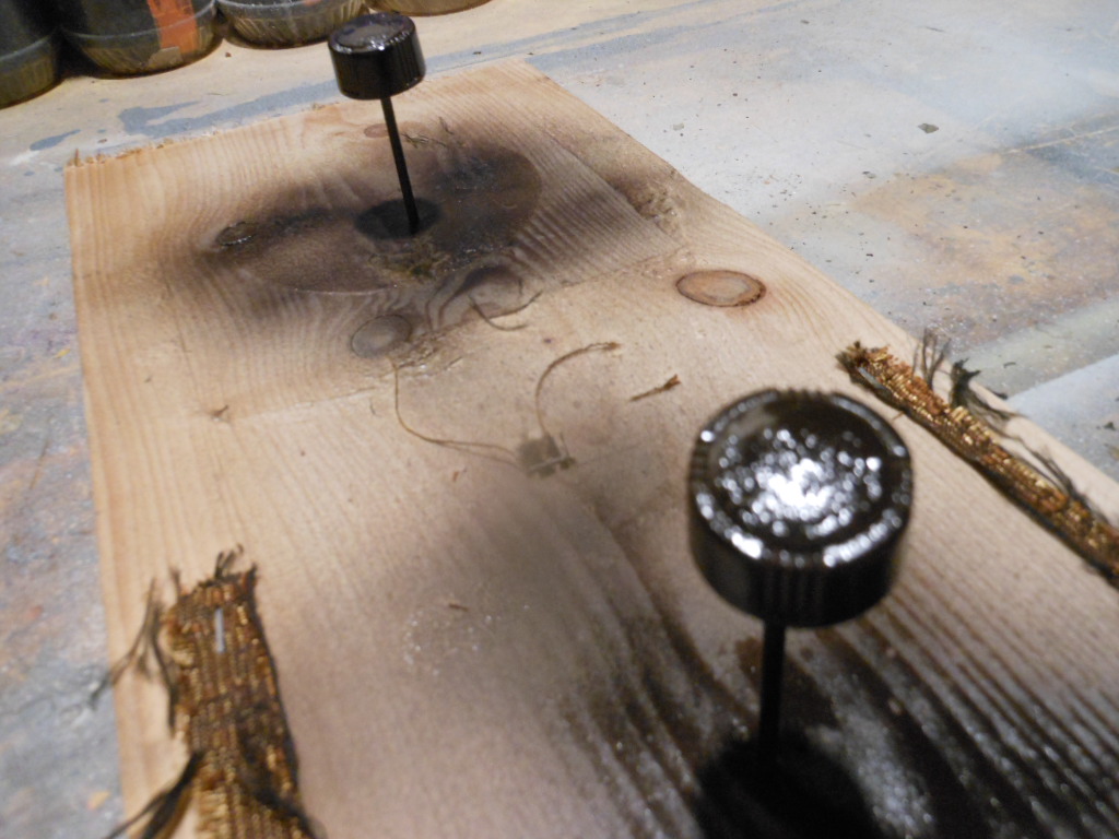

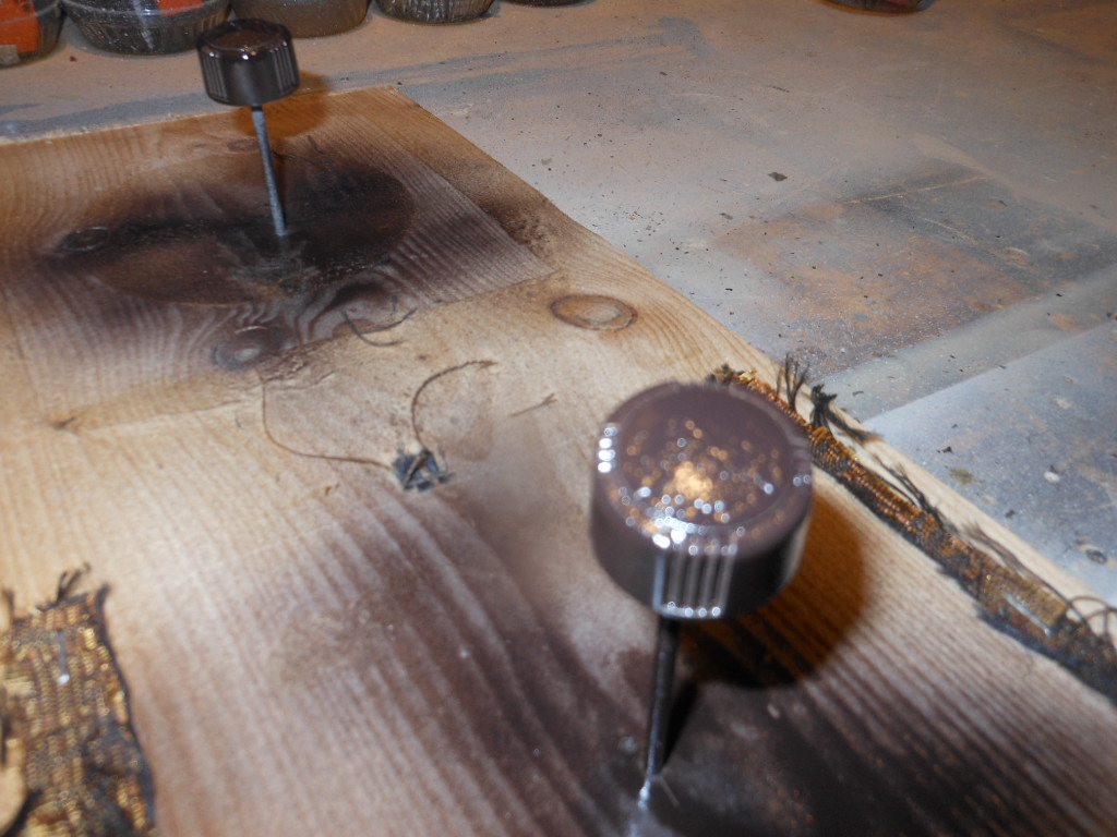

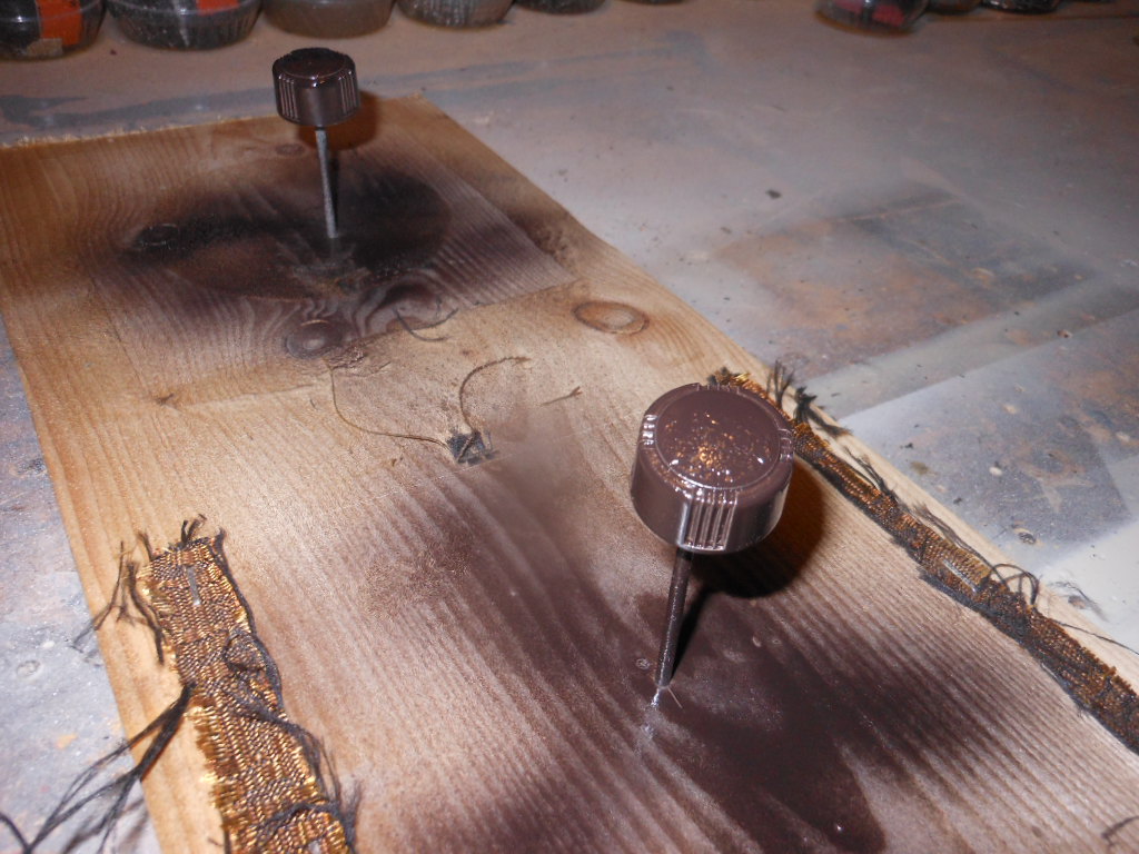

Okay, . . .what the heck is going wrong with this knob paint job? !
The primer went on nice . . .
The 1st coat of brown went on nice . . .  very lightly.
The 2nd coat went on nice. . . . at least it looked nice when I walked away from it to let it dry.
Now look what I have.   Icon_crazy
Possibly some silicone on the knob.

"Possibly some silicone on the knob."
Oddly-enough, I did just buy and use silicone to glue in the grill cloth board, . . . but I didn't think I touched the knobs before spraying them.
 I'm also thinking the basement is too cool to paint . . . I'll strip them again and bring them up stairs to dry next time.
Thanks Steve.
