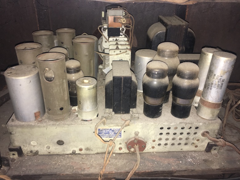

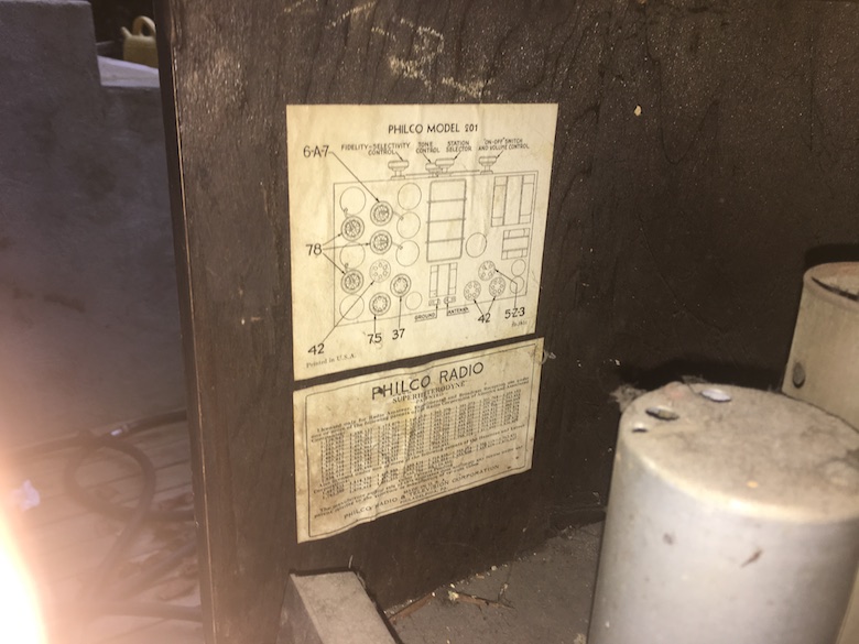

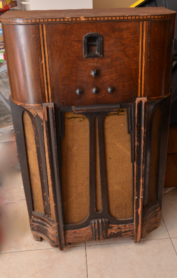

Sorry to steal the post but do I have a 200X cabinet and a 201X chassis?
Still odd that I kind of like it with the grill cloth in place. Icon_smile
Which do I have?
Kirk
It looks like you have a 200X cabinet w/a 201X chassis.
Here are a couple or thing to check:
Is there a counter sunk hole for a toggle switch on the left side (facing from the front)? 201X would.
Does the hole look like it was done by the factory, same brown color as the rest of the inside of the cabinet?
Does the dial have two scales a bc band and a sw ? 201X would.
Could be what you have is a leftover 200X that Philco installed the later chassis at the beginning on the 201X run.
Grille cloth has been replaced as it should the chevron pattern. I'm thinking that it take 3 large pieces to replace w/the chevron. Eck!
He's got the 201X label. That's pretty good evidence that this pairing was original.
In fact Ron came across this exact combination before:
https://philcoradio.com/phorum/showthrea...2#pid42282
There was another one here: https://www.antiqueradios.com/forums/vie...1&t=206295
