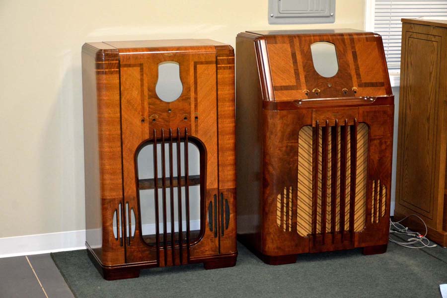

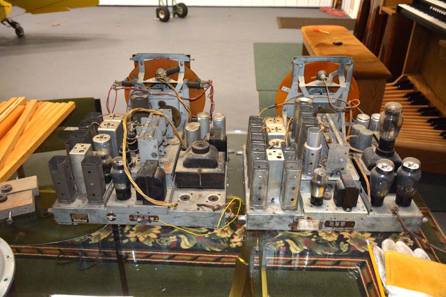

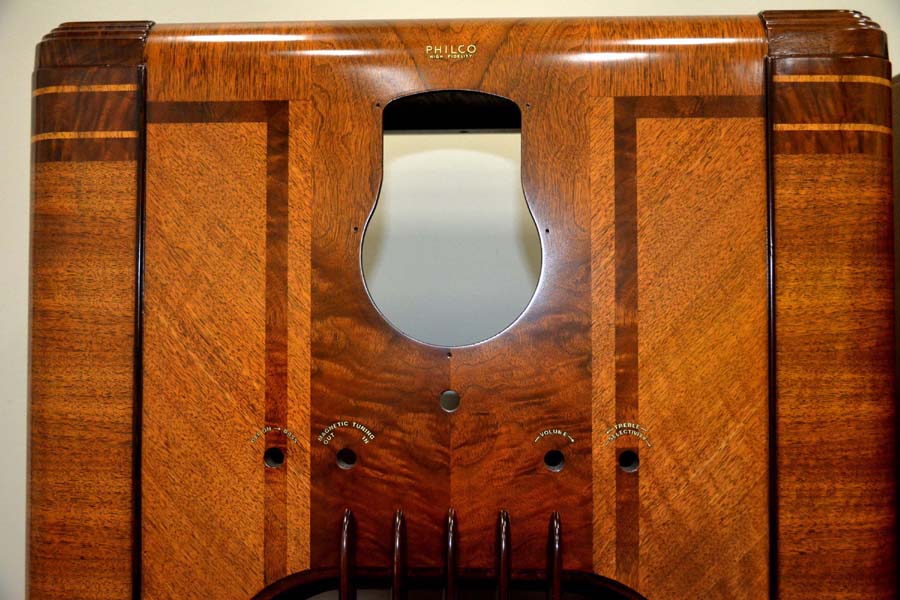

The 38-116 now has a refinished sibling.  I bought the 37-116 cabinet several months ago, then later purchased a chassis.  The 37-116 has now been refinished.  Once I get the tuner rebuilt,  I'll have to put it or its twin, which has its original finish, up for sale someday.
The no squat cabinet certainly added a bit of girth over its older sibling.
The cabinets look nice. Did you refinish them?

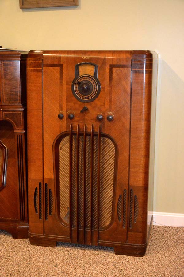

The last pic is original finish which is quite decent. The empty cabinets I refinished using Mohawk products. I'm mixing my own toner as I can't seem to control the rattle cans. I have not rubbed them out, I've never done that. The finish coat of lacquer lays pretty good and looks good without or with very little grain showing through. Once they cure for a month, I'll try the rubbing out process with polishing compound. I may try that on my 41-295 first as that has cured long enough. I just don't want to mess it up!

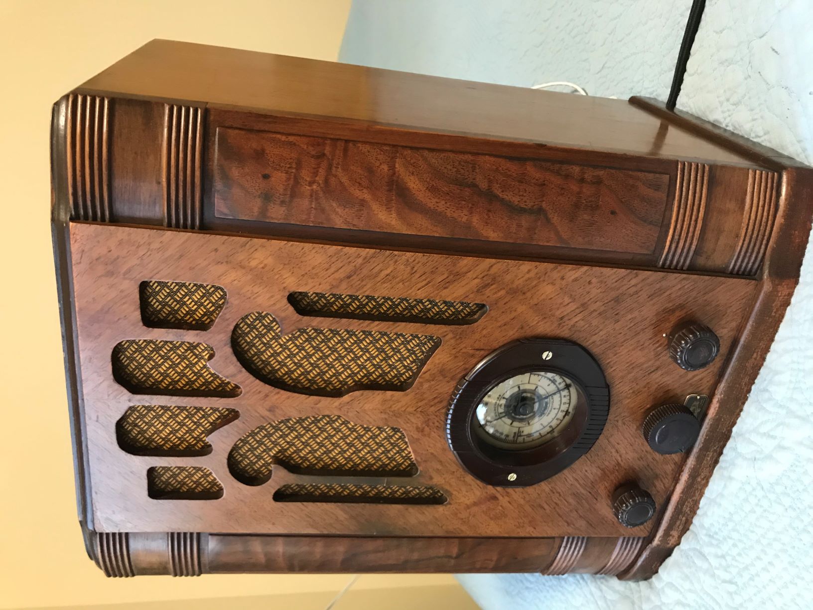

i'm not sure why my picture is sideways. the radio is a Belmont [BRC] 585.
Wow ! Vary pretty Fenbach, nice job.
