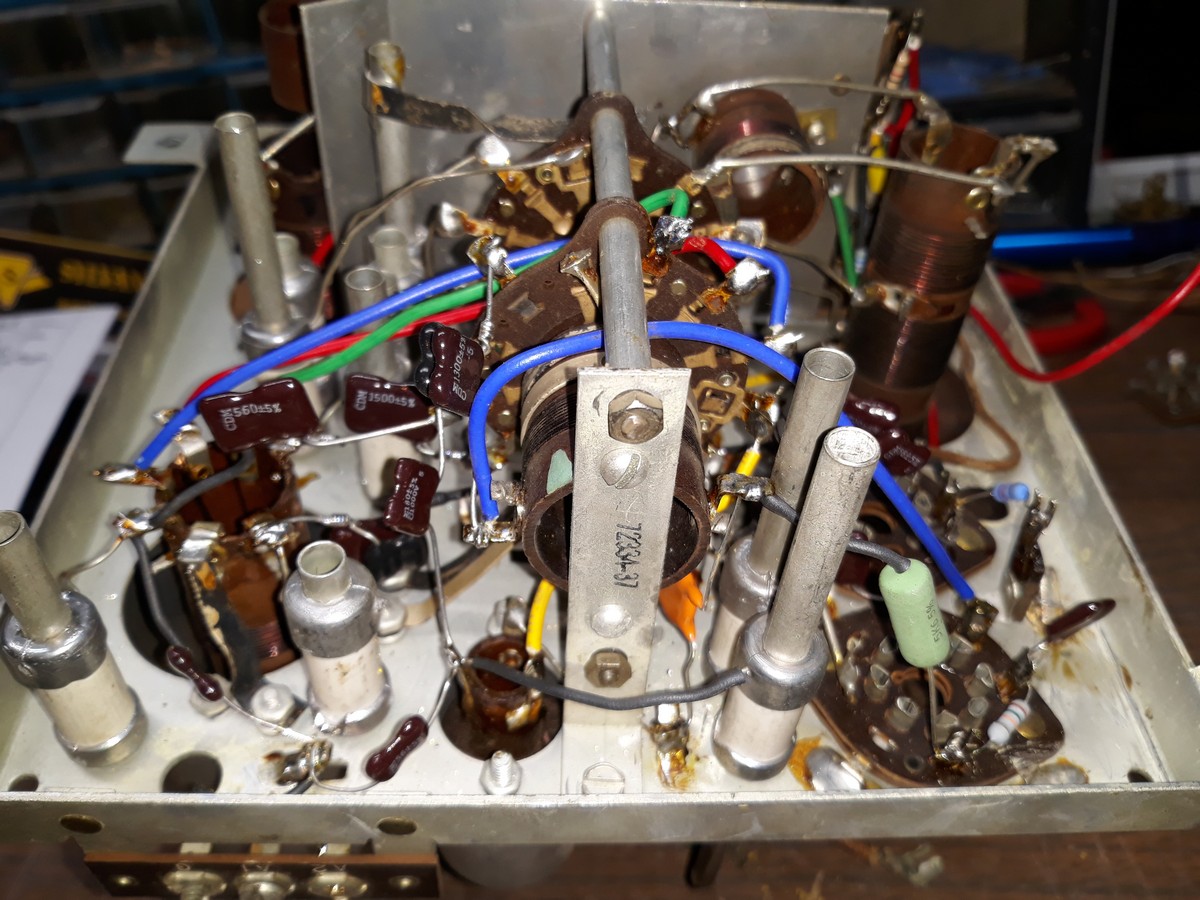

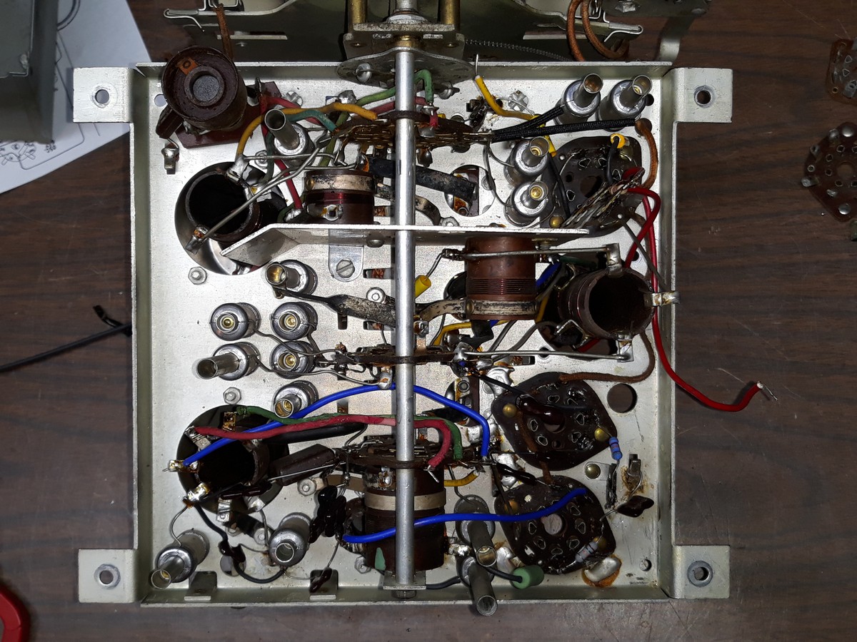

One VERY expensive order of mica capacitors later...I began digging into the Magic Brain in earnest.
I've replaced about half of the micas at this point.
And no, I did not bother to restuff the four .01 uF paper capacitors. The underside of the Magic Brain is so jam-packed...plus when this is finished, it will be totally enclosed and no one will see under here unless they remove the bottom cover.

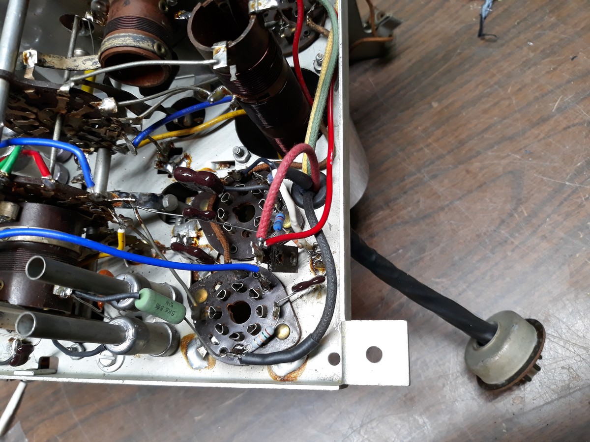

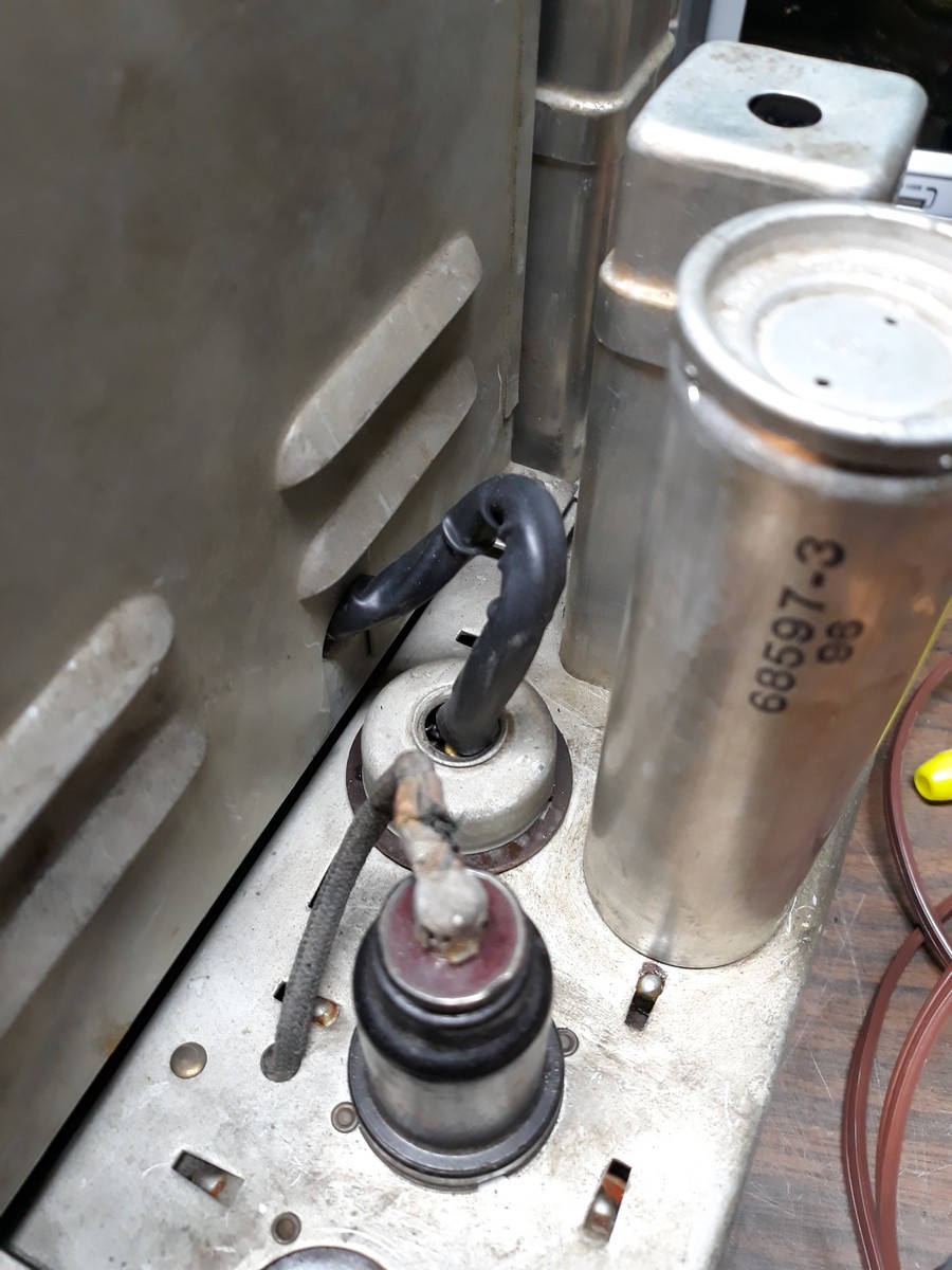

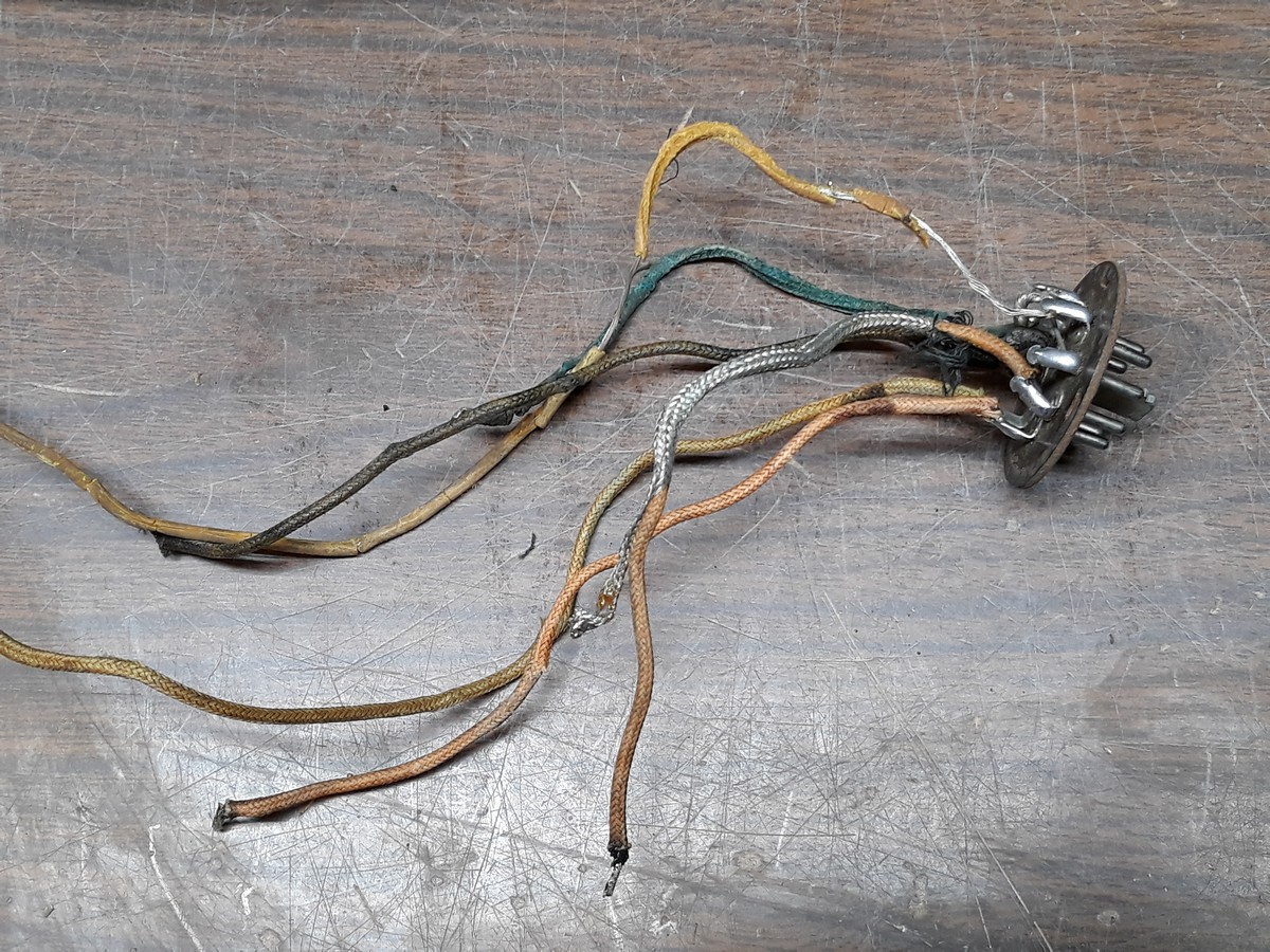

I also removed the interconnect cable which terminates in an octal plug in preparation to replace the individual wires with new ones:
I don't feel very comfortable running the heater supply through the 22 gauge shielded wire that came with my Mouser order. One side of the heater string runs through the center conductor...the other through the shielding.
I do have some 20 gauge shielded wire coming from a different supplier, but it won't be here until Saturday at the earliest. But still...both sides of the heater supply running through a shielded wire. Hmmm...

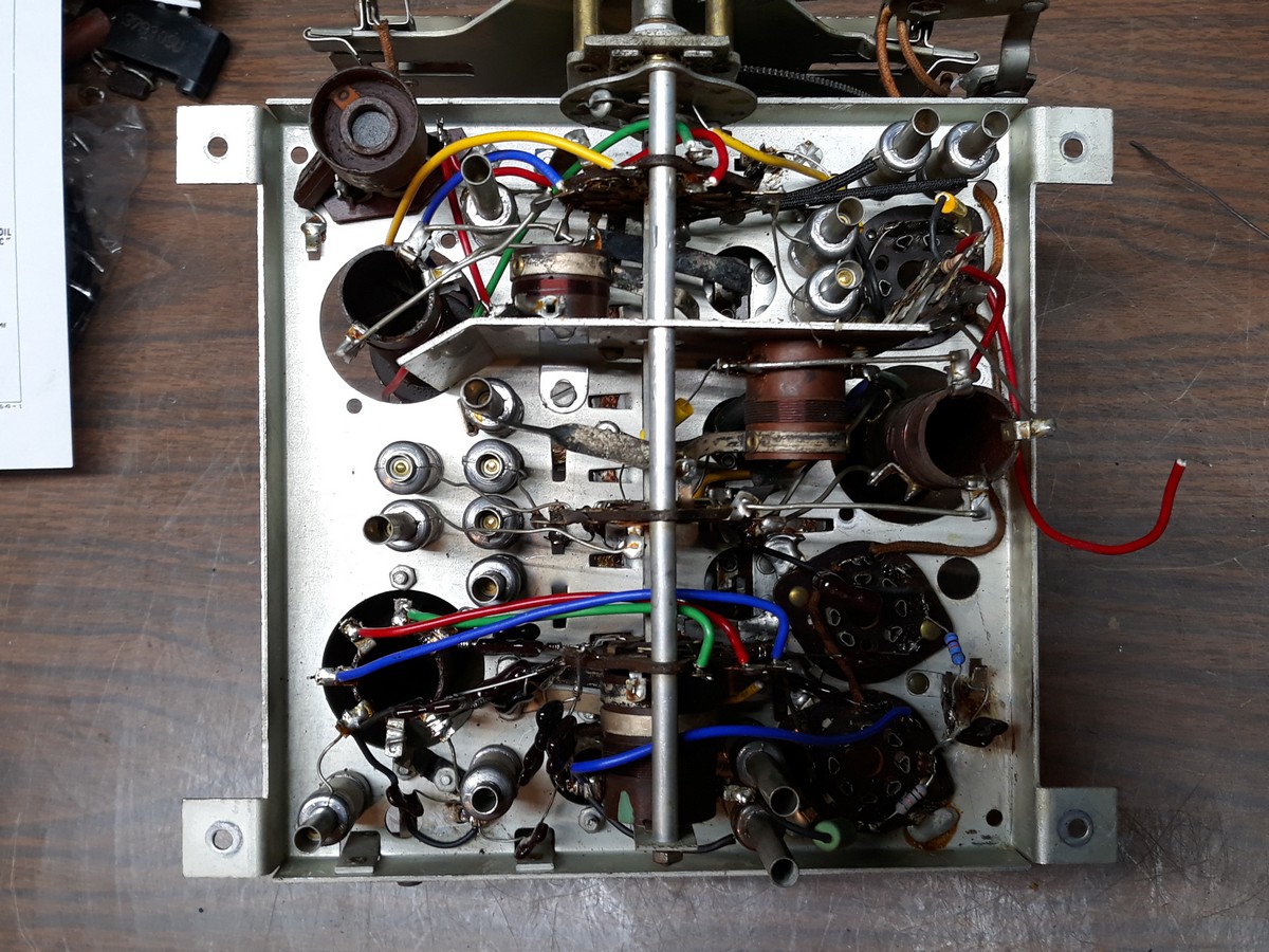

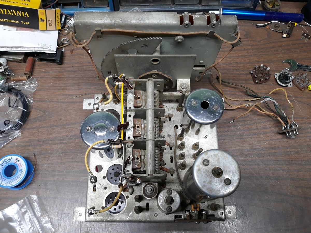

Progress:

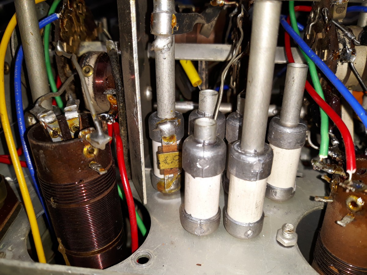

There are a few mica capacitors which are soldered to the trimmer capacitors, such as this:
I decided not to replace these, since those metal rings you see around the trimmers are made of solder, and I didn't want to mess them up.

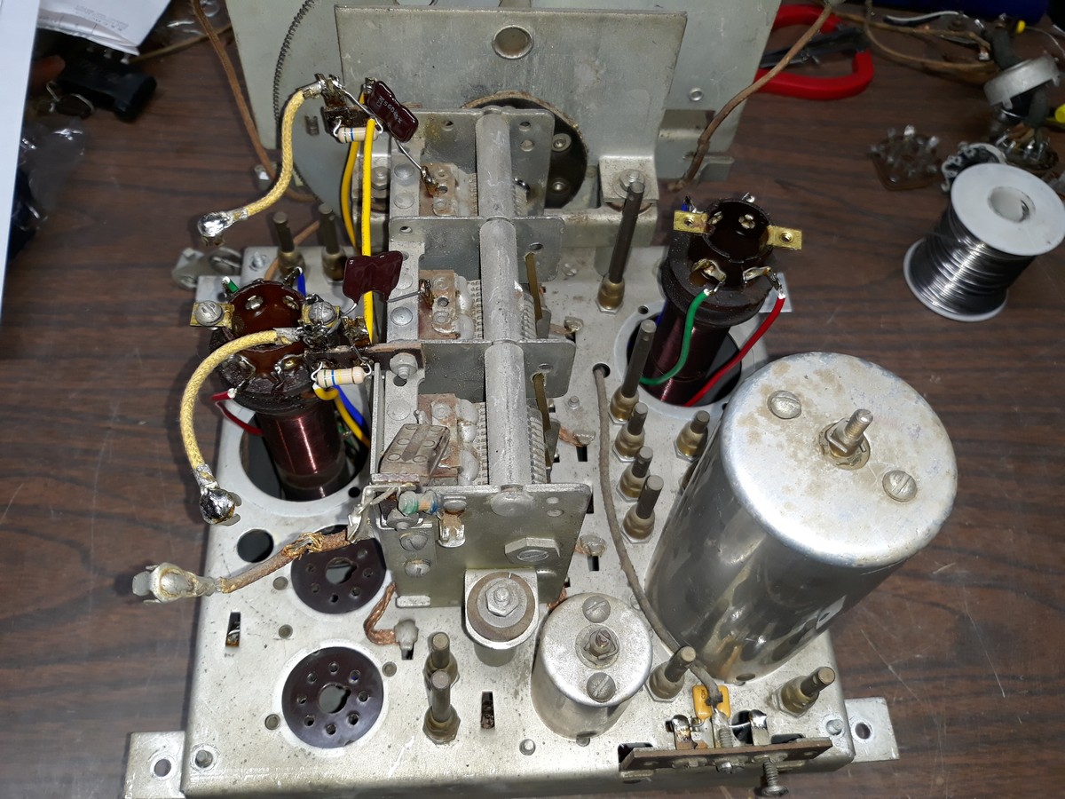

Topside progress:
Still to do: One more mica cap underneath, one more mica cap and one more resistor on the top, plus one more grid cap lead to replace on top. Also polish and reinstall the shields for the open coils you see above. And them make and install a replacement wiring harness and the Magic Brain should then be complete.
If all goes well, I hope to have the Magic Brain back in the main chassis sometime tomorrow - and also hope to apply power to it for the first time tomorrow as well.
Progress continues, slowly but surely.
I'm basically finished with the Magic Brain save for rebuilding the interconnect cable and reattaching the dial scales. I really don't know why I bothered polishing the two coil covers which I had to remove to replace rubber-covered wires, since these coil covers will not be seen with the Magic Brain cover back in place when the unit is reattached to the main chassis. Just habit, I guess.

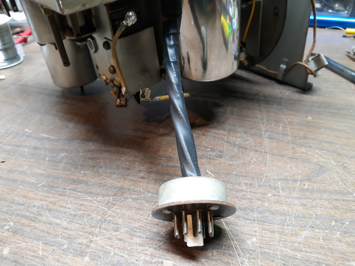

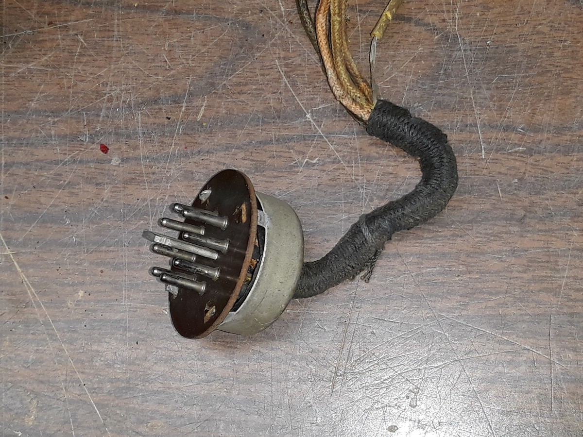

Here, I have removed the covering from the interconnect cable. This will help me to determine how long each individual wire was, so I can cut new ones to the proper length.
New interconnect cable.

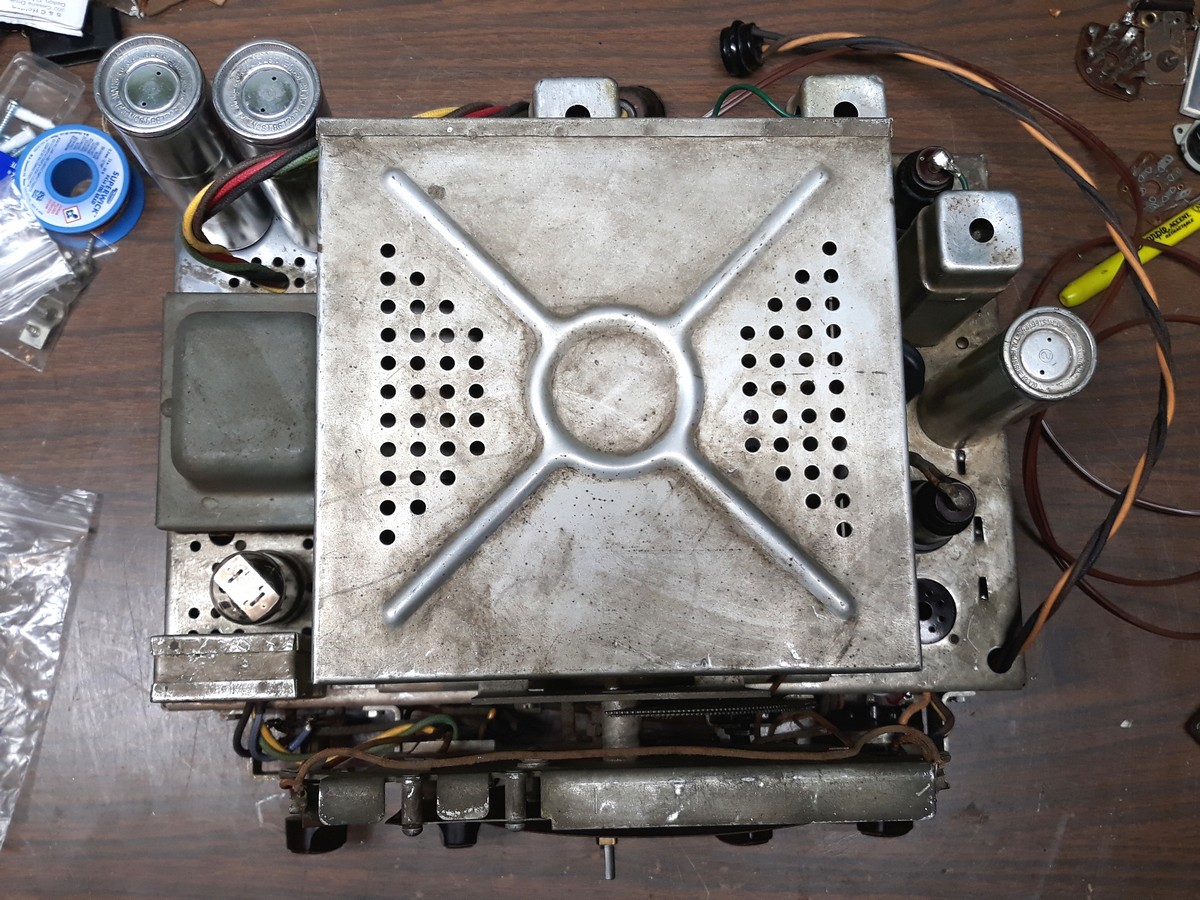

The Magic Brain is now ready for reinstallation into the main chassis.
Back together again.

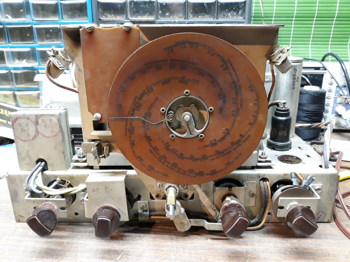

I have a problem: I'm having a very hard time getting the mechanical linkages of the bandswitch assembly to work properly. Because of this, I have yet to try the radio out. Hopefully tomorrow I will get this issue resolved.
Somehow I managed to make the interconnect cable slightly longer than the original.
I guess that's better than having it too short.
