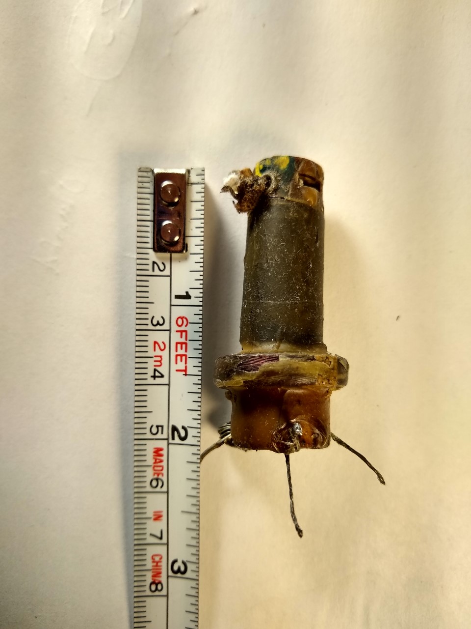

    Here is a photo.  There was a paper band around the primary, which I removed so that I could get a better look at it.  I re-soldered the connections just in case I would get lucky and fix the problem, but no.
Well, I ordered the RF coil replacement from AES.  since I only needed the primary side, I nestled it in between the BC and SW coils.  reception is greatly improved.  Not the most elegant solution, but good enough for now.

By the time I finished with the long post, I discovered the photo of your defective coil. Which section is bad - the helix wound section or the longer flat section?
I will look for a replacement in my parts chassis.
Gerald
Hi,
I looked at my parts radio and the coil you show in the photo is not like any in the radios I have.
Sorry,
Gerald
