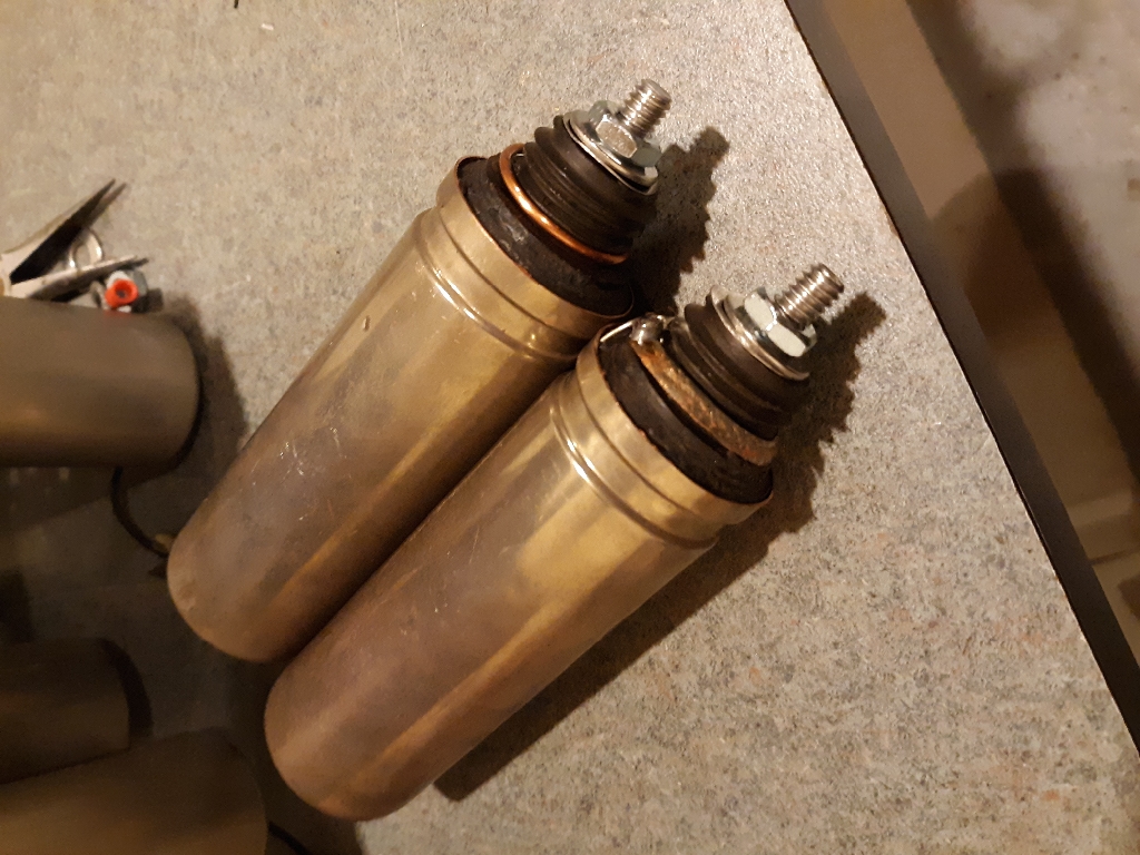

The restuffed caps.

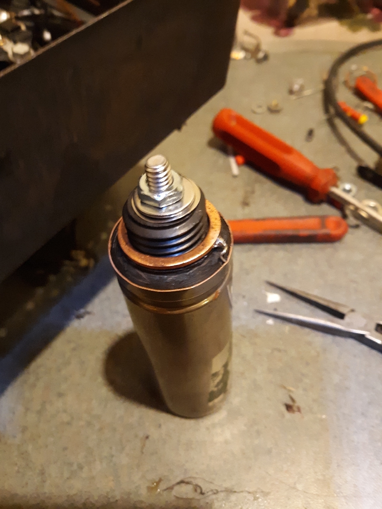

I realized the rings that I fashioned out of the remaining parts of the caps' cylinders did not center well on the contact ring on the chassis. so I removed them and ordered M22 copper rings with 28mm outer diameter which fit exactly right. After this the contact was good and the rings sit nicely. I cut a little groove for the negative wire soldered between the ring and the base to not skew the ring so it sits flat.
So Mike, is the only purpose of those copper rings to connect the negative of the capacitor to the chassis?
John,
Not to the chassis. The caps' negatives are not directly connected to the chassis; they are connected to the Rectifier negative and then via the bias resistor to the chassis, so the caps rest on the contact rings on top of cardboard washers which insulate the caps from the chassis.
The way I cut the cans makes them to not touch the contact ring anymore. This is why I have to somehow provide the new connection. The copper ring soldered to the cap's negative wire does exactly that, pressing against the contact ring.
Great job, Mike. Icon_thumbup Where did you get those copper washers? I think I want to do that the next time I attempt to rebuild a Mershon or Sprague electrolytic.
They are sold on both eBay and Amazon.

Those are M22 with 28mm outer. The 22mm hole is exact fitm
However I would increase the outer by another 2mm making it M22x30. But so far most ones are 22x28. Or 22x39 which is way too much. Then again 22x28 work just fine.
PS. Oh...and I had to remove both rippled and flat washers from under the nut that goes to hold the positive bolt: they got too close to the nut holding the cap to the chassis.

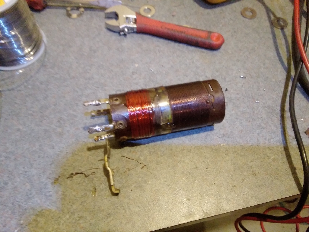

I extracted the second RF xfmr from the donor chassis to install and saw the dreaded green...the meter confirmed an open winding.
I rewound it and am waiting for the glue to dry over and form the film before i solder the ends and install the coil in the shield.
First I put the rewound coil back.

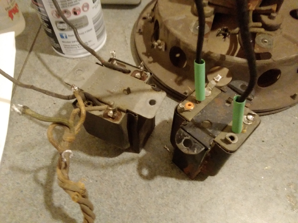

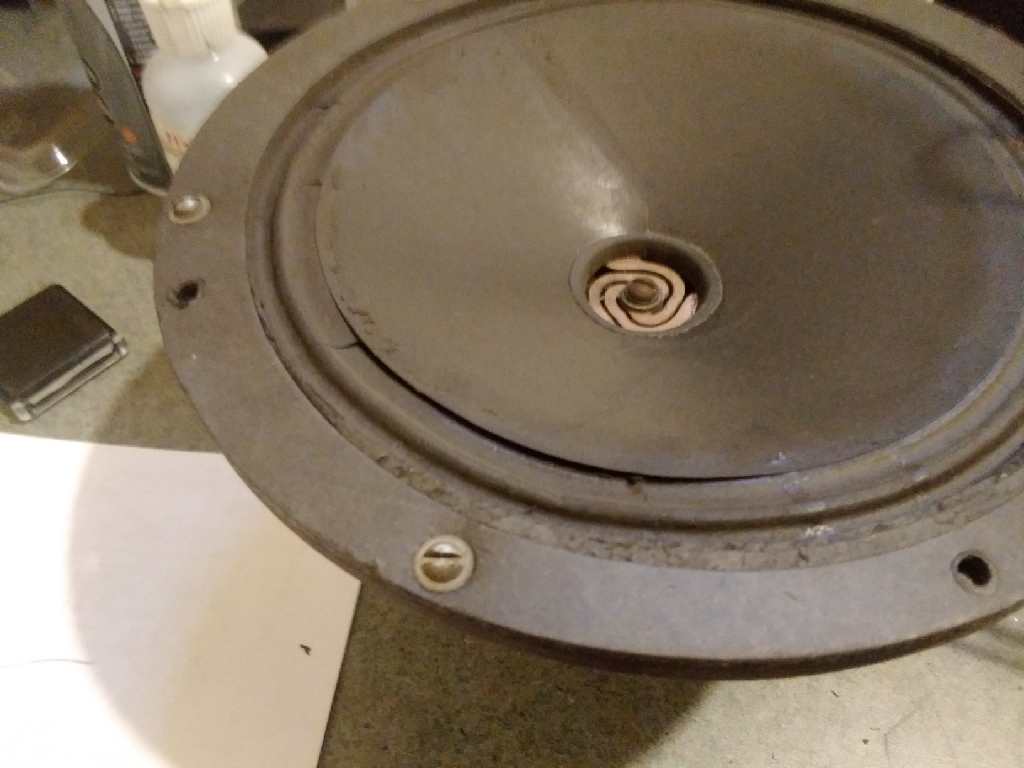

The speaker, as I stated before, has bad transformer.
I have two working speakers, one 20 and one 90 SE so I used the latter. It has some cone repar or separation but I figured it would work.
So, I powered it up, the voltage climbed nicely, and in 20 seconds I was listening to the Jersey Shore radio.
Now the speaker repair and alugnment.
Today I took the baffle board out, and took the speaker off.

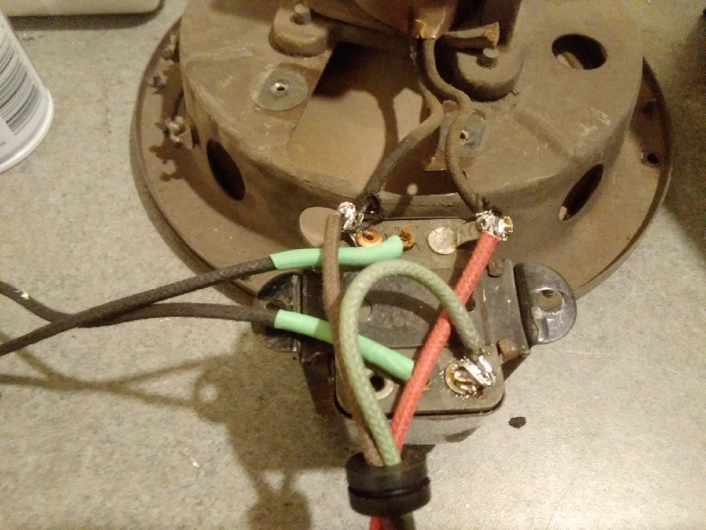

As I said before, the transformer is bad. I happened to have a 90 xfmr for a single 47 tube output, but its lug base board is missing one lug and one is damaged, so I intend to try to swap it with the existing transforner which is bad but has good lug board.
Then I will put the xfmr to the speaker (boy it is involved) and change the wiring.
Then put back the speaker, grillcloth and all if it back in the radio.

I realized the speaker is not from 70.
The dead transformer is 2766 which is a pushpull, probably from 90. It is not a 20 speaker as the pole is pressed, not the one with a nut.
I just happened to have 2673 transformer, the one from 47 output 70 I bought many years ago from Gary Scneider for very little m9ney.
So I grafted it in.
It is little fun doing this, but...

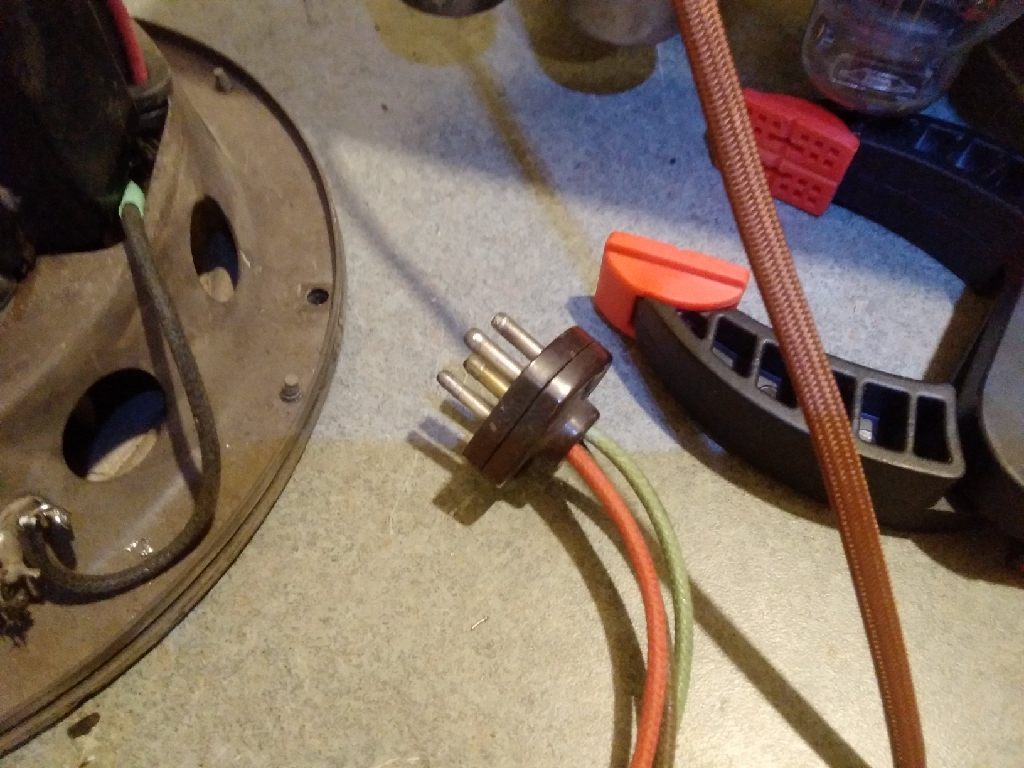

I opened the plug by using cutters and mushing the rivets and pulling them
Then when assembled, i put glue in the holes of the face part and put the rivets back. Hopefully the will catch.

PS. The speaker plug glued nicely and Trolmaster with F5 Deoxit worked the magic on the volume control.
