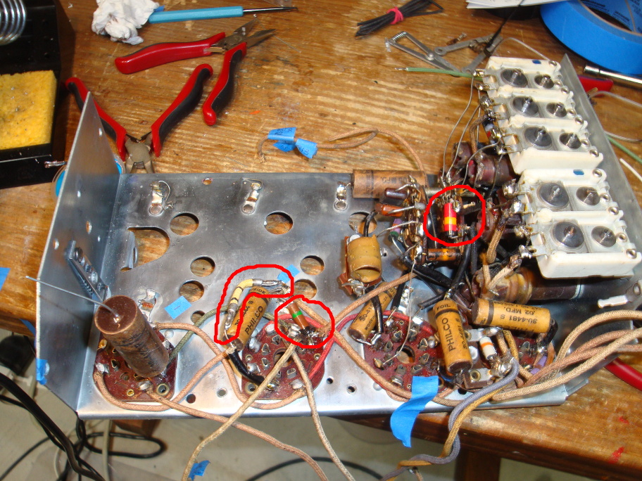

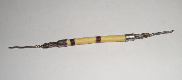

After a diversion restoring a 6-D-539 chassis I'm back to the 37-116.
Since I'm re-stuffing the capacitors it seemed like a sin not to "re-sutff" the bad, flexible 400 ohm, 1/2W resistor in the RF chassis. The original's resistance read quite high and varied as I "wiggled" it.
The insulation was gotten from some Radio Daze some cloth covered. It has PVC(?) insulation inside and the insulated wire pulls out easily. The resistor inside is 4x 100 ohm, 1%, 1/4W resistors. I drilled small holes in the end caps to pass the new resistor leads out to the original, external leads. I think the end caps are aluminum and didn't trust soldering to them. I added a couple bands with markers and that was that. However I wouldn't want to flex it much. The 1/4W resistor wires are pretty fragile.
Considering nobody will ever see this buried in the RF chassis I'm starting to think I'm nuts...
It looks like the original hair thin, nichrome(?) wire was passed through the end of the caps and crimped with the external leads.
Can't think of anything witty.

Hi Greg, folllwing your restoration of your 37-116 as I have one myself. I’ve always wondered if there is something special about those flex resistors that Philco used? Is there any reason why you can’t replace them with a regular resistor?

There is no reason.
It seems it was popular for low values to be wire-wound.

I can only think of two reason. Fitment in that maybe in too close quarters for a 1/2 bed resistor. The other is there maybe a slight inductive quality of the wire wound resistor.
(This post was last modified: 05-15-2020, 09:38 AM by Radioroslyn.)
Posts: 16,476
Threads: 573
Terry,
For a wirewound resistors the parasitic inductance is considered to be...well...parasitic, right?
So much so todays WWR are done in bifilar way so to eliminate it.
So other than stability of a wirewound, I don't know what other reasons they would have.
But as the stability goes, the rest of the resistors were carbon, so to have some resistors stable and some not.....
The cathode resistor is DC bias / Negafive feedback, so stability might be a consuderation but then there are other circuits with higher value dividers that could benefit from stability, but used carbon resistors nevertheless.
Maybe it is simply because it was easier to make the low value ones from a wire and higher from carbon? Just technological, no circuit theory behind it?

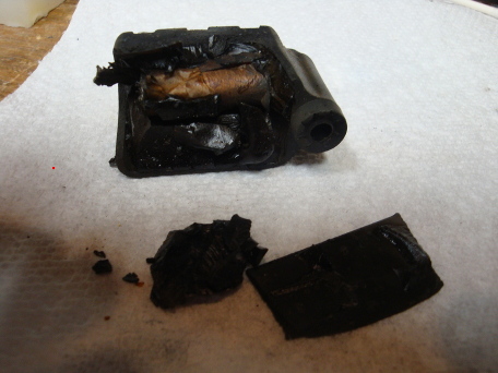

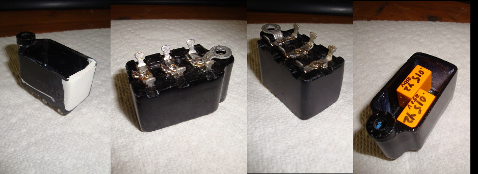

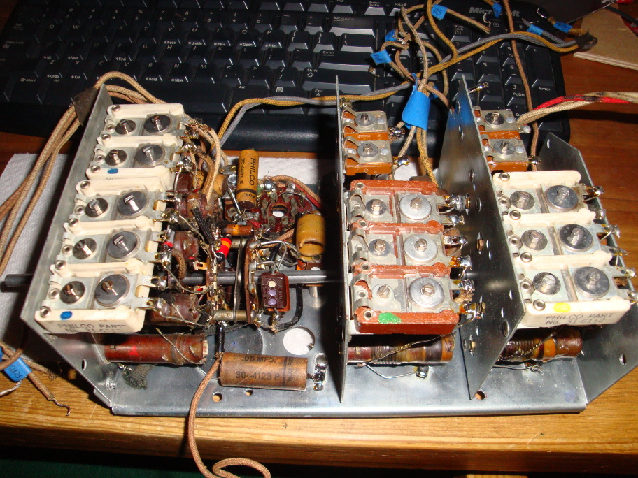

Finally some more progress...
The coils in the RF chassis, with the exception of the one I fixed, checked out OK. All of the capacitors in it have been re-stuffed and a few bad resistors replaced new ones made to match the originals.
The RF chassis is back together, except the tuning capacitor. I need to get a grommet for the back end of it first.
I plan to finish the main chassis then for initial testing I'll clip-lead in the RF chassis. I don't want to have to remove it if anythings wrong. I know, how could that possibly be  .
I'm working on the Bakelite block capacitors. The first one went fine. The next was the line filter block. It wasn't so fine. It had a catastrophic failure at some point. One side and the back were blown out. I found the side, but not the back. I glued the side in place, created a new back and corner with epoxy putty, spray lacquered it black and re-stuffed it.
Before:
During/After...
Onward and upward...

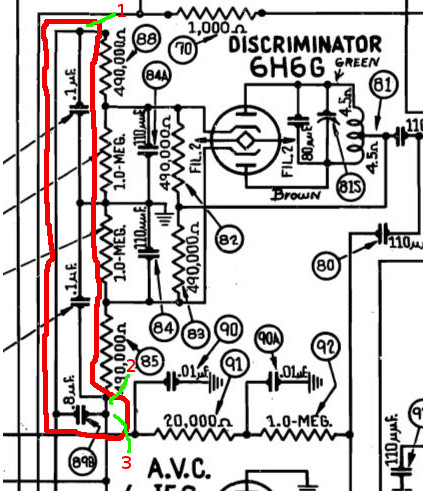

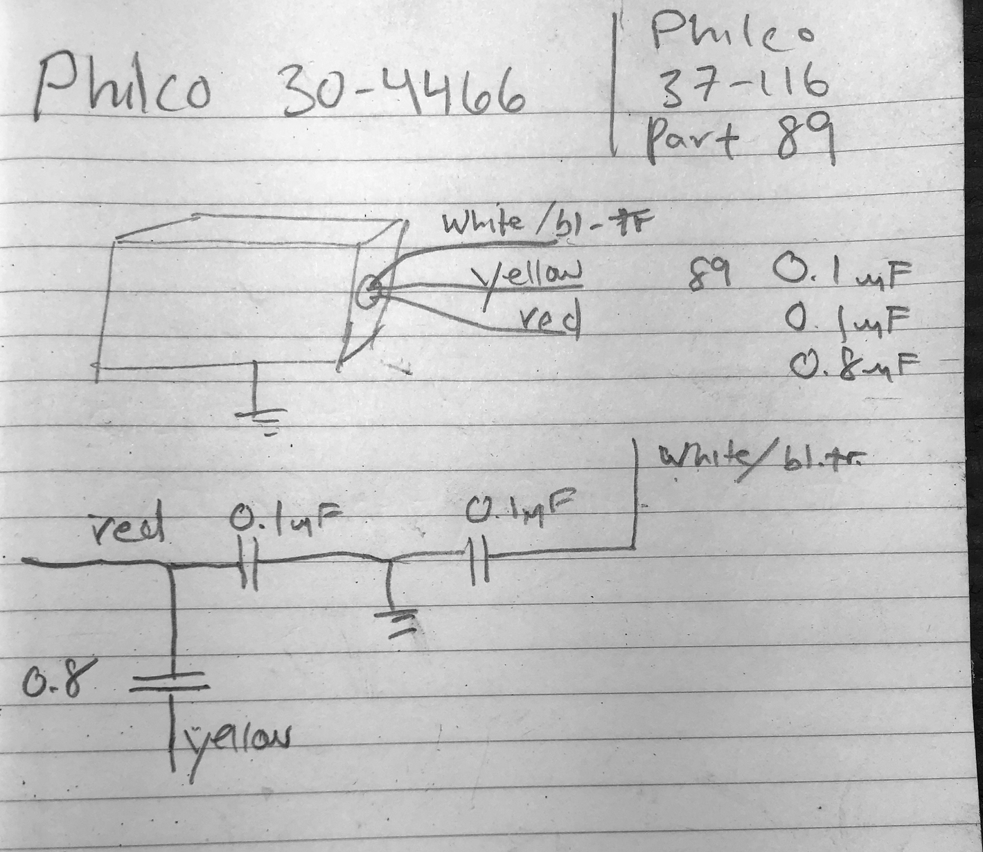

Question...
What are the three leads from the three section capacitor, part #89 connected to inside the can? It's a 30-4466 (no catalog entry) with 0.1, 0.1 and 0.8 uF capacitors. It's in rectangular tin can above the chassis with two tabs holding it in place.
Maybe I need to be "more smarter", but I don't understand how it can only have three leads when two of them connect to the same point, part 85. That would suggest the two 0.1uFs are grounded by internal connection to the can and the can is connect to the chassis by the two tabs that lock it in place. That seems like a lame way to ground something.
My guess is, and my dog agrees with me, that the leads would be:
1 - Common with one side of "upper" 0.1 and one side of the 0.8 connected to it. This connects to #88.
2 - Other side of 0.8 connected to #85.
3 - Lower 0.1 connected to #85.
Can - Both 0.1's connected to it and it connected to the chassis via the two tabs.
I suppose I'll find out when I take it apart.
Greg O.
Whitehall, PA
Posts: 1,887
Threads: 214
Joined: May 2015
City: Seattle
State, Province, Country: WA
Hi Greg,
I recently worked on a 37-116 (Standard) and puzzled over that same can too.
Here is what I figured out based on peeling apart the original sections and comparing against the schematic.
I think that matches your dog's intuition.

Posts: 1,199
Threads: 49
Joined: Oct 2017
City: Allendale, MI

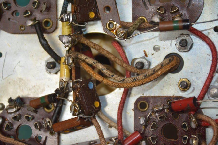

The schematic shows a detail of that cap assembly. It is curious as 2 leads are connected to the same terminal. I would suspect that that is a part that is left over from a previous design. But if you follow the schematic and the detail of the capacitor, you will come out good. I recently completed 2 37-116's and looked closely at the connections to the leads from that can. I have pics of the connections. It does work out per the schematic, and does work in the real world.
The three leads per the schematic are white with a black tracer, brown and red. There is no yellow. One of the .1's is connected to the Wht/Blk, the other end of that .1 is connected to ground. The other .1 is connected to Brown with the other end of the .1 connected to ground. One end of the .8 is connected to Brown, the other end is connected to Red. that is different than Nathan's description, so investigate carefully.
I think the red and the white/blk are connected together, with the white /blk and red connected to one of the 490K resistors and the Brown connected to the other 490K resistor.
Is that clear as mud? Look carefully at the Rider schematic as there is a detail of the part 89, 89A and 89B cap.
Here is a pic of the leads from the cap can:

Very possible my interpretation of the wire colors isn’t a great reference. That was what they looked like on my set - but could have faded.
