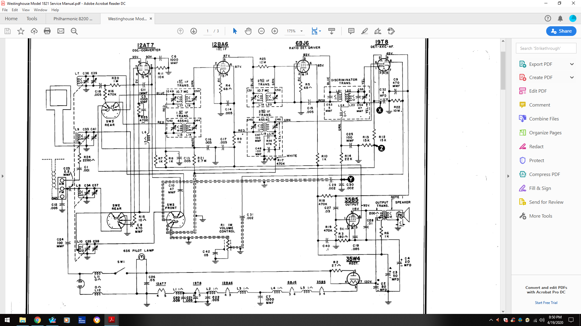

OK so I think I figured out whats wrong with this Radio, the output transformer primary is open from what I can see with my multimeter, the output transformer's primary is supposed to measure 200 Ohms but its measuring open.
I'm not sure how the output transformer's primary would of went open but it did somehow.
Which I'm not sure if I would be able to find an output transformer that has a 200 Ohm primary and a 0.8 Ohm Secondary, that has a centertapped primary.

Mike, John B. posted a link to the schematic in post #8 on the first page.
0.8 ohm secondary is not important, the turns ratio is to a degree.
You need to match 2.5kOhm to3 Ohm, that is your turn ratio is 29 (30 is ok or close).

Here's the schematic for this radio, as you can see on the schematic, this Radio's Output Transformer's Primary is indeed center-tapped, because the output transformer's primary measurements are taken between the two outer leads and the inner lead doesn't have measurements to it, meaning its center-tapped.
The speaker on this radio is a permanent magnet type speaker with a 3 Ohm Voice Coil that has one side grounded to the chassis through the housing of the speaker, the ouput transformer has a 200 Ohm center-tapped primary and a 0.6 Ohm secondary that has one side grounded to the chassis through the transformer's housing, that's what the schematic says anyways.
