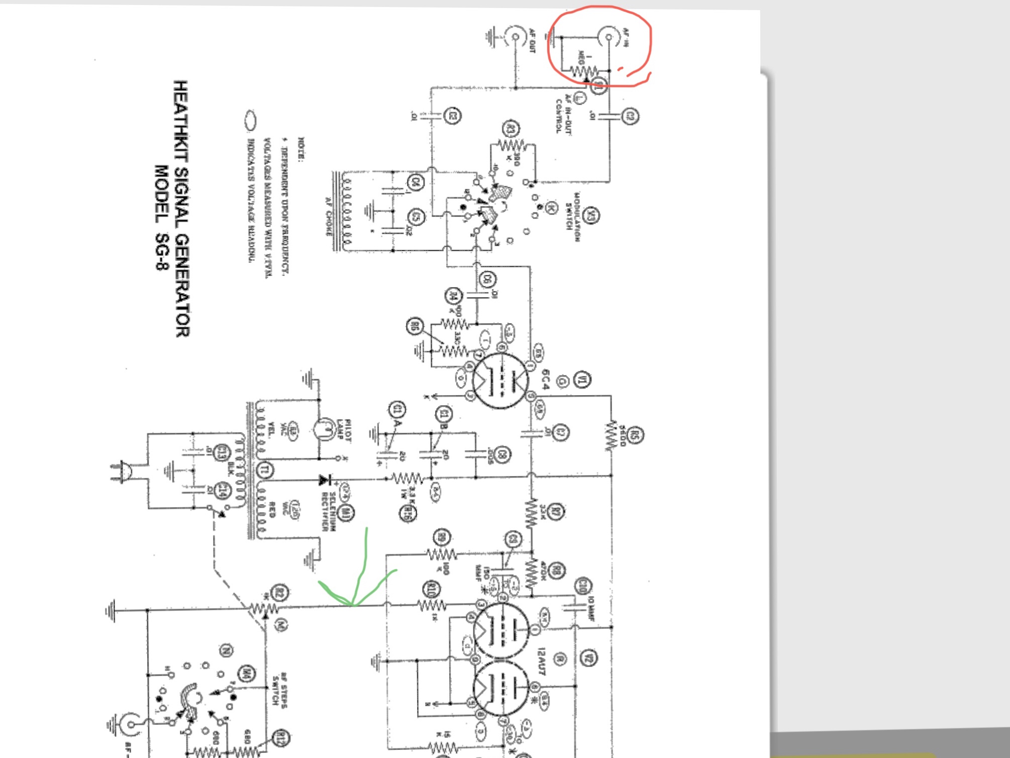

Hi Captain, one problem with connecting a frequency counter to the RF output is that the counter needs a certain signal strength level to operate properly. So when you turn down the output with the 3 position step control or the RF output control, the signal level can drop below the strength needed for the counter. That’s why I altered my SG-8 as in post #14. I repurposed the AF input jack, as I have no need for an audio input to my generator, and wired it through a DC blocking cap to the input to the attenuator, thus insuring full strength to my counter regardless of what the attenuators are set to. Something you might want to consider. Your generator looks pristine, good catch!

Quote:Hi Captain, one problem with connecting a frequency counter to the RF output is that the counter needs a certain signal strength level to operate properly. So when you turn down the output with the 3 position step control or the RF output control, the signal level can drop below the strength needed for the counter. That’s why I altered my SG-8 as in post #14. I repurposed the AF input jack, as I have no need for an audio input to my generator, and wired it through a DC blocking cap to the input to the attenuator, thus insuring full strength to my counter regardless of what the attenuators are set to. Something you might want to consider. Your generator looks pristine, good catch!
Maybe you could draw out a diagram and a parts list for me so I know what to wire where and what value of capacitor to use to do the conversion. I already have the test leads on order and the BNC jacks on order I just need to see what goes where so I can make the same modification to mine.

Hi Captain, you can do as you said and just connect the RF OUTPUT to the frequency counter and then adjust the generator to your desired frequency, the disconnect it. My experience with my SG-8 is that it’s not very stable, necessitating constant readjustment. My alteration allows constant monitoring of the generator frequency without constantly connecting and disconnecting the counter to the RF output. Up to you. If you want to do the change, disconnect the AF INPUT jack from everything circled in red, add a .001mfd cap to the jack and the other end to the circuit with the green arrow! Now, no matter what setting you use for the attenuators, the counter always gets full signal level. Using BNC jacks makes it easy to connect a modern lead with BNC ends to the input of a modern frequency counter. This is a fairly quick and inexpensive change to your SG-8!

[Image: https://philcoradio.com/phorum/attachment.php?aid=22108] Hi Captain, you can do as you said and just connect the RF OUTPUT to the frequency counter and then adjust the generator to your desired frequency, the disconnect it. My experience with my SG-8 is that it’s not very stable, necessitating constant readjustment. My alteration allows constant monitoring of the generator frequency without constantly connecting and disconnecting the counter to the RF output. Up to you. If you want to do the change, disconnect the AF INPUT jack from everything circled in red, add a .001mfd cap to the jack and the other end to the circuit with the green arrow! Now, no matter what setting you use for the attenuators, the counter always gets full signal level. Using BNC jacks makes it easy to connect a modern lead with BNC ends to the input of a modern frequency counter. This is a fairly quick and inexpensive change to your SG-8!
Hi Ron, I have a .001 MFD 2,000 VDC Ceramic Disc Capacitor, would that work for the DC Blocking Capacitor for the above modification?
Also is the spot pictured below the spot I would attach the old AF Input Jack and capacitor modification at?

Yes that Cap you have will do fine. It’s a bit hard for me to see on your pic if that’s the green point I mentioned as a connection point. It will be the junction of R10 and the ungrounded end of the RF Output control.

OK I got the modification done, I have a picture posted below of the modification.
Also in case you are wondering, the .001 MFD ceramic disc capacitor isn't touching the tuning capacitor its floating in the air above it.
