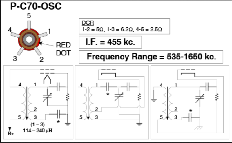

But your comment got me thinking.  I posted a link to this oscillator coil earlier in my comments but here is the schematic for it.
I have tried it in various configurations in place of either or coil 28 primary, and 26.  But I have never ran them both through the coil simultaneously.  When I've got time again I'm going to try that.  You can't get the two coils any closer together than that.

Gentlemen, I have an oscillator.  It is very dirty reception but the barn burner at 1310 Kc is coming in with a great deal of static but very discernible.  The only combination that I can find to work is using the primary winding, terminals 4-5 of the P-C70 oscillator coil.  Wafer switch positions B1 to coil #4, B4 to coil #5.  Won't work the other way around.  I have attached trim cap, #29 to switch position B4, and it will let me peek and the dial position is very close.  Works on switch position B1 too, slightly different trim.  It's not perfect but I am pleased in as much as this is the first actual AM radio reception I have had out of this radio since I took it out of the box.

Excellent, Tom. It was narrowed down to the coil but I kept looking for a wierd solution. I gave you everything I have come up against but the coil did it. I would say that if you have problems with other tank circuits the coil would be very suspect.
