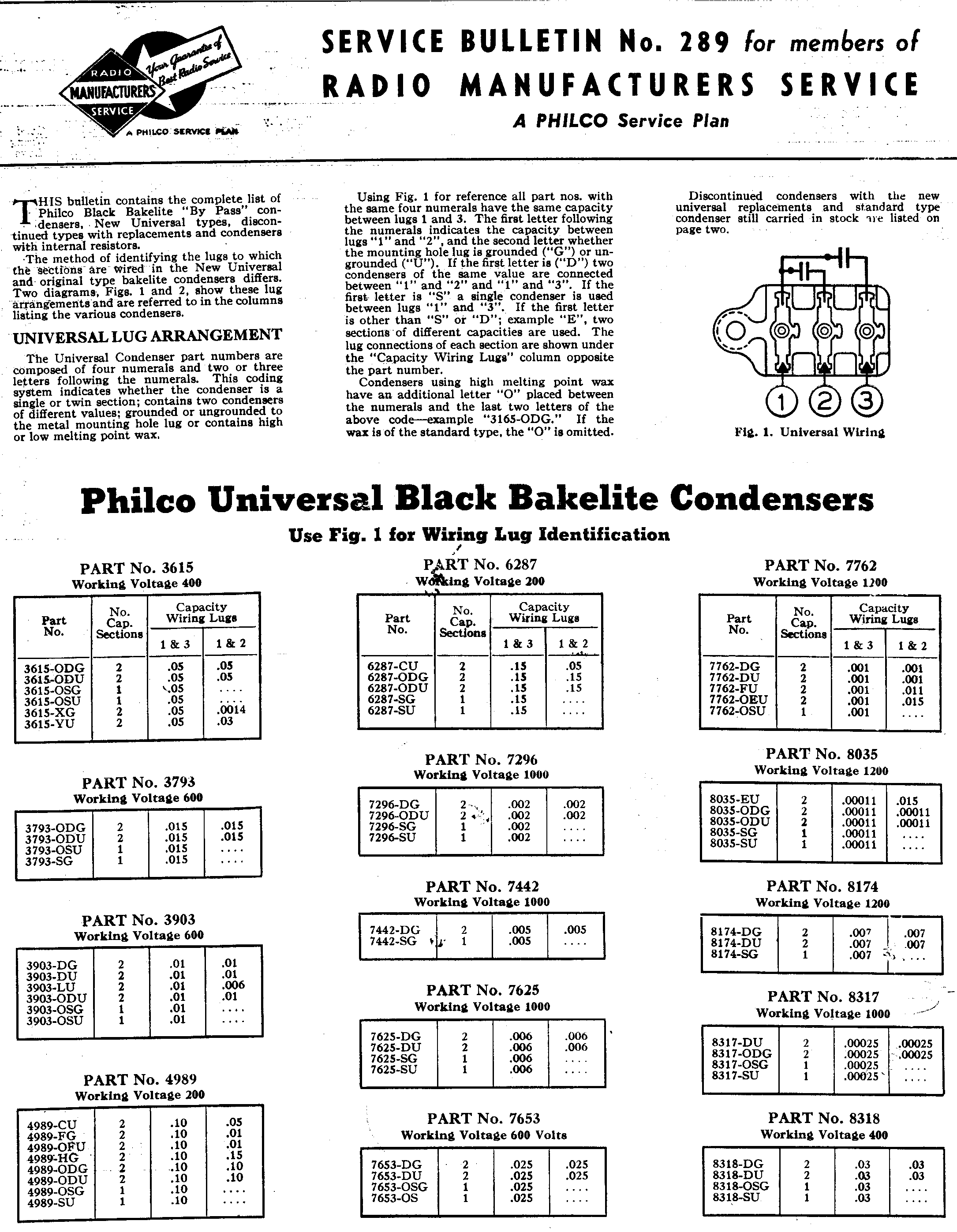

Here's an update I removed Replacement part number 66 (Condenser .3Mfd. Bakelite Block - Part# 6287 DU)
[Image: http://www.ispdi.com/Philco/images/Bakelie2.jpg]
and did my best to remove its insides.
[Image: http://www.ispdi.com/Philco/images/bakelite3.jpg]and noticed two terminals are wired together (Top terminals on the left in photo).
[Image: http://www.ispdi.com/Philco/images/bakeliteTop.jpg]
So when restuff this with new .3Mfd caps I am keeping this the same, wired in series. Is that correct?

The bakelite block reference I have shows 6287DU with two .15 mfd caps.  See attachment.  The wiring diagram is at top right.  They are not in series.
