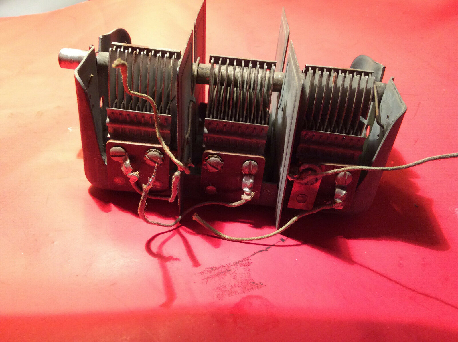

Model 70 air cap ground strap.

Found this pic on the bay of an original and the hookup. Similar to the one above, strange how they hooked up raw to one side, but used a insulated washer and star lock washer on the other side, not that it makes that much difference, it is what it ends up with, then again there may have been a reason.
