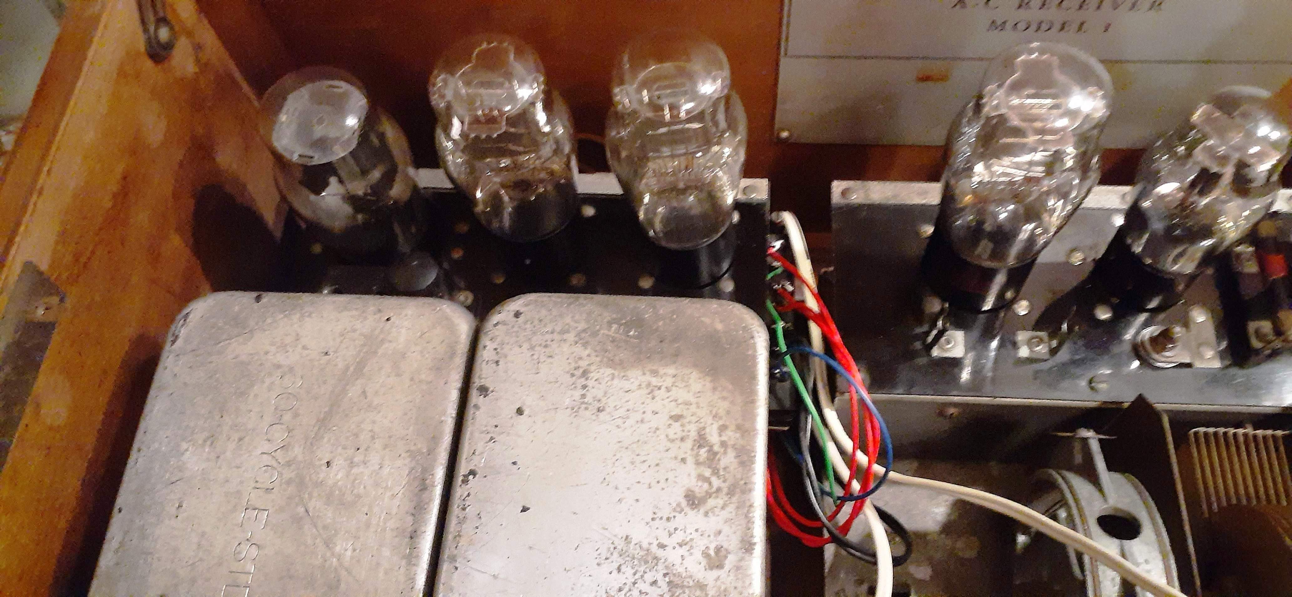

I've already replaced the old filter caps by cutting out the old ones (which couldn't be accessed to be restuffed because they were potted in tar inside an aluminum box) so I just wired the new filter caps onto the same terminal strip terminals that the old filter caps were wired to and they look fine there.

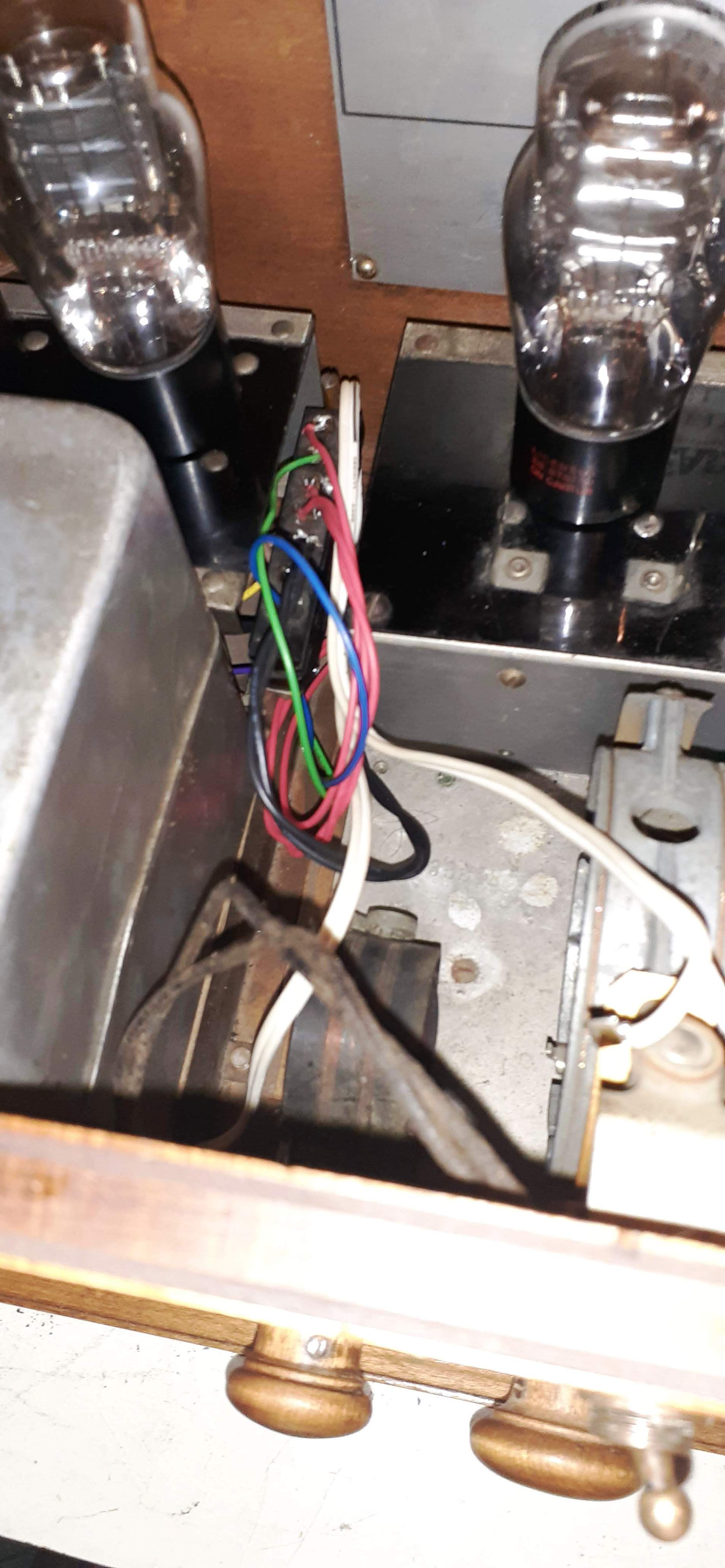

I've finished rewiring the radio's power supply circuit and I powered it up at first without any tubes in it and it drew about 1.2 Amps and with the tubes in it drew about 0.2 amps and the B+ voltage with the tubes in it (not including the tuner section) about 160 VDC which is about right and the High Voltage winding was producing about 400 VAC which is about right, and there wasn't any smoke or sparks or arcing so I think we're off to a good start, just waiting for my resplacement speaker to come in the mail for the speaker for this radio.

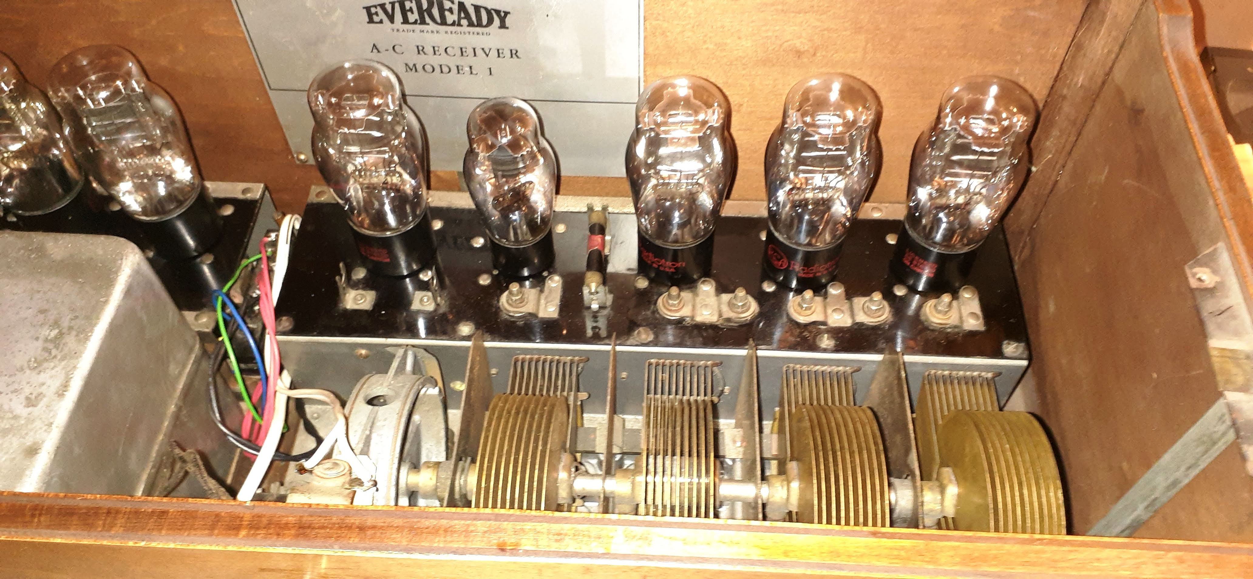

I just finished installing the new Plate resistor under where the old one was (it was attached across the terminals for the resistor mount that is ontop of the chassis), and then I hooked the tuner portion of the radio up to the power supply and installed the rest of the tubes into the radio (the ones for the tuner section) and powered it on and monitored the B+ voltage and it was nearly spot on at around 89.7 VDC once everything warmed up.
So it seems that everything is working as it should!

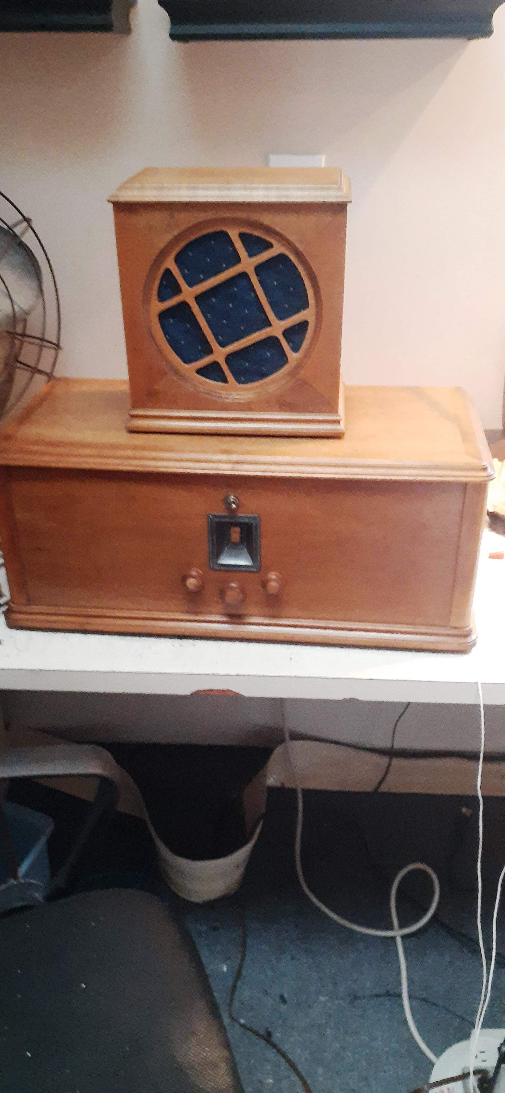

It is finally finished! I just finished putting the radio back together and finished fixing the speaker and I made a YouTube Video showing the radio working, I also to after shots of the radio.
Enjoy!
Levi
[Video: https://youtu.be/P-1rXkXH_IY]
Posts: 1,519
Threads: 69
City: Kansas city, MO.
Very nice job and it sounds good too.
