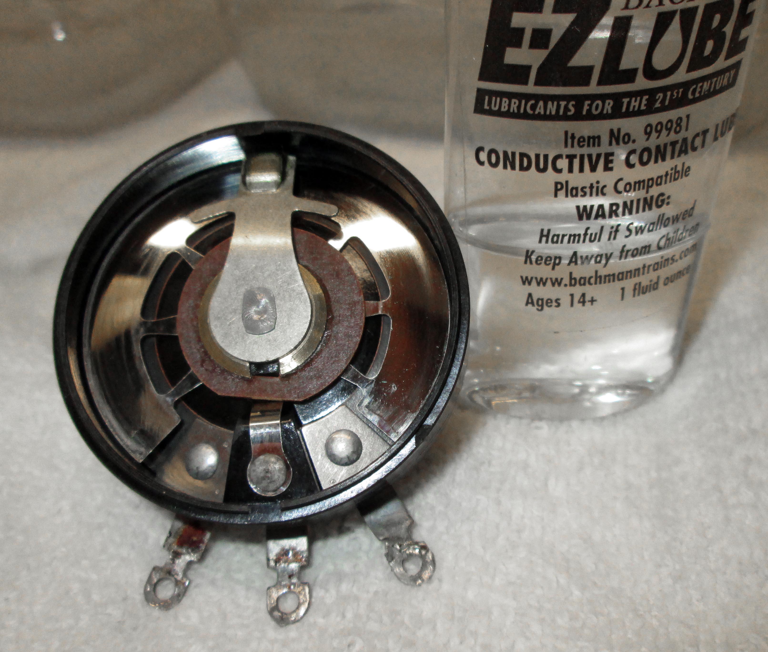

Quote:Need some help with the Volume POT here.  Pulled a lead off of it; it measures about 706Kohm Part# C.T.S. 5366-F  series # 40

So, I opened up the pot, cleaned it, lubed it and re-measured it.
(Oh and by the way, the inside cover of the pot had a date stamp on it of Nov 6th, 1931!)
It is now measuring 2.8 meg ohm across the outer terms.
From the center term, it does a clean linear measurement from side to side.
Yet, upon re-installing it; I still get noise when I adjust it.

Here is my question, based on the reference to the schematic, should I replace the original with a 500K ohm pot?

What did you use to clean the pot?
I found out, the pot is better left not cleaned but only lubed. Cleaning dissolves some conducting compound off the top.

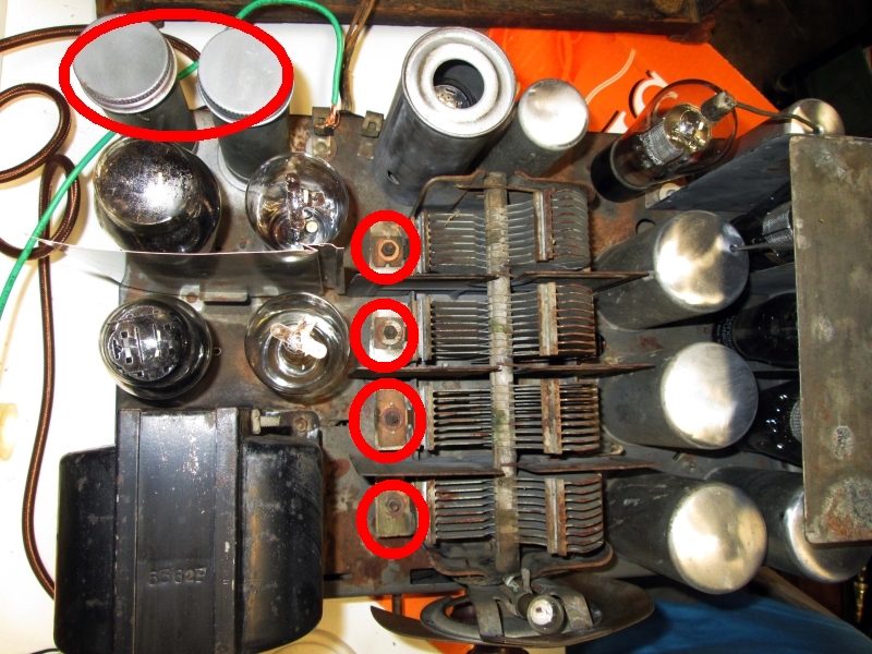

Kinda hard to tell but it looks like the mica (all 4)on the tuning cap may have been damaged when blowing out the chassis.

I used a gentle plastic safe contact cleaner.
Guess its time to find a 500k pot...

Scott, sometimes the conductive layer of a pot just gets worn away and all that can be done is to replace it.  Some of the pots are wire-wound and not subjective to being worn away and respond better to cleaning.  For lubing a pot I like to use Deoxit Faderlube.
Quote:Hi Henry, I'm still learning my way around.  Could you please help me understand which one(s) you are talking about?
Henry is talking about the 4 areas I have circled, they have a thin mica sheet under the adjuster.  It's hard for me to tell if they were damaged but I don't think it would cause a lack of total reception if one or two were slightly damaged:
