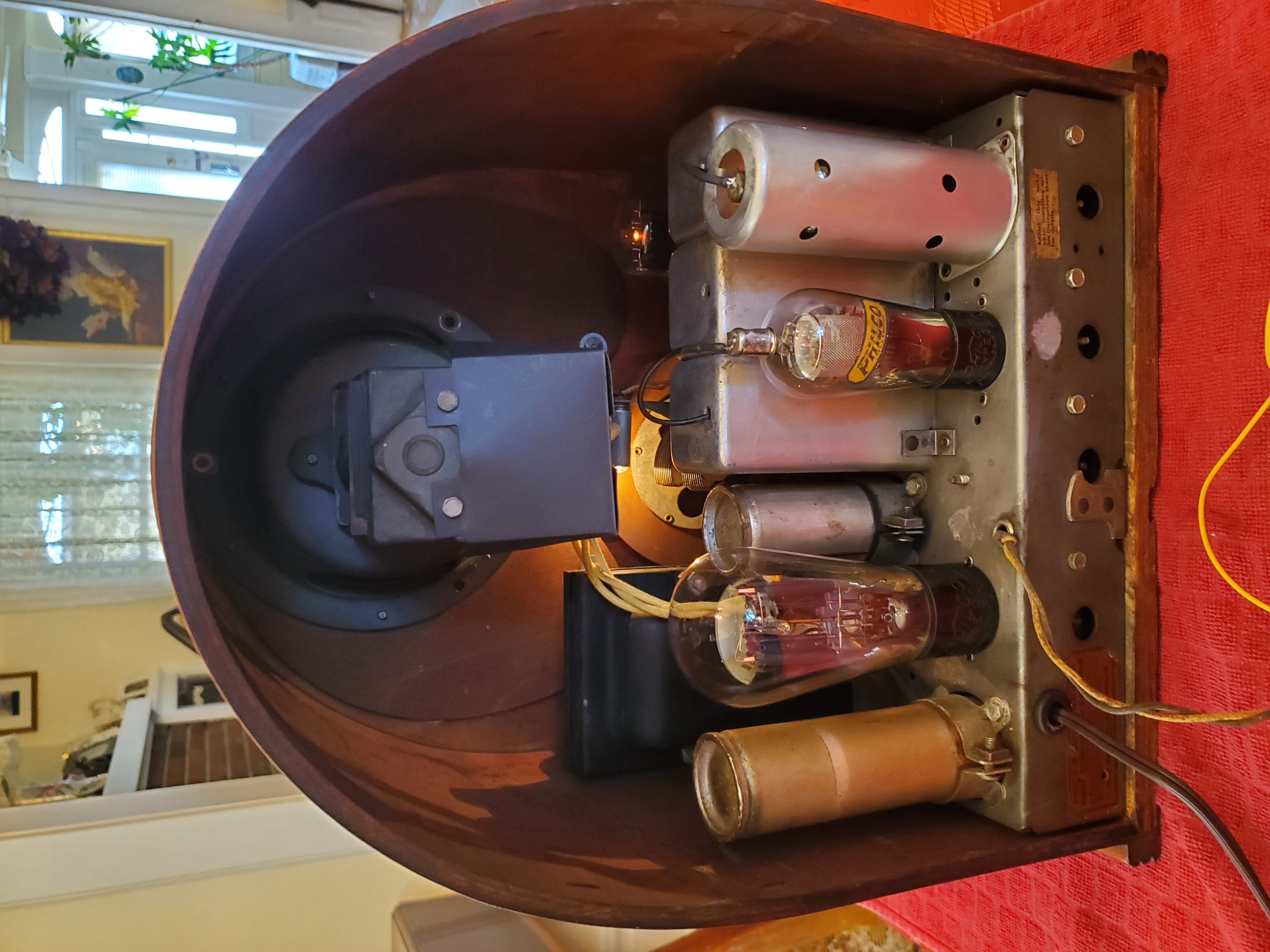

Just wondering if I put a higher wattage 16K resistor in place of the one currently in the circuit would that help cool down that particular resistor? And with the higher wattage would that have an adverse effect , positive effect or or neutral effect on my detector oscillator tube?

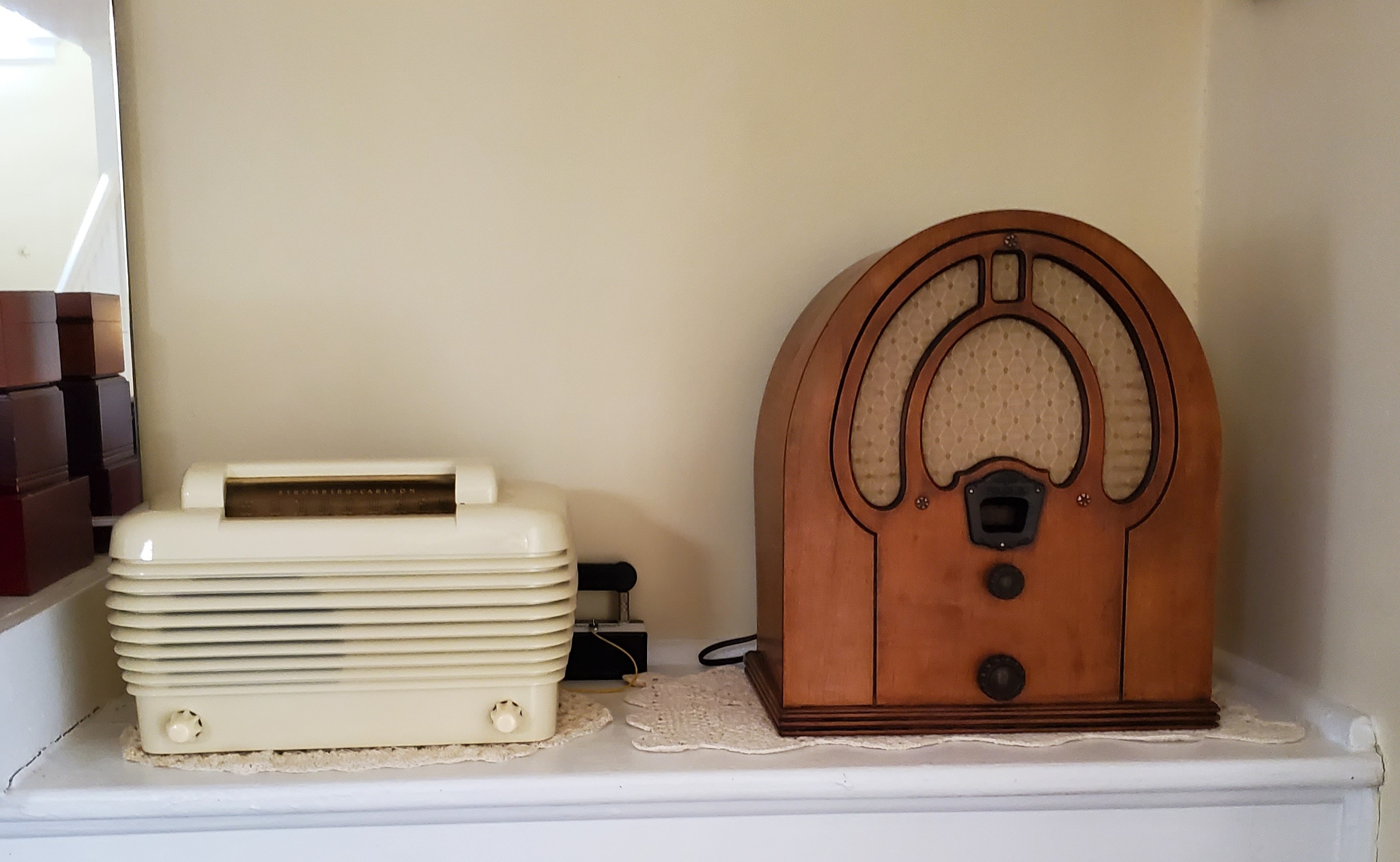

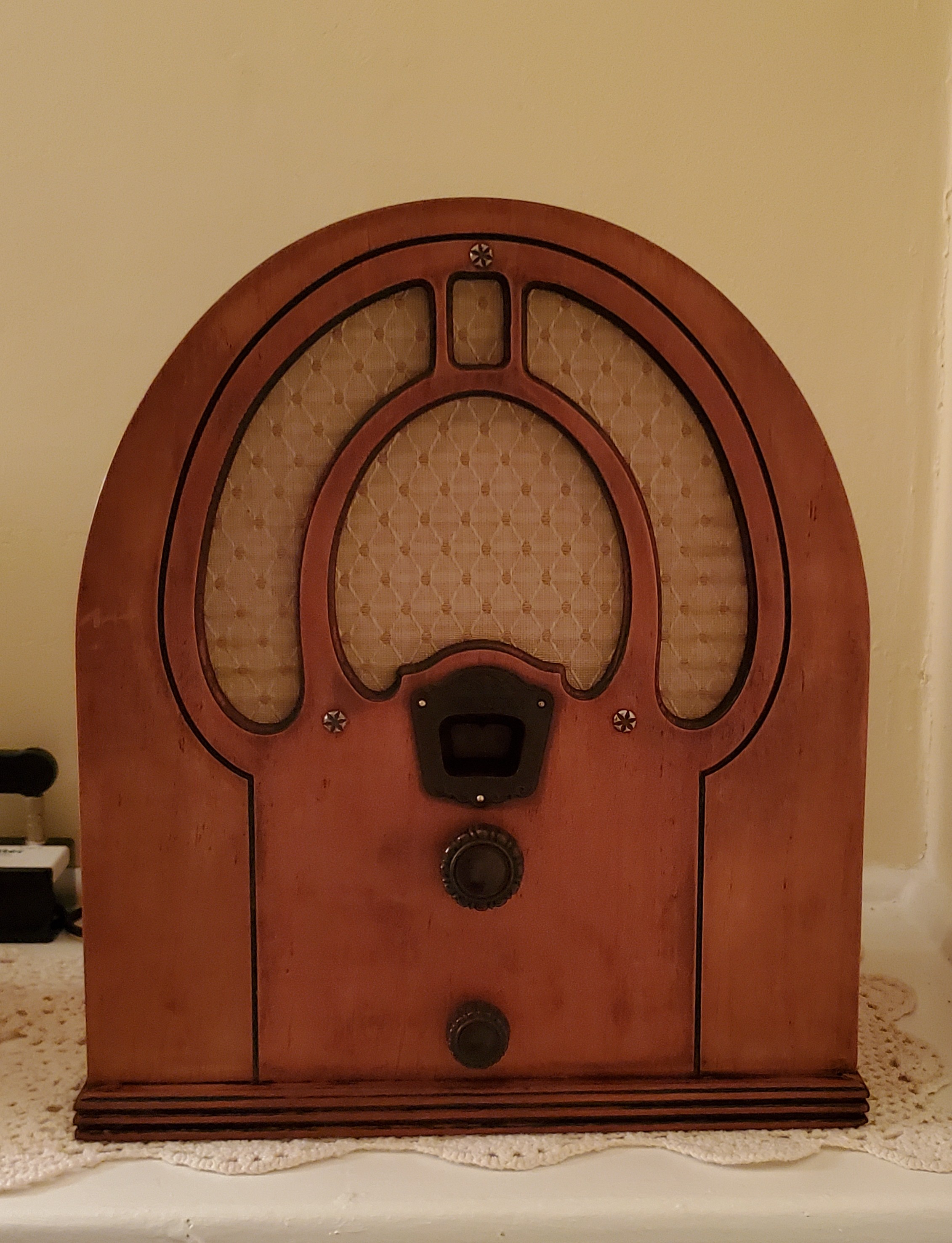

Just an update here's the finished radio and it works beautifully. Thanks for all the help from the forum.
You might want to flip the knobs around the other way around.
Nice Philco. nice Stromberg.............enjoy.
Thank you lol I didn't realize I did that here's the fix knobs are on correct now.
It's one of those moments....you realize something's wrong but cannot quite tell.
Icon_lol
Like one of those pictures where the guy is upside don but his mouth is not. Icon_smile
