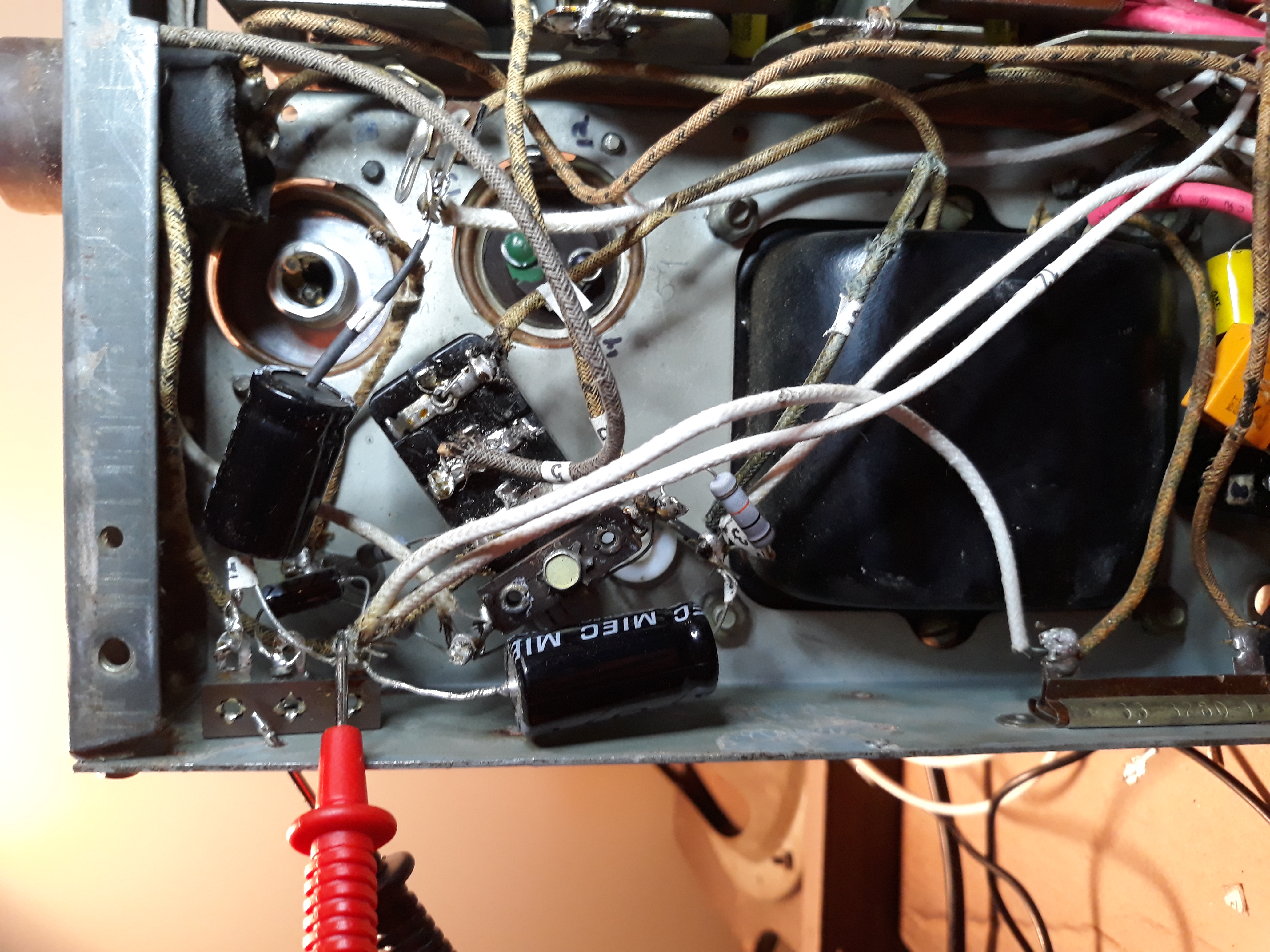

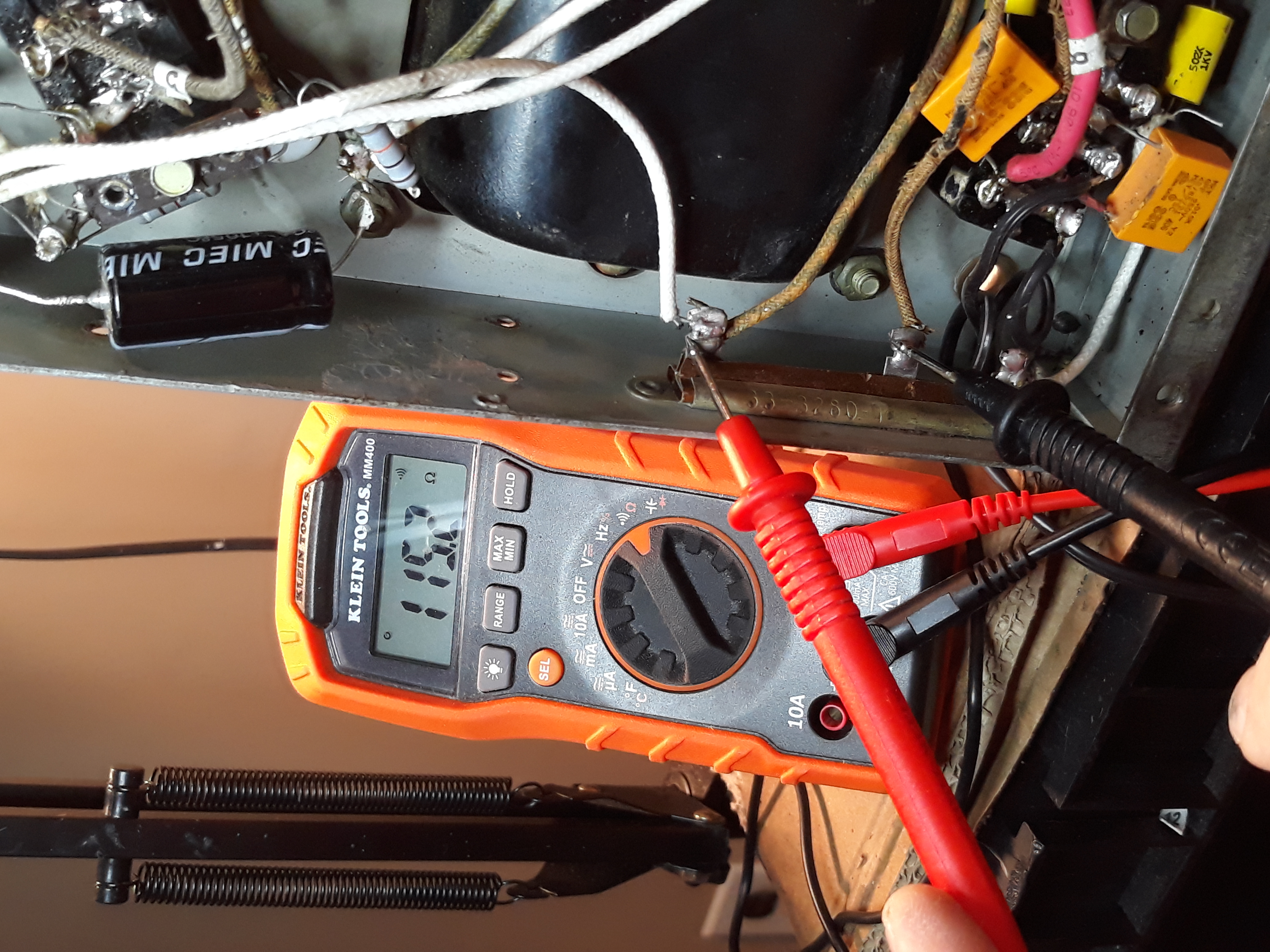

On R58 power on I'm getting 120v. When I ohm R58 I'm getting 115 ohms, the print says it should be at 109 ohms. Where I was getting 3 meg ohms was at the connection point of C59. I'm wondering if I'm placing the probes at the right point. I took a picture but doesnt look like I can attach it to the thread.
I have one probe going to chassis ground and the other probe at the point where the negative side of C59A, C57, and CT coming of R58 come together. I was going to ask if this was the correct connection point that others are referencing stating 128ohms.

Picture of the 115 ohms on R58
I would reflow some of those solder joints, they look a little flakey.
115 ohms sounds OK.
 Your are measuring one half of R58.
 What is the reading across both halves together of R58?

Stick some making tape on the components with there circuit numbers. It helps me. Again I am not  familiar with this radio.
Oh and it's helpful when soldering to turn the caps so you can read the values on them.
Also, what's with the safety caps on the outside of the bakelite block? To replace the caps in that bakelite block you have to REMOVE the old ones inside it. That is done by heating the block in an oven at about 250F until the resin inside melts out, then pulling out the guts, then replacing the guts INSIDE with the two safety caps. If you don't remove the old ones inside they can still short and form a shock hazard to the chassis.
