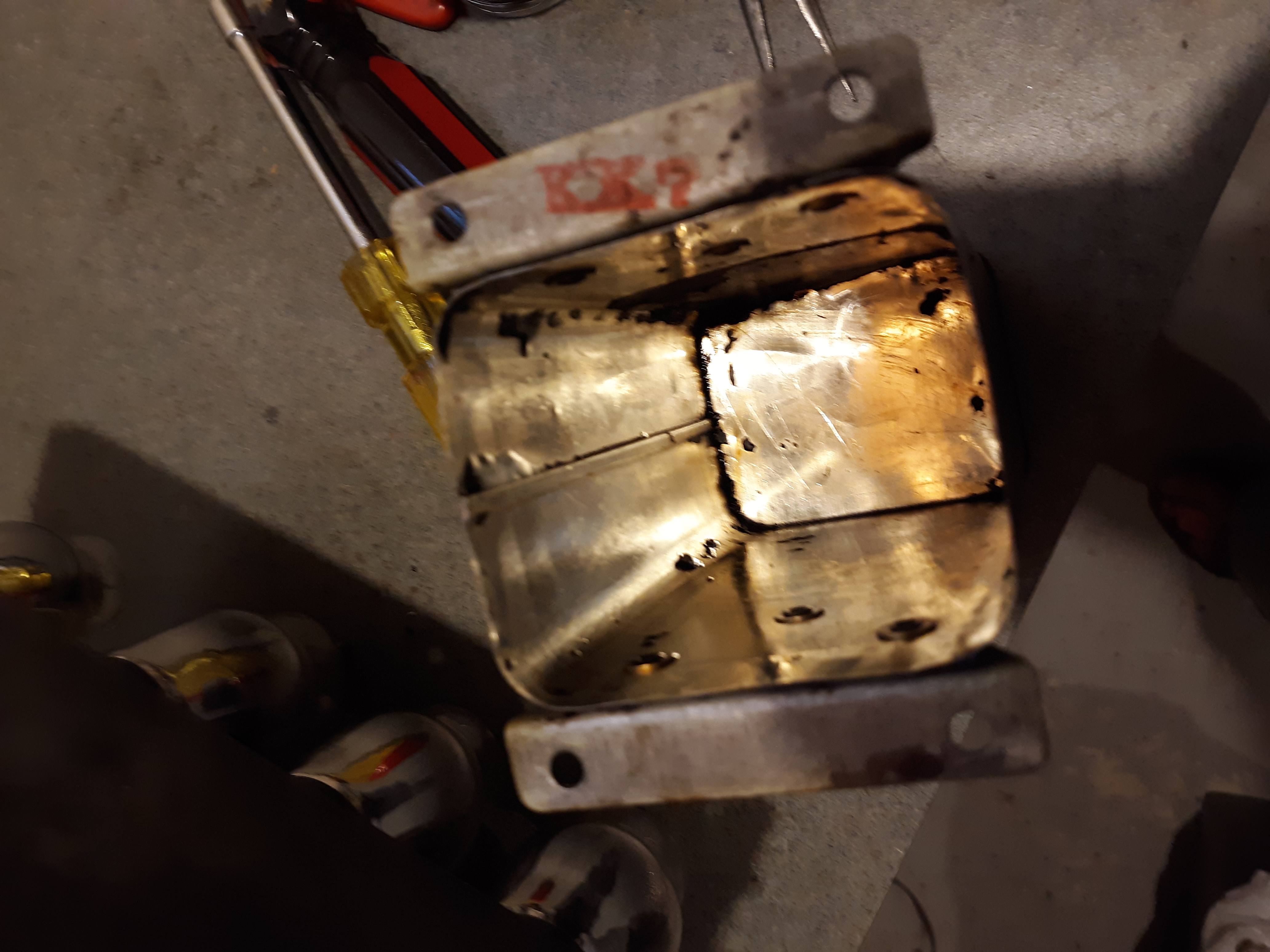

When I did my 20 cap can I propped it over a large metal can so the guts could fall out into it. I then put that about a foot in front of my garage torpedo heater. About 3 minutes of heat and the entire works dropped out, with the inside of the can bright and shiny! Take care and BE HEALTHY! Gary

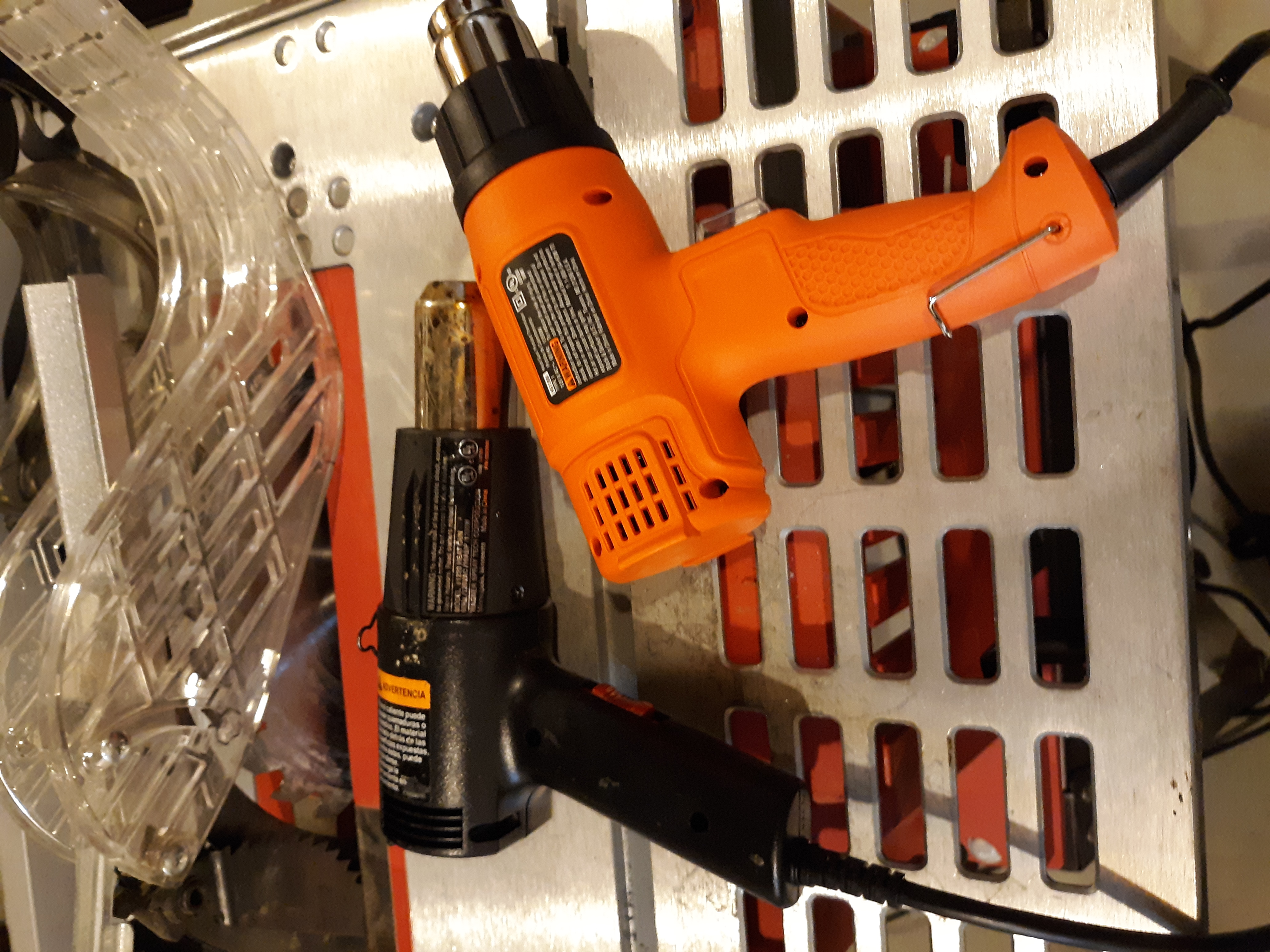

I am thinking of maybe using two Milwaukee guns.
The problem with just one, while you heat one side, the other is getting cold.
It is cheap, I remember I bought mine in Home Depot for $25.
Well, it did not quite fall out, but has really softened so that it all separated and I easily pulled the sections with needlenose pliers.
Then I gave it mineral spirit bath and cleaned it.
I bought a second heat gun (the orange one) for this exercise. It worked.
Obviously had to use different circuits, the two of them would pull more than 20 Amps.

I used a small propane torch in my garage so I didn't have to worry about overloading circuits. Although it was over 20 years ago I still remember that satisfying sound as it slid out and plopped into the coffee can
John
I used two tall cans as props, and aluminum foil in between to catch the nasty stuff. Lots of tar came out. But the parts separated inside, and were in fact not as one blob, and each one was too light to fall on its own. But came out easily once pulled, almost no effort.
Did propane torch do anything to the surface? It is tinned I think.
Interesting thing about the capacitors inside the block. When I cut them off (this time I did not desolder the wires coming from the radio; I l only cut off the internal wires coming out and then pulled the can; this way I will not have to re-solder the wires back or even to remember in what order they were, and it looks better - undisturbed original soldering), I measured the capacitances. Both high-voltage 1uF ones were fully open, that is in a few nF. And I did make sure there was a good contact when measured. The 0.13uF was also open.
But the 1.5uF one, that is at the ends of the big resistor, between the centertap of the xfmr and the lower end of the field coil was alive and showed 1uF. Funny!

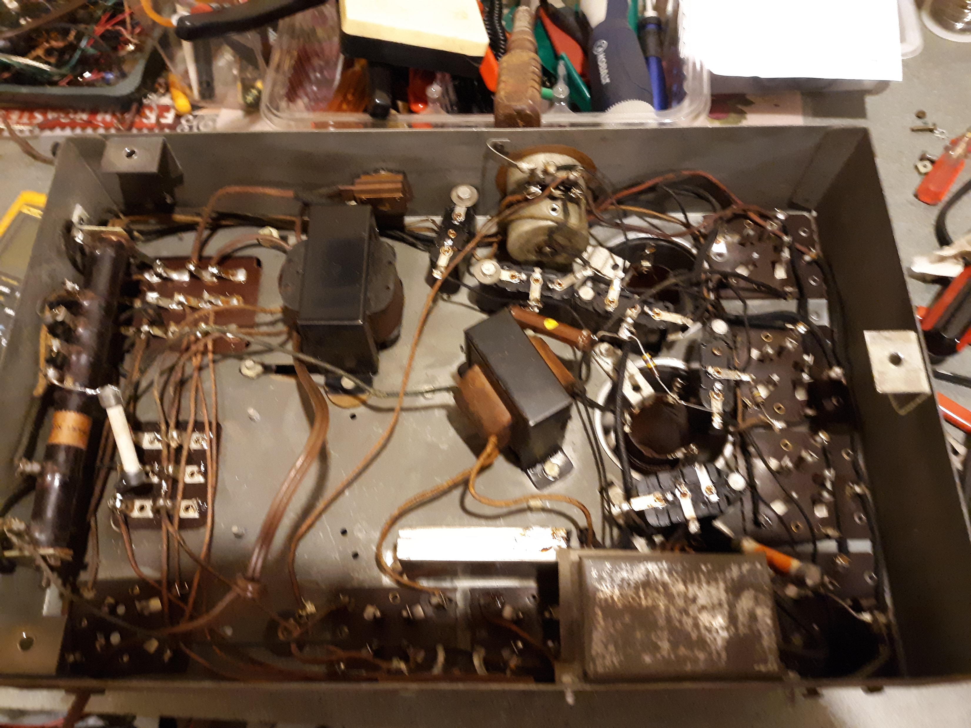

The recap is done. I did not count on it, but....there isn't much in 20 and it has tons of space.
I also added the missing rectangular can cap that should be living on the rear wall of the chassis which was missing. The 70 had exact same cap, so I re-stuffed it and now I am rid of all the old tubular caps (of which two are bad, obviously 50-s repair).
I put back the big can (I never removed the panel so the wires' soldering is original). No fish paper inside - no need.
The view on the chassis after recap
The big can

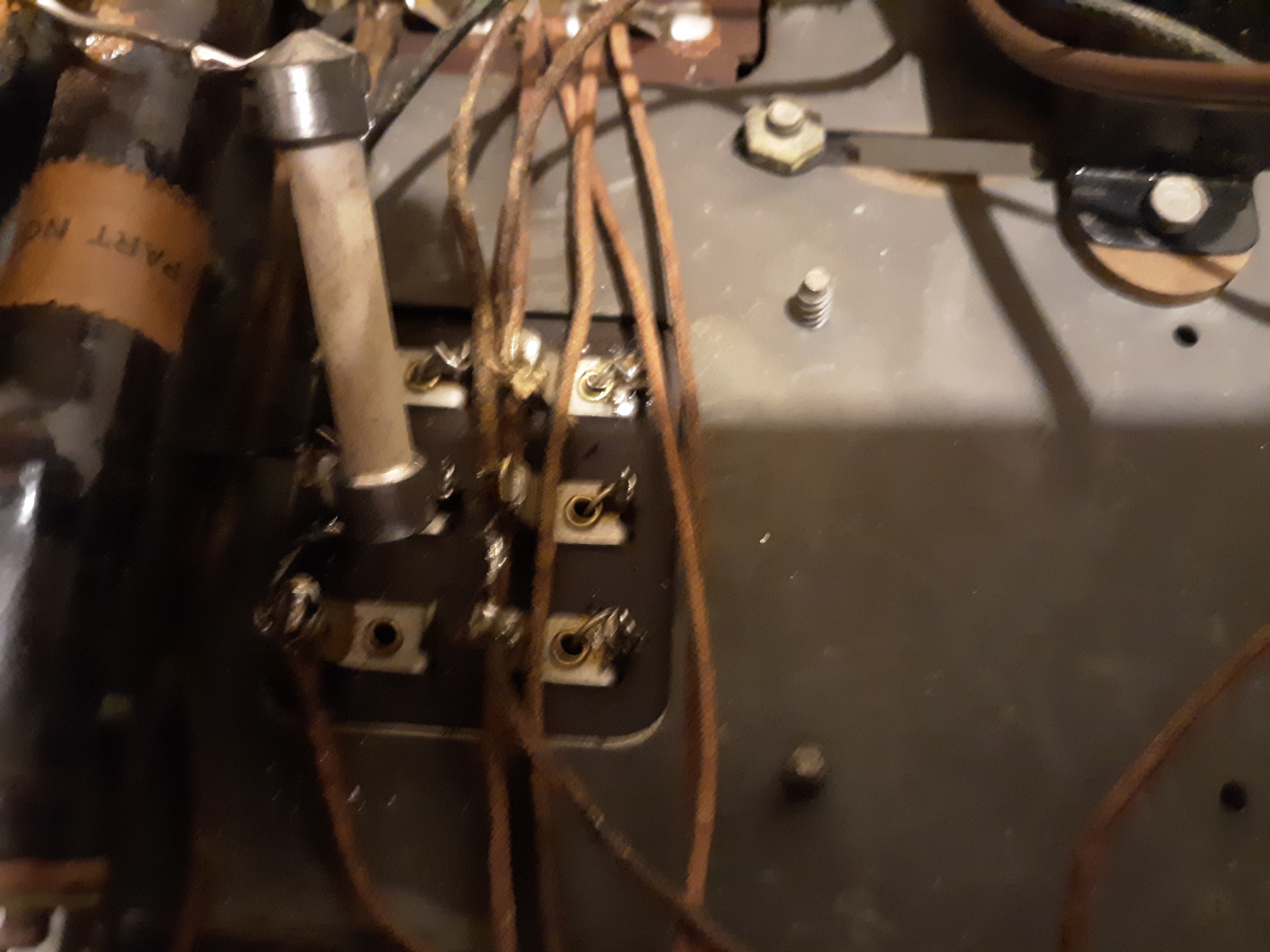

I decided to temporarily add small 1W or 1/2W resistors under the dog-bones where I had them. They either sub the open dog-bone or adjust the resistance if it is about 20% up. I did it because I intend to try to get those folks I found in NJ that carry exactly the same alumina tubes to get me some samples. If of course I get them. If not this would have to suffice.
Where I did not have dog-bones I left those old carbon ones that were there. (funny, 470K carbons are installed in 500K place and read 500K and 525K).
Again, if I am able to make the dog-bones in the future (I do have some duds so I could re-use the ends - I save them), I will put them in.
Now the tubes check and then alignment.
All tubes tested very good.

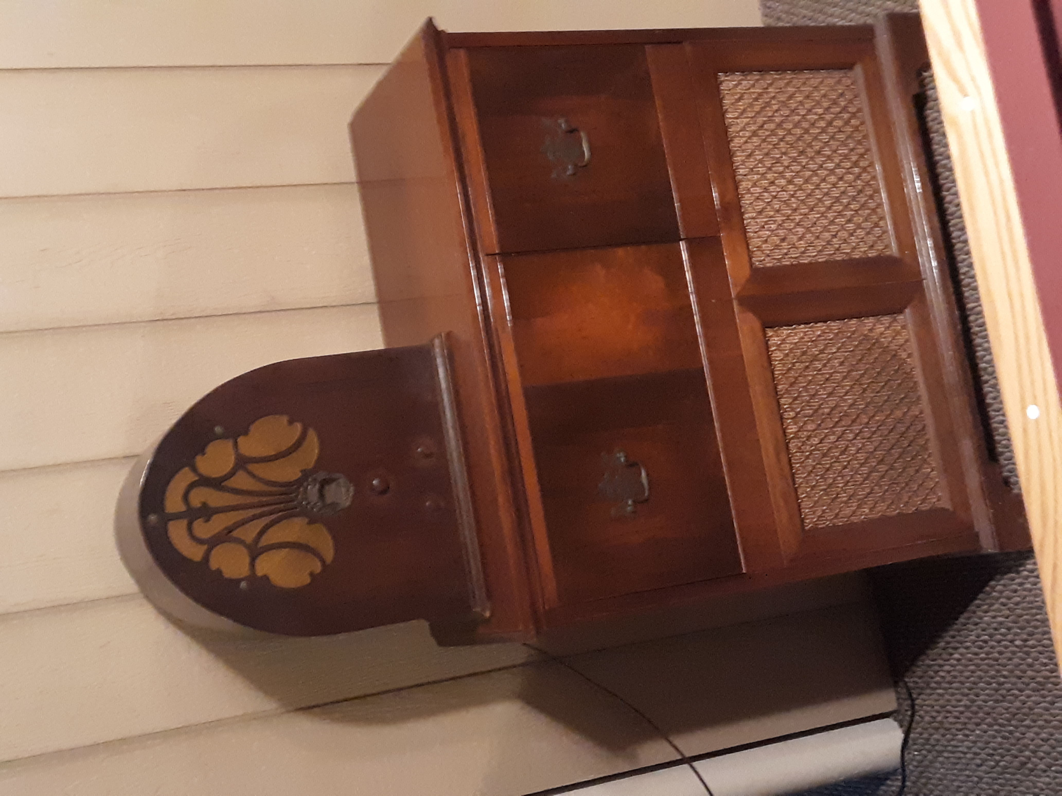

Here it is.
Posts: 2,263
Threads: 164
Joined: Jan 2013
City: Westland, MI
Do I see original speaker cloth? Looks good! Take care and BE HEALTHY! Gary
Gary
Yes I think it is original. And in good shape too.
