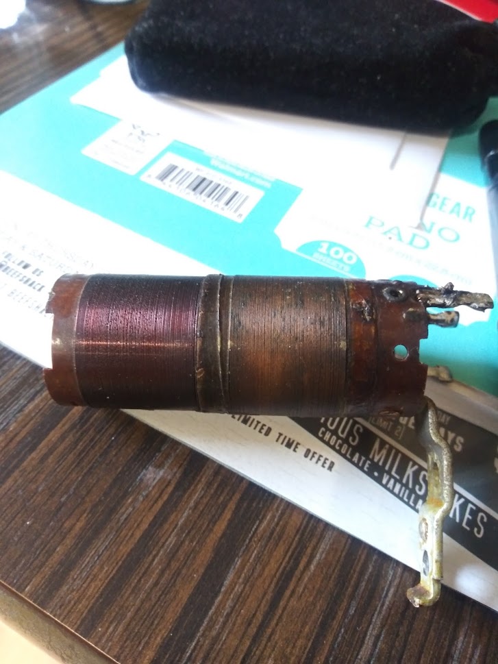

Hello Ron, you are correct. Open winding on RF coil 7.
I removed the coil. Found the break in the wire. I tried unwinding one turn and the thin wire
just breaks apart. Very discouraging. Any suggestions will be greatly appreciated.
As best as you can, try to count the number of turns. If you don't get it exactly right, don't worry - these coils aren't critical as to turns count. Also - and this IS important - note the direction the coil is wound in.
Rewind with 38 gauge enameled wire. When you are done, the radio will work again although it will have to be aligned.
Thanks Ron I will order a roll of the wire.

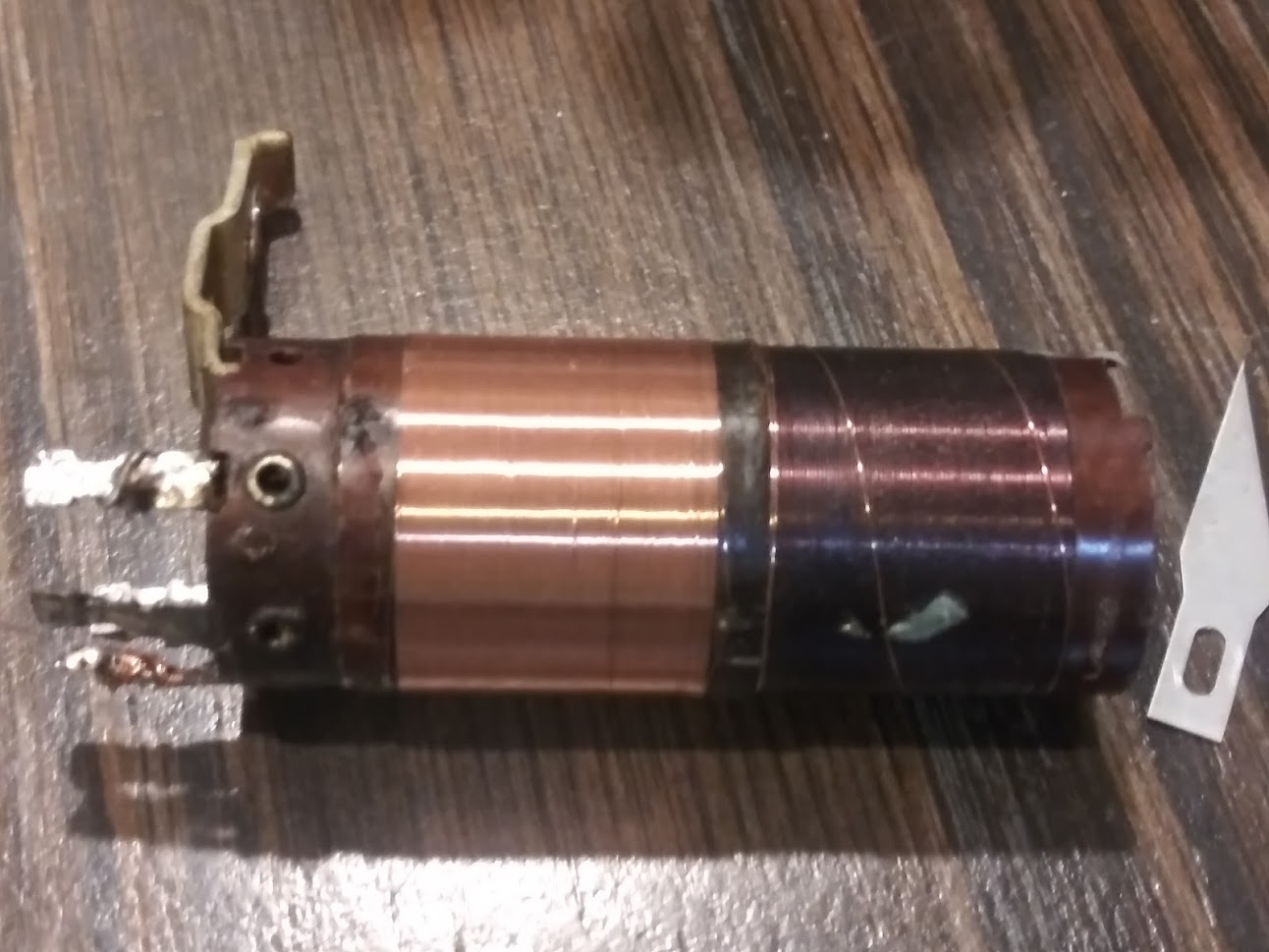

Success! Radio is playing perfectly. I measured the length of the windings and took a picture, zoomed in and counted 94 turns. I rewound the coil with the new 38 gauge magnet wire, it was difficult to keep track of the turns, so I wound it till I reached the length measured. I counted the turns under a microscope the count was about 150, at 34 ohms. I installed it thinking I can always remove the turns if I cant align it. To my surprise the radio played. Not only did it play, it picked up stations clearly from 560 kz to 1400. The stations were exactly where they were supposed to be on the dial. I don't think an alignment necessary. Thanks again
Attached are before and after pictures of the transformer.
