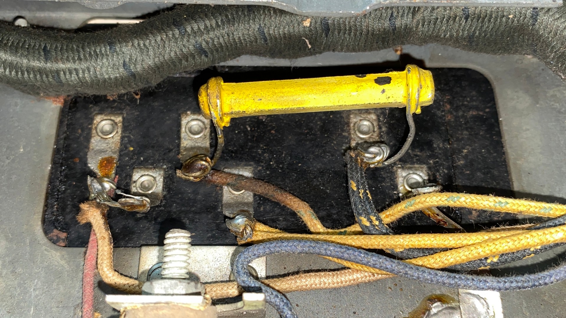

I was thinking about your last post so I looked at some of my photos.
There is a tan wire in my 65 which connects to terminals 1 and 2 of the filter condenser block, goes into the wiring harness, and comes back out near filter choke (21) where it connects to one terminal of the choke.
See photo below.
Thanks!  That was the one that I replaced when I wired the number 1 terminal back into the system.   The original tan wire as well as the connection to the 80 was moved to terminal 2, and I left them there and completed the circuit by wiring #1 to the filter choke, so my 65 is now wired in accordance with the schematic if not in agreement with the original construction.  The only item I did not do was a jumper between terminals #1 and #2, but that circuit is now completed in any case.
