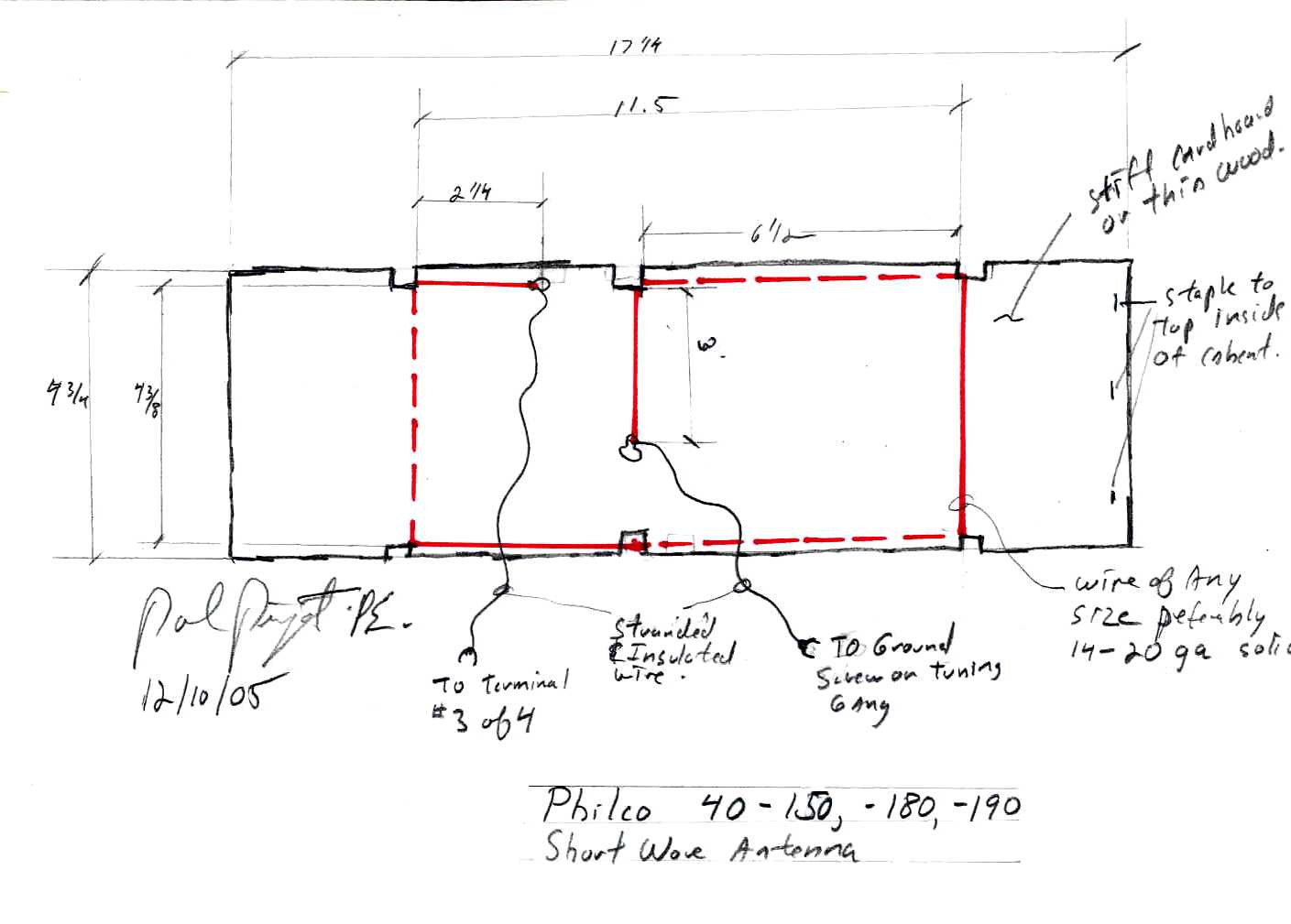

Here is Paul Pinyot's drawing of the shortwave loop (single turn) which mounts under the top of the cabinet - necessary for shortwave reception.
I wish I had his drawings of the AM loop, but I do not. Sorry.

Thanks for the antenna info. I am in the bidding on E-BAY and will construct the shortwave loop. As an experiment I connected the RCA "magic loop" antenna I have, and found a combination of connections which greatly improved reception beyond the 50 foot long wire I had connected. Richard
