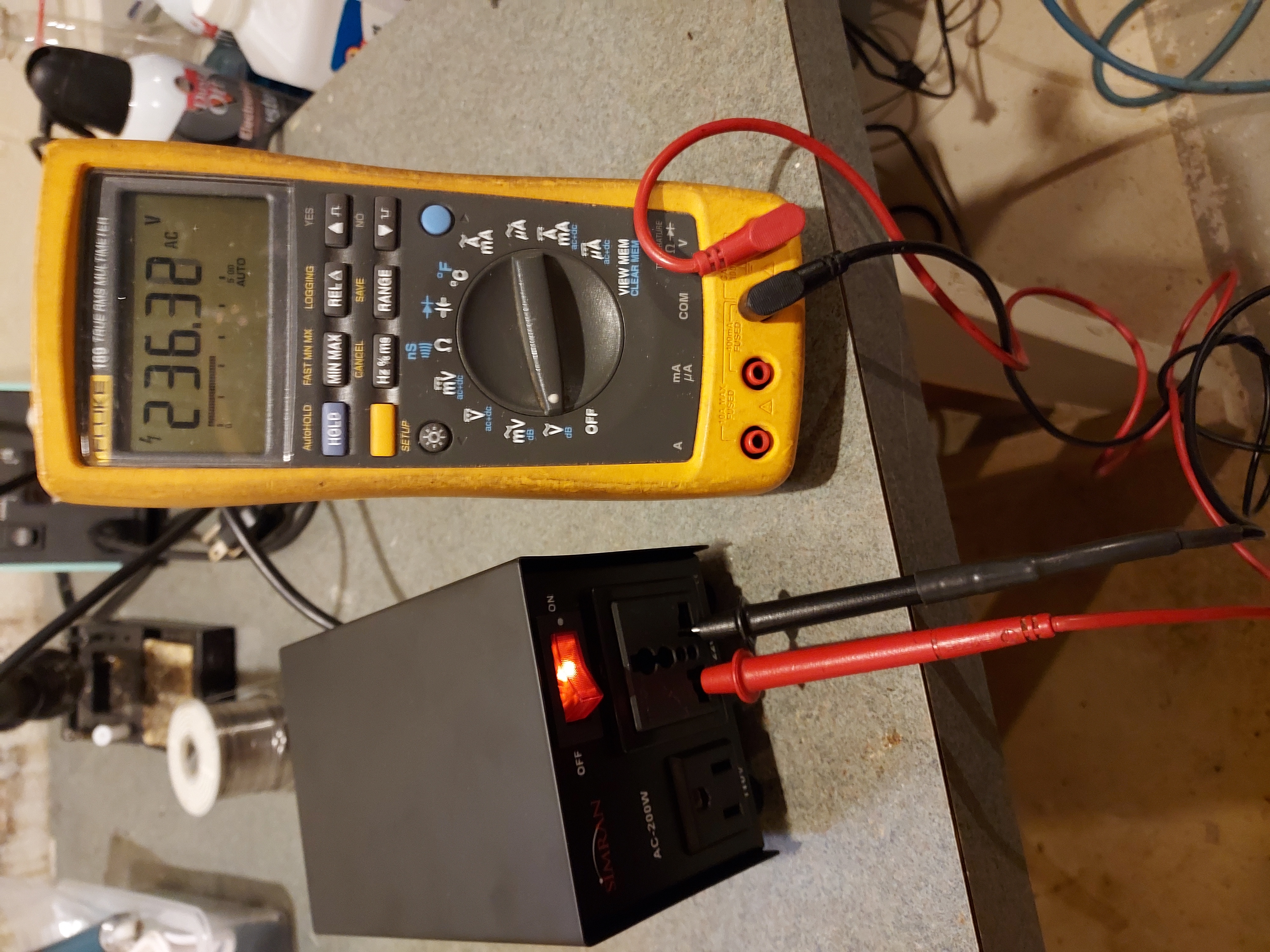

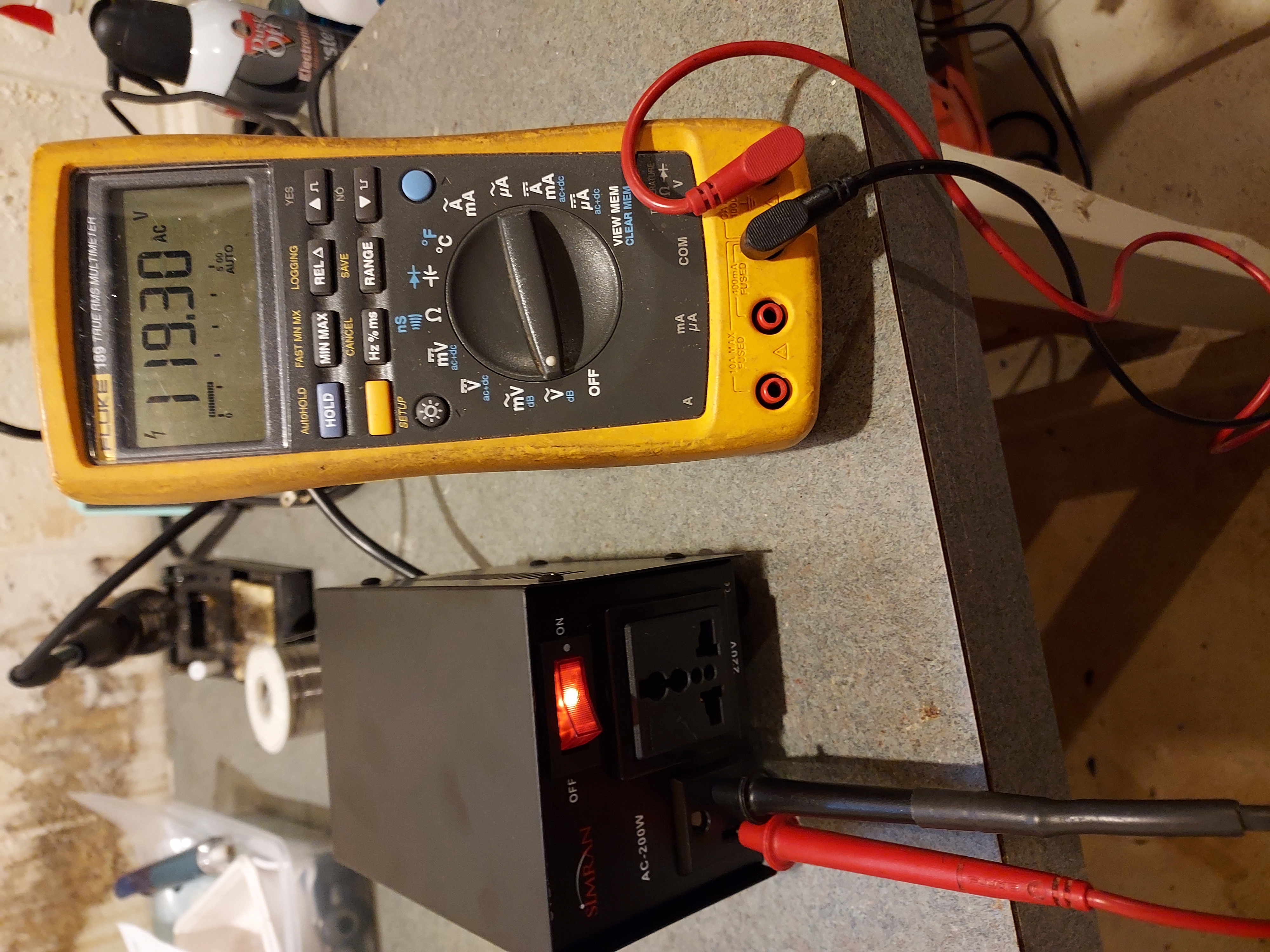

I do not need to make it, I have it.
They bought a smaller than needed one at workm and then they decided to get rid of it, and I appropriated it.
And good thing is, it is a transformer type, not a converter.
We needed it to test 220V device we made for Europe.
A 200W set, ideal for a small radio. Brand-spanking-nu!
I both steps up and steps down. I could flip the switch in the back and it gives me 60V and 120V respectively from my outlet.

I will use that Simran of mine together with the Variac to achieve 220V (I have 240V out). Though I see additional, not accounted in the sch, 70 Ohm resistor. The big green one, it is on the photos. I wonder if it was put there for that very reason: the voltage in Europe is also a bit higher than 220V.

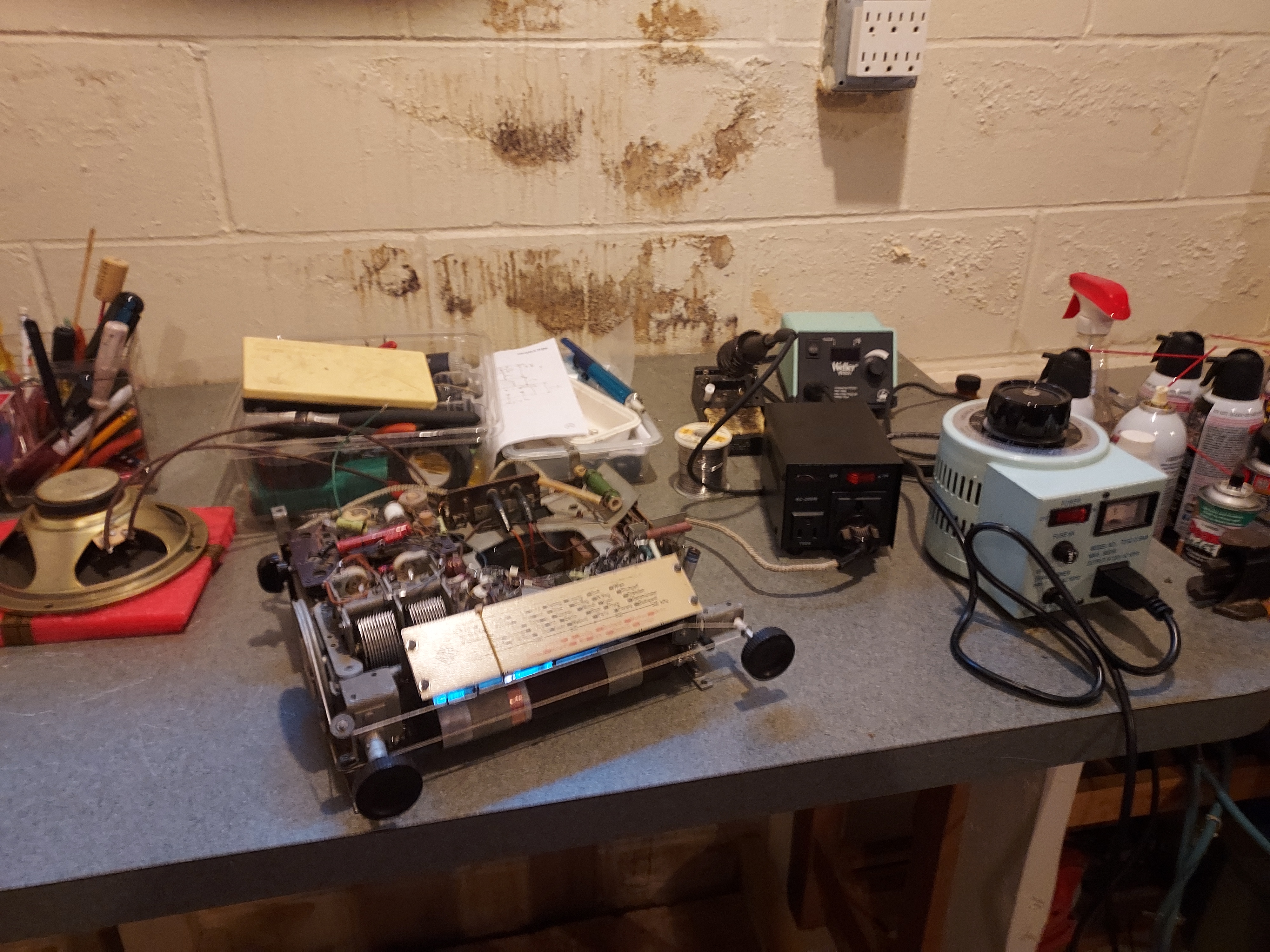

OK. I put the Simtran to VARIAC, set the latter to 110 VAC, connected an 8 Ohm speaker I have for tests, and plugged it in. The DC rose nicely, and the radio played.
I have a video, have to see if I want to put it to Youtube, considering.....I made the music clip less than 5 seconds.
I put less than 1' long wire to the antenna, to make the reception a tad better, as I am in the basement.
Now I need to align it. I have something I downloaded from Radiomuseum, in German. I hope this is alignment, but can't be sure before I read and translate it.
