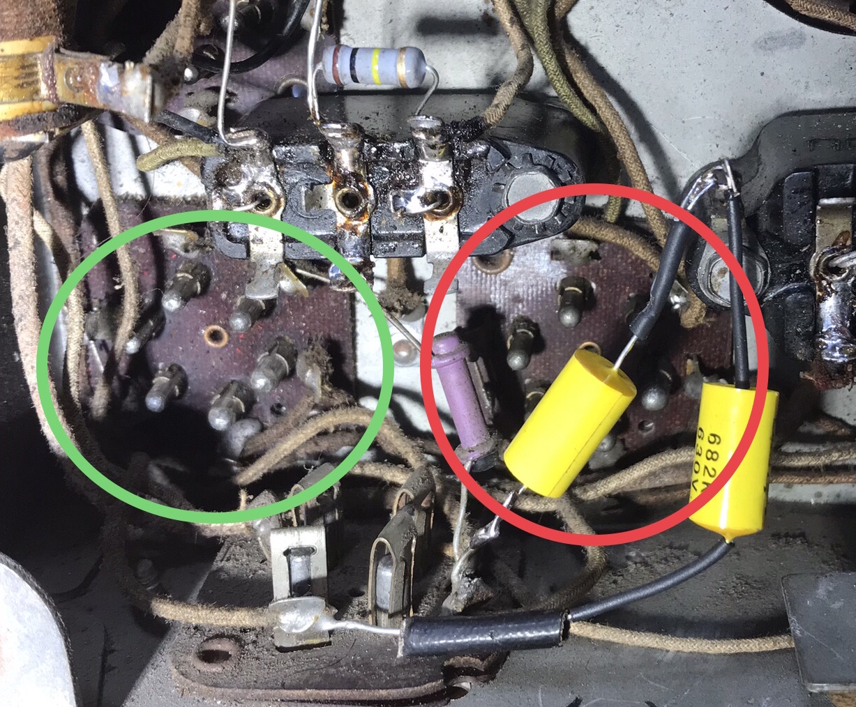

The first 42 output tube, red circle is giving me approximately 120 dc on both plate and grid. I say approximately because it seems to fluctuate. I have switched the 42’s around but the readings stay similar. The other 42 output tube, green circle, is giving me 365 dc on both plate and grid. No fluctuating there! The 42 driver tube is 246 on both the plate and grid.

Are you talking about the screen grid voltage being the same as the plate or the control voltage being the same as the plate. If you are talking about the Screen grids of the 42s, this is normal! These tubes are connected as Triodes on the 650. The screens are tied to the plates on all 3 42s (the "driver" and the 2 "Push Pull" output tubes), therefore the screen and plate voltage will match on each of the tubes. the "control" grids" (the input to the tube) should be at a negative voltage, especially for the driver) when measured against chassis ground. If the control grid was at plate voltage, the plates would glow red, melt, blow the output transformer, etc.! the Screen/plate voltages on the 2 42s that are output tubes should be the same.
If you rewired the speaker wiring, recheck it. If you miswired, you may have B+ directly to one output tube through the field coil, 1 leg of the output transformer on the other output tube and the other leg of the output transformer feeding B+ (modulated by the output transformer) to the rest of the radio.
With the power off and unplugged and the filter caps discharged, you should get 350 Ohm between the plates of the 2 output tubes. If you get more like 1.5K Ohm then it is miswired.
After correcting, if there are still issues, see the rest of my post.

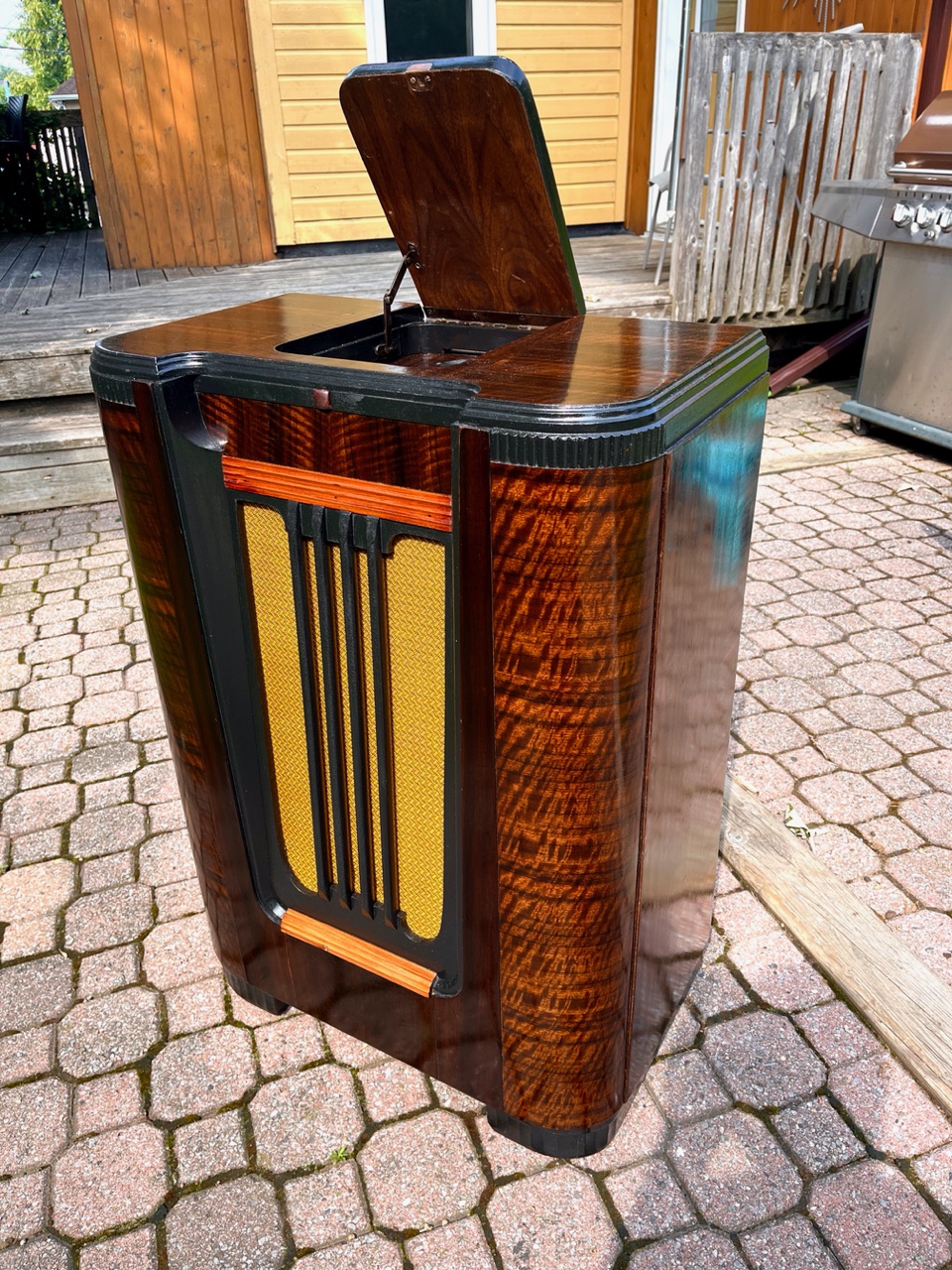

Something obvious popped up and I now have proper volume. I’m enclosing a pick of before and after. I think it turned out well for a rookie.
That is very nice work for a rookie. Although I have some knowledge of, but little experience in, cabinetry, I have always avoided sets which would require significant cabinet repair. I am planning to get into some cabinet work this summer, beginning with a 1946 Motorola farm radio which needs little surface work but which does have a largely separated frame. The surface work needed includes one area in which I have a bit of experience - touching up relatively small areas of worn or damaged photo finish.
Great job!
M R Radios   C M Tubes
Thanks Dale and Steve. Much appreciated. I can do cabinet repairs. I did my first radio cabinet restoration during covid for a fellow and that when I took up this hobby. I have no electrical experience and that’s why I try to get help from this Phorum.

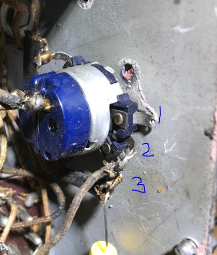

The pic below is your volume control from one of your posted pix.  Note the numbers.  BTW, the connection noted as number 1 should be well grounded to the chassis.

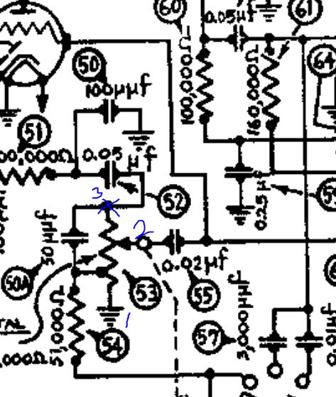

The next pic is a portion of the Philco 650 Schematic showing the volume control.  The numbers correspond to the numbers on the picture of the volume control.
To add a Radio - Phono Switch and Phono connection, do the following:
Obtain a single pole double throw switch and a chassis mount RCA Jack and some shielded cable.  Mount these in a convenient location on the chassis, but preferably away from the power cord and power transformer.  If there are no convenient holes on the chassis and you do not want to drill holes, then make a metal bracket.  SPDT switches are usually marked C for Common, 1 and 2, or something similar.  If not marked, the middle terminal is usually the common.
Disconnect all wires from terminal 3 of the volume control.  Connect these to one of the end terminals of the switch using a length of shielded cable.  Connect the common terminal of the switch to terminal 3 of the volume control using another piece of shielded cable.  Connect the RCA Jack to the remaining terminal of the switch.      Connect the shield at only 1 end, unless the switch and jack are not mounted to the chassis, or if mounted on a bracket, if the bracket is mounted to the cabinet and not the chassis.  In that case, ground both ends of the shield, one to the chassis, one to the bracket, but do so for only 1 shielded cable.  This is to prevent "hum" from "Ground Loops".
This jack will handle a ceramic phono cartridge or "line level" inputs such as fro a computer, CD Player, etc.  You could connect a guitar to the radio using this connection and the appropriate cable or adaptors.  It will not be really loud or distorted but will have a warm tone.

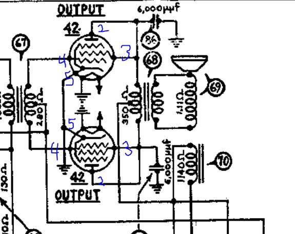

Below is the section of the Philco 650 schematic showing the output stage only, for clarity.
The Philco 650 Schematic shows all 3 "42"s connected as triodes (This was common; RCA did this in several sets using 2A5s).  Of course, Philco had more than 1 variation for several chassis and these may be connected as pentodes.  However, the plate and screen voltages should substantially match between the 2 output tubes.  In addition, the control grid voltages should also substantially match between the 2 tubes.
  • Power radio down and allow plenty of time for the "caps" to discharge.
  • Remove all 3 42s.  Ohm between Pin 2 and 3 of each tube.  It should read a dead short.  In addition, you should see that for each 42, pins 2 and 3 should be jumpered together.  If this is not the case, respond in a post.
  • Ohm between pin 2 (plate) of one 42 Output tube and pin 2 (plate)0of the other 42 Output tube.  The resistance should be about 350 Ohm.  Ohm between Pin 2 of one 42 Output and the center tap of the output transformer.  it should be roughly half the "plate to plate" resistance. Ohm between the center tap of the output transformer and pin 2 of the other 42 Output tube.  it should be close to the previous measurement and the sum should be the same as the reading between each output tube's pin 2.
  • Ohm between pin 4 (grid) of one output tube and pin 4 (grid) of the other output tube.  It should read 280 Ohm.  Read between each tube and the center tap of the interstage transformer as in the previous step.  Each reading should be roughly half of the "grid to grid" reading and the sum of the 2 readings should substantially match the grid to grid reading.
  • Ohm between pin 5 of the 2 output tubes and chassis ground.  There should be a dead short.
  • If all of these readings pan out, the plate and screen voltage readings between the 2 output tubes should match.  Let me know the outcome.

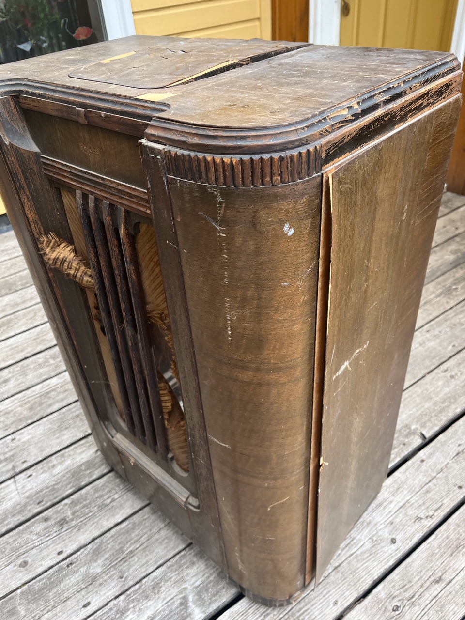

Hamilton what an exquisite refinishing job you did on that cabinet. Do you have spray equipment or did you use rattle cans? I ask because I have a 37-116 cabinet in need of refinishing sitting for about 5 years as I procrastinate starting on it because not sure I want to do it with rattle cans!
Ron
Philco 37-116.    Philco 70
Philco 52-944.    AK 84
Thanks MrFix for the time to explain the hookup for the phono plug. Clear and concise. Much appreciated. I’m at a cottage for a couple of days and will check out the 42’s when I get home. I do know however that pin 2 and 3 are jumpered together for all 3 of them. Thanks again!
462ron. There was a lot of damage to the veneer in spots and the fact that I had to make a new tilt-top piece since it was impossible to straighten the original piece, I went with Teak oil only. I put around 5 thin coats on and thats what ended up giving it the sheen. Some of the trim that originally would have used a toner was badly gouged in spots and was a bit easier to hide the gouges by painting it black. I know that not for purists but getting Mohawk toners here in Canada is difficult and expensive. I realize that doesn’t help you out but thats the procedure I used with this radio. Cheers
