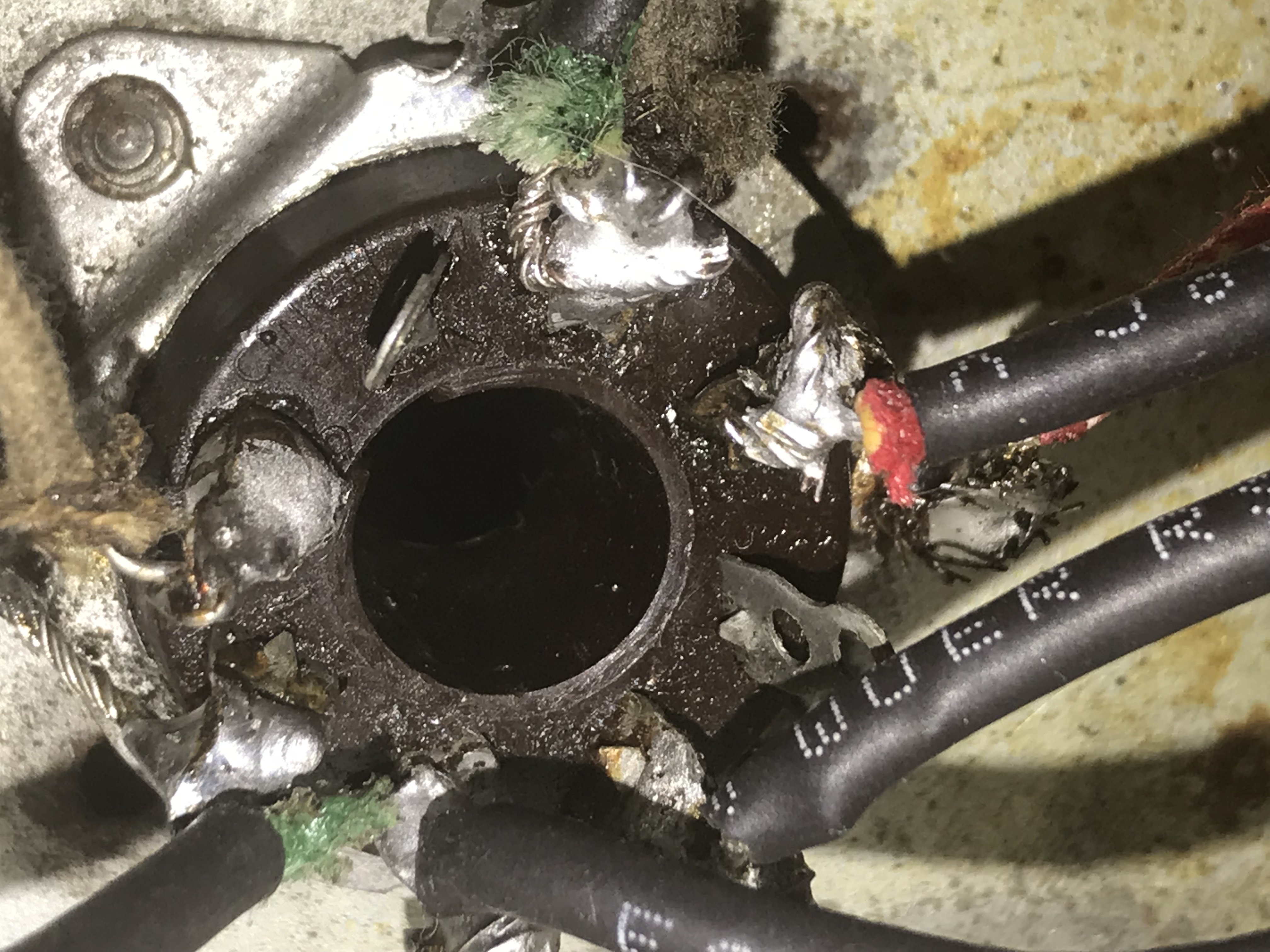

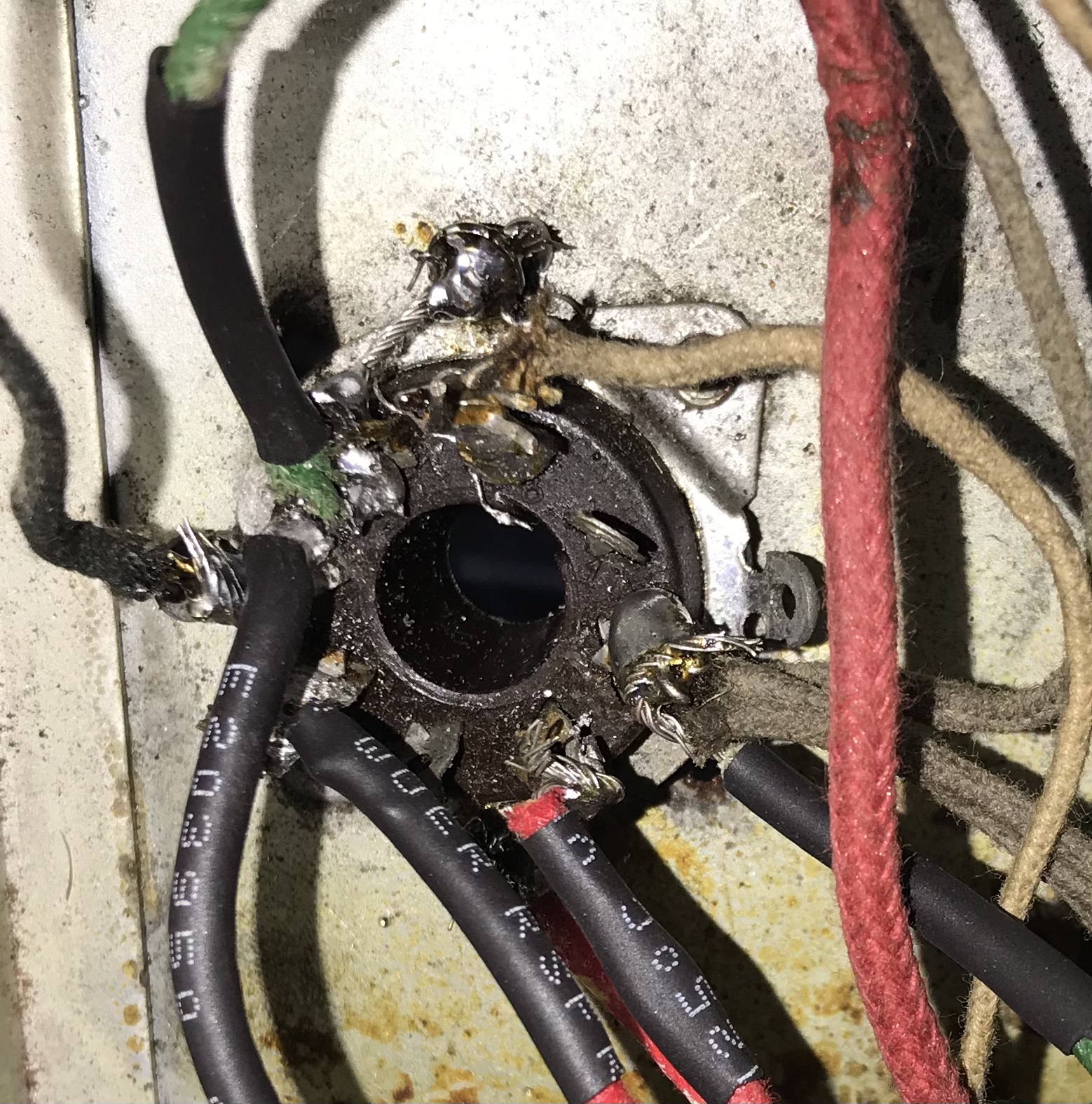

Thanks for the advice radio and otherwise. I’ve cleaned it up a little more. Reflowed the solder. Blew out the junk. Cleaned up with a small brush and some de-oxit.

Cleaning with Deoxit (any Deoxit) is not a very good idea. All of them are conductive.
Take stiff (used) toothbrush and dry (99%) isopropyl alcohol. Clean out well, to remove the Deoxit remnants.
I've seen that thing spark when getting in between high voltage.
I see a lot of some residue on those panels, it needs to be cleaned well.
About the heatshrink: yes, it is a good thing but is easily punctured with tinned wire. Make sure you trim the wires, especially the sharp sticking out ends in close proximity to the heatshrink (and otherwise to unrelated wires). From the pictures at these angles I cannot tell if there are areas of concern (like in the 1st pic the strands on the right are almost touching that ground lug), but you are there, so inspect it well.
Yes. I’ve gone back and gone over the socket with isopropyl alcohol as suggested. I’ll continue to clean this up.
None of the wires etc are touching each other.
Good advice on the de-ox it. It’s always lauded as a s
socket cleaning item - the issue of residue doesn’t get mentioned. At $18 a can I guess they’d like people to use it often and profusely.
Deoxit is an excellent product. But as every excellent product it has its side effects one has to be aware of. Kinda like medicine.
Personally when I clean sockets, I use some narrow thing, like a toothpick, soaked in Deoxit D (red, the contact cleaner type) and rub it onto the mating surface. This way it is not wasted. If you have to spray it, then sure, spray it, but do the clean-up afterwards.
I use dental proxy brushes and Deoxit to clean sockets. The miniature stiff bristle brushes make easy work of pin sockets. Take care and BE HEALTHY! Gary
