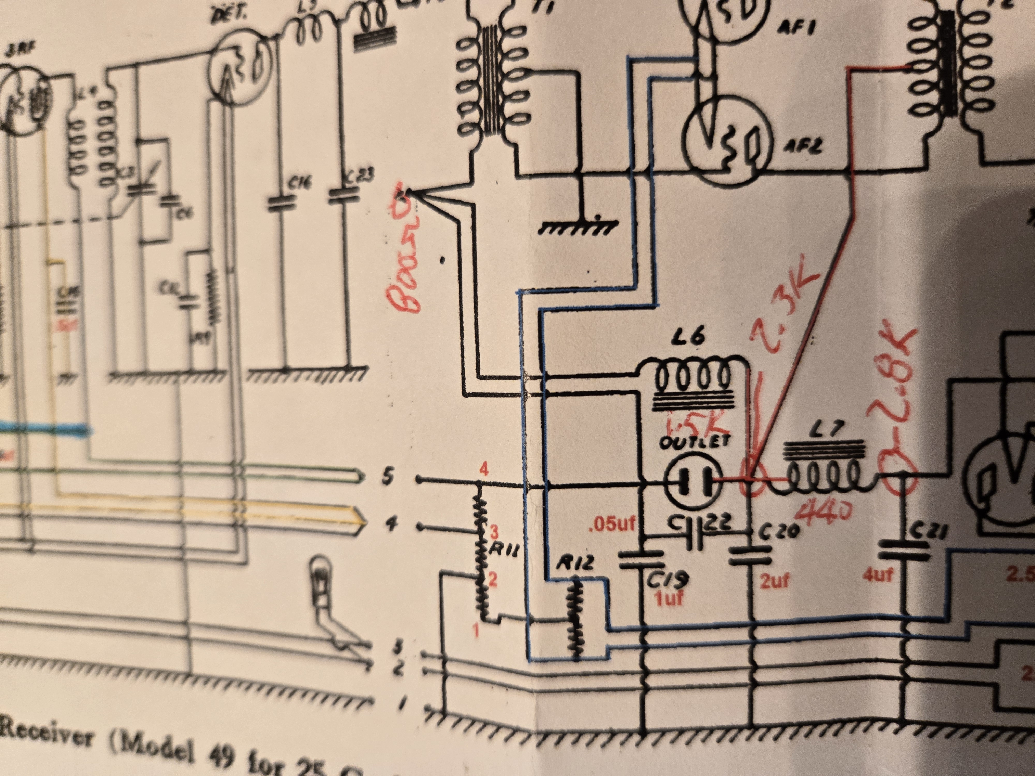

Took some readings of the inductors L6 and L7. L7 is 440 ohms and has resistance to ground on the c21 side @ 2.8kohms, the other side of L7 to ground is 2.3kohms.
L6 is 1.5kohms and has 2.3kohms to ground at the L7 junction and 800ohms to ground at the T1 transformer.

Secondly, what values did you use for the filter caps (C20, C21, C19)?  They should be rather low (Preferably the values called out in the diagram but no more than 10 uF).  if much more than 20 uF, the current will be too high.  Working voltage should be at least 450V.  Any lower and the cap may short.
If you can, break the circuit put a DVM set for 2Amp scale in in series between rectifier filament and junction of L7 and C21.  Plug everything in.  Per the RCA Receiving Tube Manual, max output current for a Type 80 rectifier with an expected output of 350V must be less than 125mA (0.125A on the 2A scale).  Anything above that indicates excess current draw.
Power down, remove all tubes except the rectifier.  If possible, place a second meter across C21, leaving the ammeter connected as above.  Power up, monitoring voltage and shut down if the voltage at C21 exceeds its rating.  Current draw caused by the filter caps, field coil, voltage divider (r11) should be about 30 mA or less.
Power down, and reinstall the output tubes.  Current draw should increase, but no more 30 mA per tube of plate current.  each of the other tubes (the 3 24As and the 27 should add no more than 5mA each.
Hope this helps.

Measure the total resistance of the R11 "voltage divider" resistor between Terminal 5 and chassis ground.  Measure between Terminal 4 and ground.  That resistance should be a little less than half the resistance between Terminal 5 and ground.  Note these values.  Note the DC resistance of the field coil.  I believe that it should be similar to the value received from measuring between terminal 5 and chassis ground.  My rational for this is that the Plate voltage for the output tubes is 250V. One end of the field coil connects to the point that supplies the output transformer. The plate voltage for the RF amps is supposed to be 120V.   This comes from the other end of the field coil which is essentially part of the voltage divider. (Terminal 5.) The screen voltages of 70V come from Terminal 4.
Reconnect all after troubleshooting.
Measure voltage at terminal 5.  It should be 150V.  If it is much more than that, the speaker field coil met have shorted turns or be the wrong one.
Measure voltage at terminal 4.  It should be 70V, and about half of the terminal 5 voltage.  If both voltages are high but proportional, then
the speaker field may be at issue.  If the terminal 4 voltage is low, then something is loading it down.  Check C13, 14 and 15 for shorts.
Unfortunately, the diagram does not give resistance values for the speaker field or for the voltage divider.

Mrfixr55, here are the results of the tests:
-r11 pin 5 to ground 3.8kohms
-r11 pin 4 to ground 1.4k ohms
-field coil = 1000k ohms
-it is not similar to pin 5
-pin 5 voltage 197vdc
-pin 4 voltage 70 volts
At this point i need to cool down that resistor.
