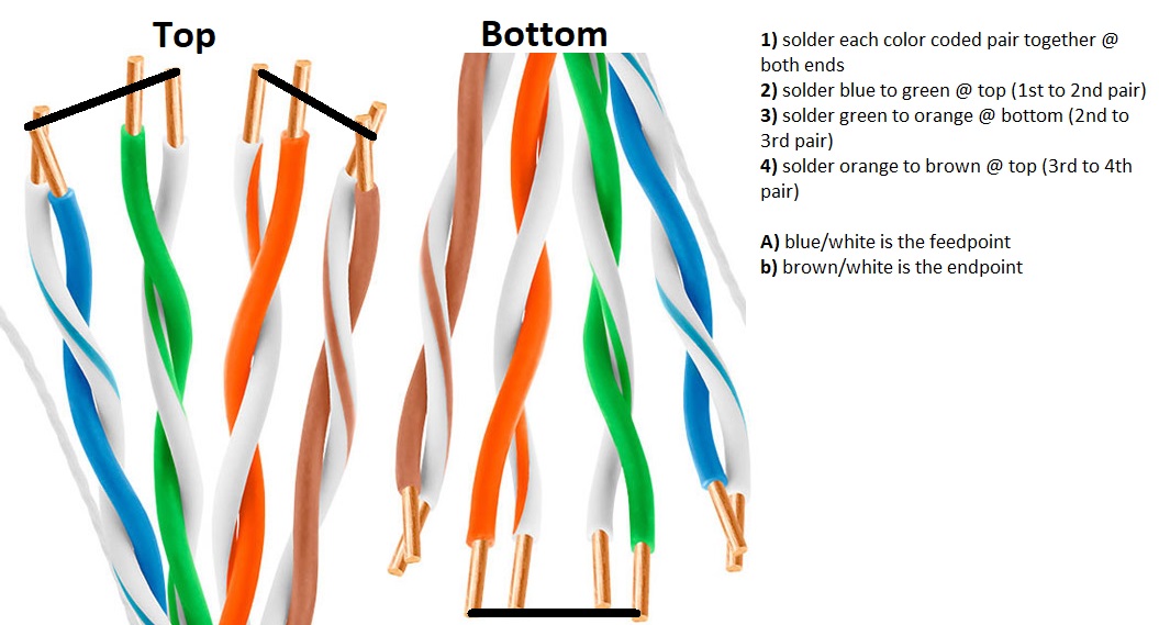

Here's one way to connect the pairs of an ethernet cable and leave the pairs twisted.  I assume the same could be done for individual conductors and still have the pairs twisted.  In both cases, the outer jacket could be left intact.

Rich,
That's how I built mine. I used unshielded ethernet cable and connected the wires the way you describe. I've even thought about using two sets of the wires maybe red and blue in series as a "transformer primary" similar to a loop antenna.
