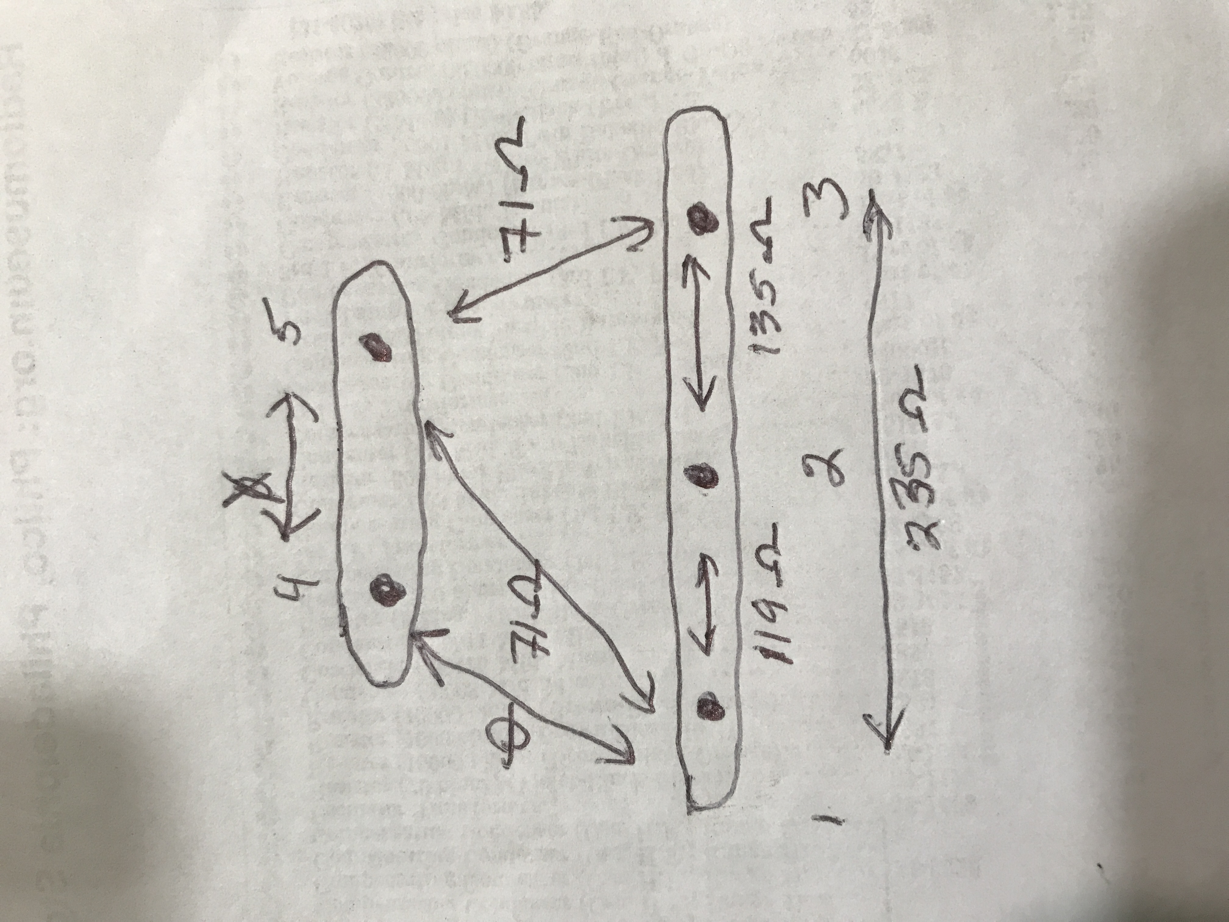

I was also checking my filter choke and audio transformer for ohm readings. I got 84 ohms on part 96, the filter choke. Not sure what it should be. I don’t see anything written on the schematic I have.
On the audio transformer the photo shows the readings I got. All good except nothing between pin 4 and any of the other tabs so I’m assuming the transformer is toast. Any suggestions as to a replacement or is there some way to work around this. I’m in unfamiliar territory.

Unfortunately it appears the primary of the transformer (83?) is open. This is very common for this transformer for this period. There's a slight chance it may be a loose connection between one of the wire leads and the coil wire. You can open the transformer and peel away the outer layers of paper to examine the wires. They will be soldered to the coil wires. I do happen to have one I just pulled from a chassis. Not sure how close a match it is but I can check. There's a work around that uses a coupling cap and the transformer secondary. It's in the Phorum library. I'm using the workaround in my Philco 650 and it sounds just fine. If you use it, be sure to completely disconnect the primary from the circuit.

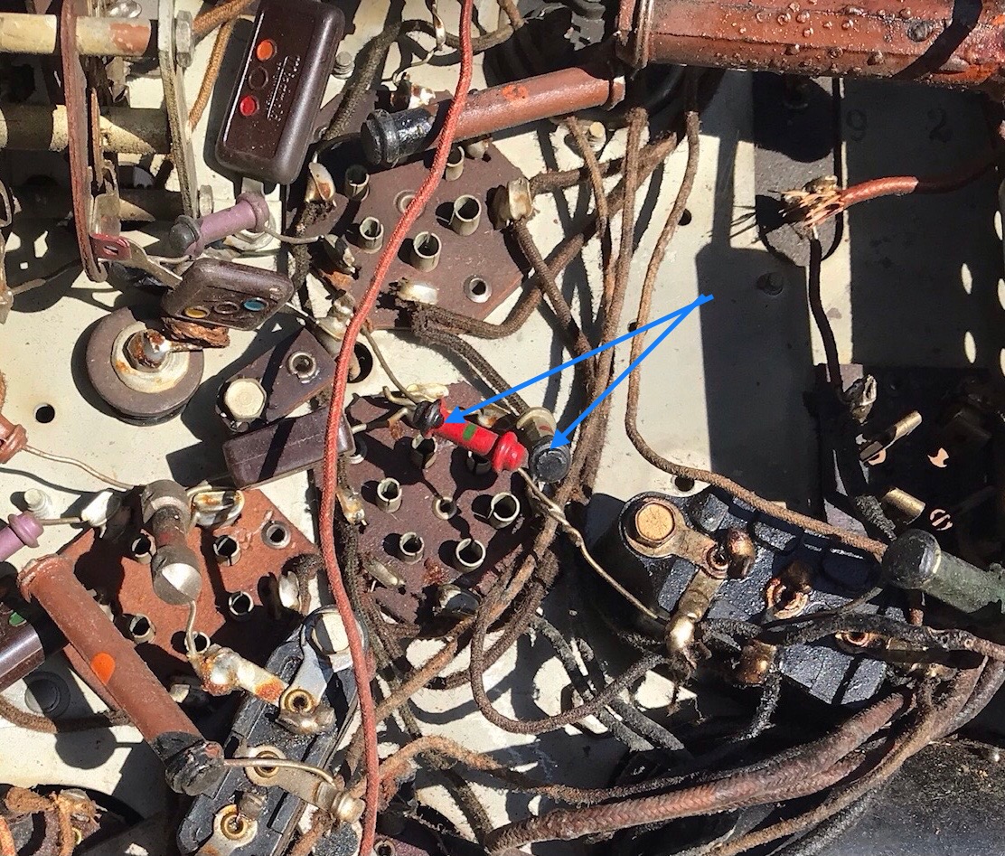

I need some advice on the two enclosed photos. The first shows a 8k resistor, part #42 and a 2 meg resistor, part #41. They are braided together at the one end and then soldered to ground on the bakelite block.
The second photo is a 500 ohm resistor part #14, and a .03cap (should be .05) part #15. Although it’s hard to see, these two are also braided together and both ends and then soldered at a common point.
Is this common and does it effect the values of either the cap or the resistors when they are together in this manner? The .03 cap is not original but the two resistors in the first photo look original.
I haven’t come across this before and I’m just trying to get a handle on how things were done and why they would have installed the parts in this manner.
Yes, Philco did this twisting parts and, no, that does not affect anything. Just a way to connect parts.
This is fairly common when two components near each other are to be connected to the same point. Saves wire space on terminals and can be set up prior to installation. If you look at the schematic, the two resistors in the first photo both connect to the tube socket on one end and ground on the other. The schematic shows the resistor 14 attached to the cathode and the capacitor 15 is in parallel with the resistor and the photo shows this to be true. Now sit back and have a sip of your favorite beverage, everything is copacetic.

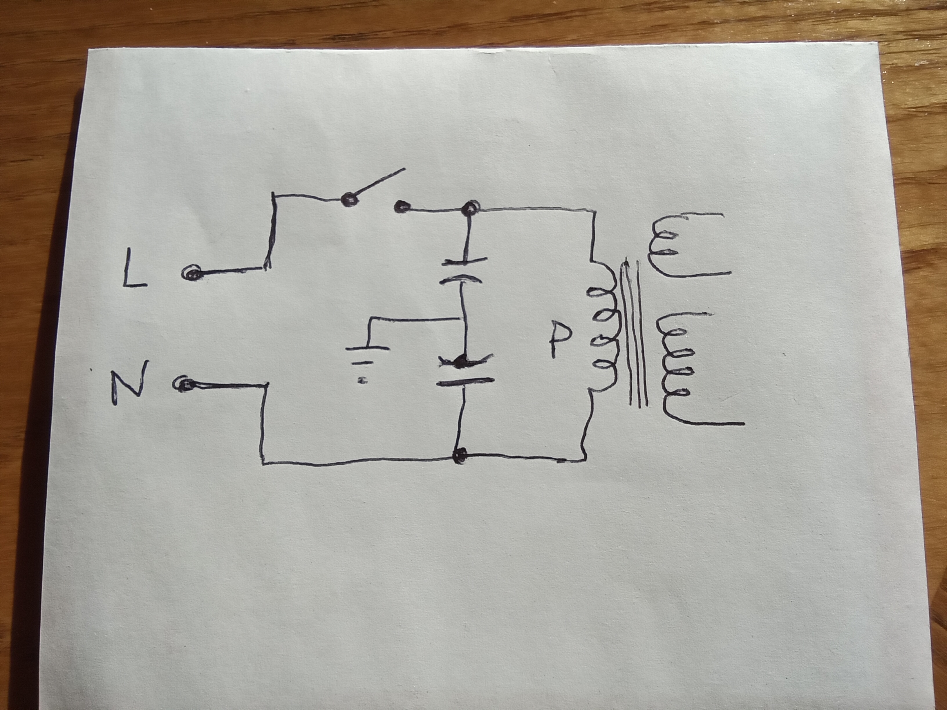

Rod you had mentioned about the power transformer primary block. I do have 2 .015 safety caps for that. Are there other concerns I should be aware of regarding that Bakelite blocks?
Yes, use Y safety caps and you should rewire the block to do it's thing after the power switch has been turned on. It's wired right now to be active when the radio is plugged in. Maybe Mike can add his 2 cents.
I don’t know how to rewire it so that it’s not active when plugged in. I just replaced the old caps with safety caps and the power cord was replaced but soldered into the same location.

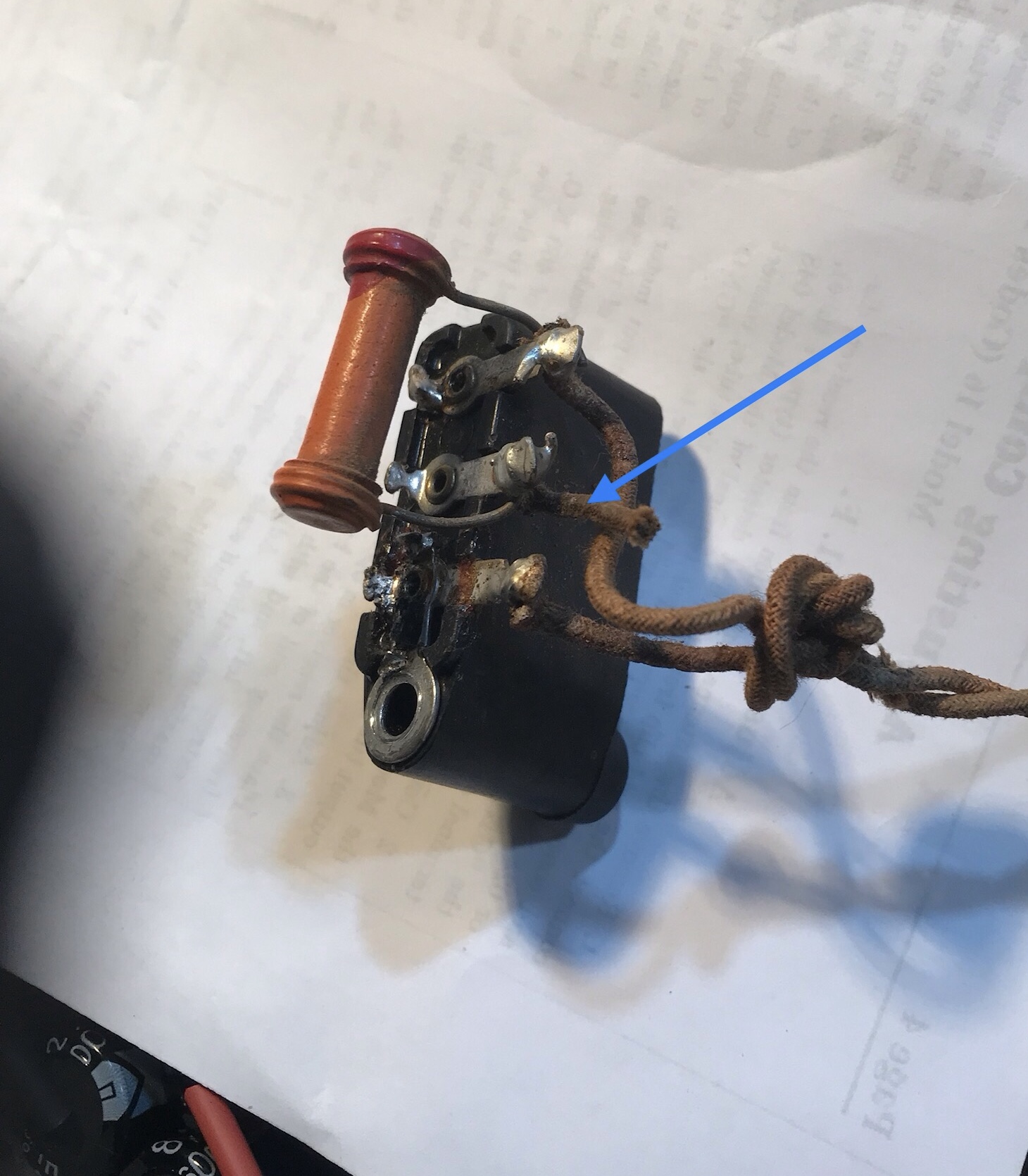

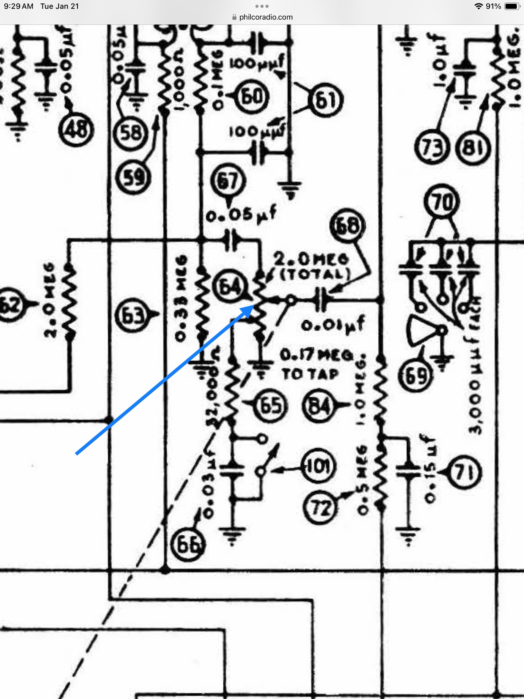

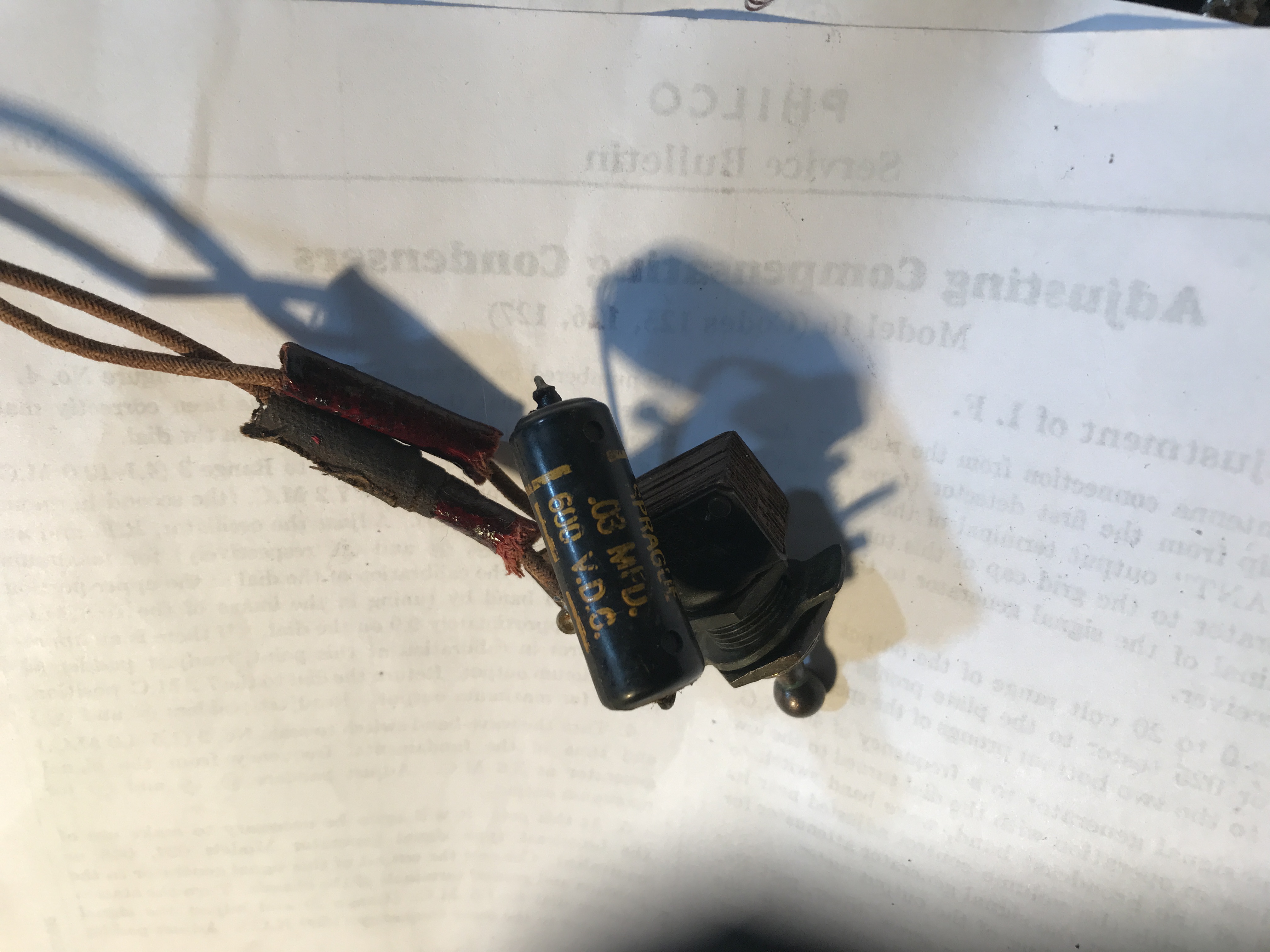

I’ve done several of the bakelite blocks with no issue until I came to #66. It’s a .03 block but it is supposed to be attached to the volume control as the schematic shows. As it stands now it’s attached to nothing but the toggle switch. The one photo shows the existing cap with the cut wire and the other photo shows the other end with a .03 cap attached to the toggle switch. I’m assuming that was to replace the .03 that is still in the bakelite block.
Should I connect a wire from where the cut wire is and run in to bakelite block #68? There is a lug on block #68 that goes to the volume control.
As the power cord was originally wired, the wires were probably connected directly to the bakelite block then one side went to the power switch and the other to the power transformer primary. The other primary lead went to the other side of the power switch.
To do the rewire, you connect power transformer primary across the bakelite block caps, the hot side of the cord to the power switch, then the neutral side of the cord to one transformer primary lead and finally the other transformer primary lead to the unused power switch terminal. If you don't have a polarized plug on the cord then it won't matter which cord wire you start with.
The toggle switch shorts the 0.03 capacitor and changes the tone. You're right about the black beauty replacing the bb capacitor (66) so it's time to discard it. Or you can sell it on eBay for $15. Yes, the cut wire on the bb terminal goes to the tap terminal on the volume control. It will be the terminal by itself away from the other three. You will notice that terminal on the bakelite block is not connected to any component inside the block.
