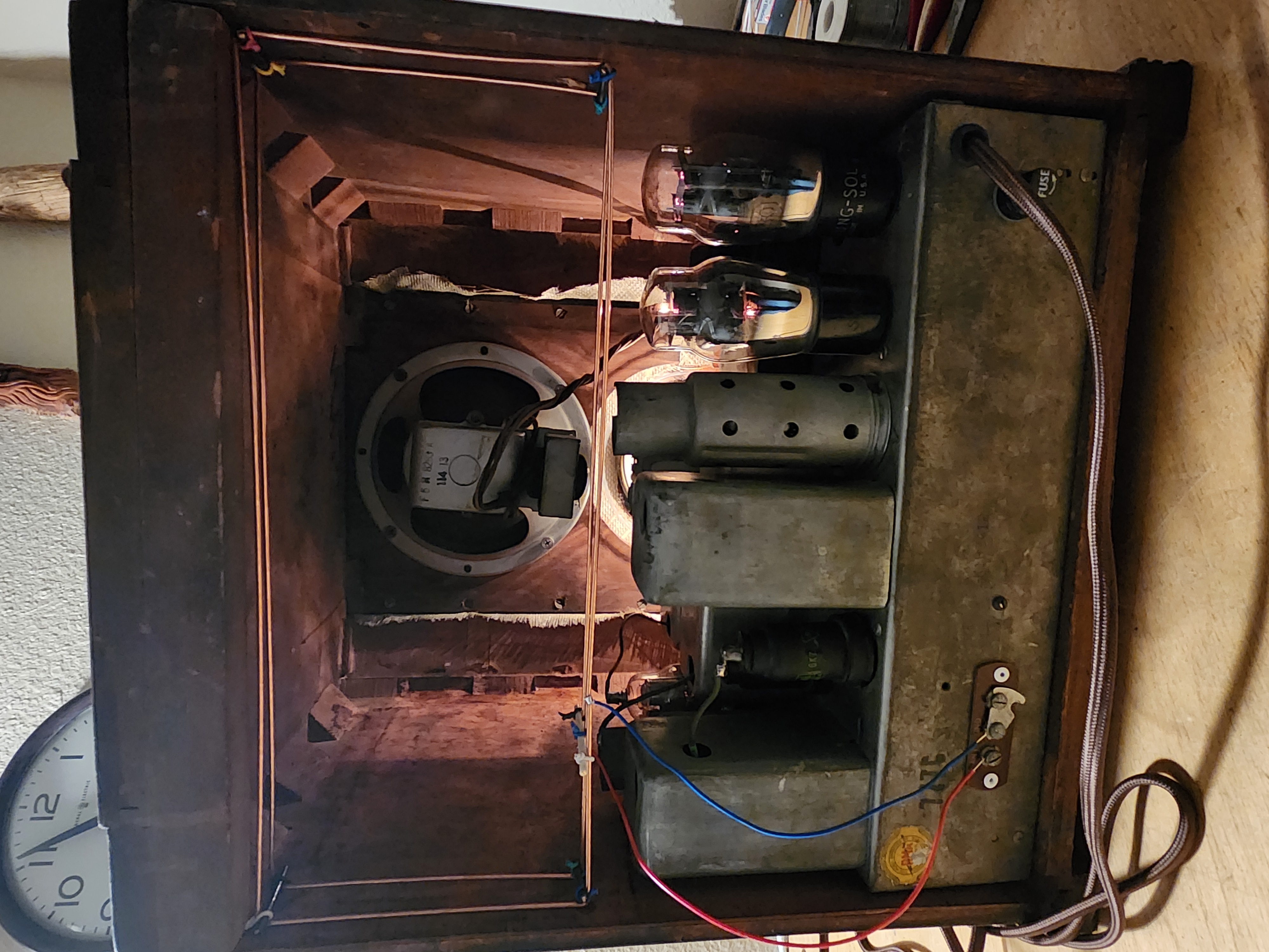

Hi Everyone!  First, I wanted to thank all for your kind comments and encouragement.  The radio is still up and running.  I just had to try a sort of 'proof of concept'.  I made a loop antenna with 2 turns of number 12 copper wire.  I put one end in a vise and the other end in my drill and ran the drill for 20 seconds or so.  That straightened and hardened the wire.  I spaced the turns about 3/4" apart and put the assembly in the back of the radio as shown in the picture below. Ya'll can't give me a hard time about the 'sloppy proof of concept', just say'n!!  I wanted to see if that antenna would attenuate some of the static on the high end of the AM band.  The results: reception doesn't seem to be negatively affected, and the static is greatly attenuated.  I'm able to receive some of the weaker stations.  So, I'm thinking of trying to come up with a more permanent and better looking solution.  I may very well have to tweak the antenna padders, might be worth looking into.

Long wire antennas can bring the static and interference. I have for experiments attached the radio to my home radiator and use the steam pipe system for an antenna, the gain is very strong but it also can amplify interference. Sets with a loop can often be paired with an inductive loop with and null most of the static. Good luck good listening, Paul.
Sloppy proof of concept??? That is rather clean IMHO, great job.

RichG that antenna looks great. The thing I wonder about is impedance matching. That loop is low impedance whereas a long wire is high so I would think you would need some kind of matching transformer for optimal signal strength. It seems to be working for you though, I just might give that a try too!

I'm under the impression that the low impedance is the main reason for the low noise. It's harder for noise to generate an antenna signal into low impedance. I looked at a loop antenna once which had the higher-turns coil as the primary. The radio station signal had to overcome the lower impedance of the secondary but noise was not capable.
I was also concerned about impedance matching, but I'm not quite sure how to go about it. I do want to tweak the antenna padders to see if that makes a difference. But I have to take the chassis out of the cabinet to get at the padders. I'm thinking removing the chassis and loop antenna will change how the loop interacts with the radio.

Well, here is an update of my proof-of-concept loop antenna.  In order to try and match the loop impedance to the radio, I inserted two 1mH chokes in series with the antenna connections.  One choke to the antenna connection and one choke to the ground connection. Impedance matching would be ideal, but this was more of a case of trying to increase the loop impedance. I do notice an increase is signal strength, unfortunately there is also in increase in the static but it's not outrageous.  It is extremely unusual for me to get Fort Collins, Colorado on 10MHz in the daytime.  But WWV comes in quite strong, and it's nice to know the clock on my wall is only 15 seconds fast!!  Just as another 'what if' test, I shorted out the choke that went to ground and I lost WWV immediately.  On the AM band, shorting out the choke to ground reduces the signal strength by quite a bit.  I tried adding a third choke in series with the antenna connection but didn't really notice any major changes.  I'm thinking the two 1mH chokes may be the best I can do for the time being. I think this is a case of increasing the loop impedance by a fixed amount being okay on one band but not the other bands.  I may play around with adding a capacitor to the mix to see if that makes a difference.  If anyone has suggestions, I'd like to hear them.  As you can probably guess, my antenna skills are a bit lacking!
