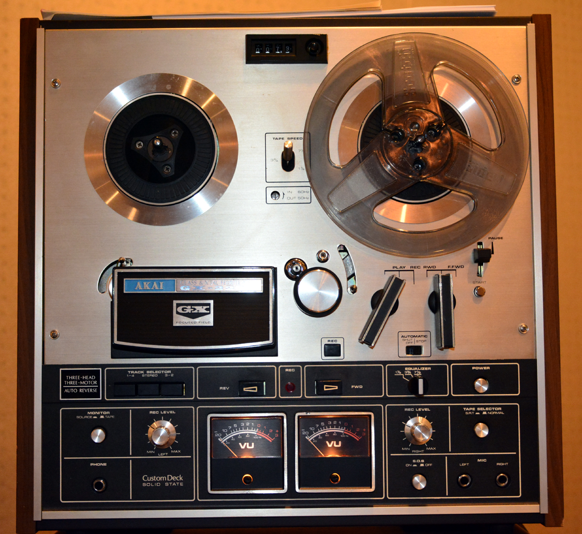

After a few months.... I have the Akai GX220D Finished and calibrated with the Magnetic Reference Laboratory tape. I'm actually quite impressed (of course, as I said before, my ears aren't what they used to be.) This is a 1 7/8, 3 1/2 and 7.5 ips machine with auto reverse in both directions, with a maximum 7" reel capacity, and 3 motors. All capacitors have been replaced and the speed calibrated. Akai used a pot metal pully on the motor which had totally deteriorated. I had to make a new one out of brass on the lathe. Getting the diameters correct for the speeds required a bit of trial and error. The heads on these machines are "glass and xtal" (an Akai innovation) and were not worn al all. No lapping necessary.
I have the machine calibrated for high output tape at 3db over the original Ampex standard. I find, though, that with the higher magnetization of the tape, track cross talk is a bit more than I like. I may re-calibrate to 0db. All in all, frequency response is great and music sounds great, especially at 7.5 ips. I have recorded a few tapes of music with auto reverse in both directions. I will just let them play over and over while broadcasting on WROB (my local FM station for just me) while working in my workshop. Fun!

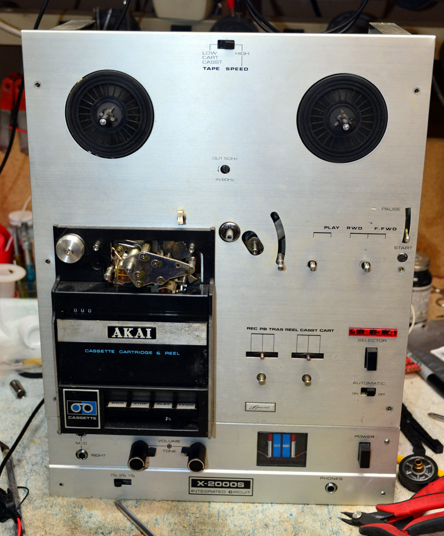

So, while I'm here and posting, here is a curbside find. Another Akai. this one was produced in the 70's while R2R, 8 track and the "new" cassette format were all in production. This machine has the 7" R2R, a cassette player and an 8 track player! The original owner bought it from the PX while in Viet Nam. When he last tried it, it didn't work, so he cut the cord off and left it. After passing, his widow decided to get rid of it and set it by the road for the trash man. I saw it, the widow came out and told me the story, and was pleased to see that someone wanted it to restore it to working condition. The picture that follows is of it partially disassembled. I forgot to take pics before.
