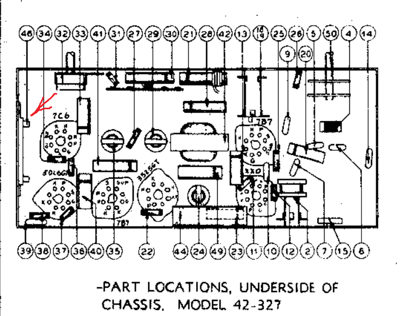

Is the 80 ohm resistor in this set? according to the schematic, it should not be.

So. Direct question: you do not see a Candohm resistor on the left internal side of the chassis (denpted with red arrow below)? Nor do you see the signs of it being there before?
Also: Could you summarize teh state of the radios? I am confused a bit: do you have now power to teh heaters or have you wired them separately to check the tubes but it is not like it is supposed to be wired?

Hi morph, I do not see any sign of a resistor that would be in the heater circuit. There are holes in the chassis where your pointer is but not even a scratch showing it might have been removed. I followed the tube lineup in the heater diagram starting with 35Z3 to 50L6 and checked each combination of pin connections to map and verify the circuit. From pin 1 to 7 on 35z to 50L no resistor and other combinations between them until I mapped the circuit through to pin 8 of XXD to B- then I added a wire from pin 8 on XXD where it shows B- to the circuit at the volume control at the 4.7meg resistor. I wired the lamp as suggested in the thread and now I have voltage to the tube filaments that is a little lower that it should be. Then a quick check of B- to B+ on both sides of the coil showed 130v instead of 108v and 88v instead if 83v. I quickly checked the AC across each heater to find all of them read a little lower than I expected. I turned it off so I can go back to tracing the circuits and replacing any suspect parts and crumbling wires before powering it again. At one point the B+ was too low and that’s when I added the B- The only tubes that get hot are the rect and output the rest just a little warm or cold. So my plan is to trace and replace all questionable wires and parts before going forward. The cans all measure good the speaker measures within tolerance 240 of 250 and the field coil is at 470 of 500. Hope this helps answer your question.
Posts: 5,652
No there isn't an 80 Ohm candohm resistor in the versions with the 35Z3s, which I don't understand since it is in series with the heater string in the code 121 version. I thought that maybe it was in parallel with part of the heater for the 35Z5, it was quite common to do that in sets with the 6.3 volt pilot lamps.I would guess that the majority of resistors were either 1/4 to 1/2 Watt, and the larger ones being 1 or 2 Watts.

Follow Morzh's advice, visually trace the wiring and draw a schematic of what you see. Remember, for all tubes except the 50L6, the heater connections are pins 1 and 8. This includes the 35Z3. For the 50L6, the heaters are on pins 2 and 7. I verified this for each tube in your set against the RCA receiving tube manual, Rev RC13, published 1940 (or so)
The pictorial of the underside chassis layout is for the Code 121 set with the 35Z5 rectifier. If I am right, sets with the 35Z3 will not have the Candohm 80 Ohm resistor.
Are you using the dimbulb tester when you are making the voltage measurements for the heaters? If so, the heater voltages will be low because there will be a drop across the dim bulb.
The way the Code 122 set is supposed to be wired, there is no resistor in the heater string, therefore, there should be 35V across the 35Z3 heater, 50V across the 50L6 12V across the XXD and 6V across the rest of the tubes for a designed line input of 115V. You should actually see a little higher as most power is about 120V these days.
