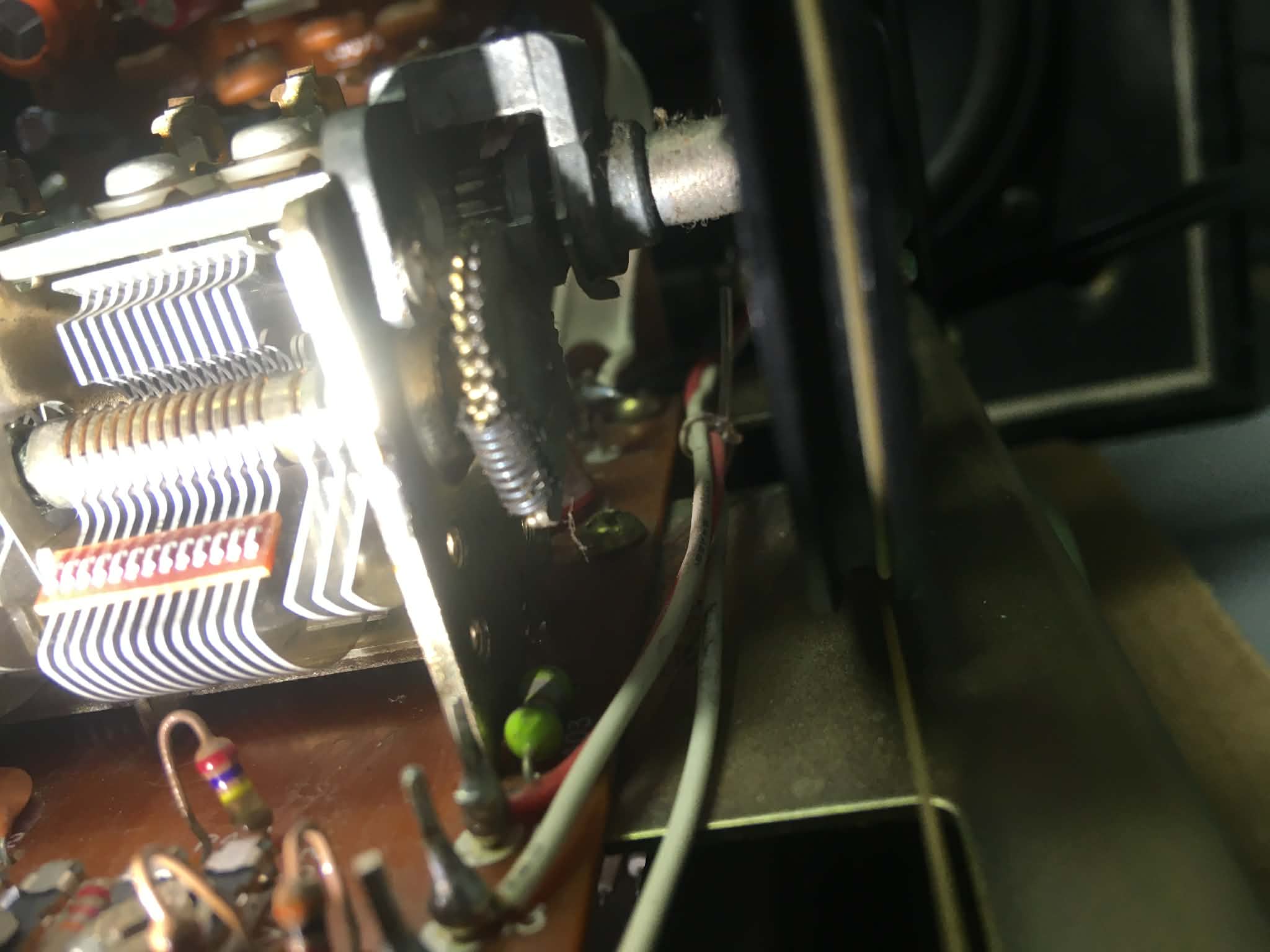

Here’s another issue to address before giving it back. In the photo below, you can see the large tuning pulley on the input of the variable tuning capacitor, which connects to a smaller drive gear that operates the tuning. The problem is that the small gear tends to come off the end of the shaft if you pull on it.
You mean, there is no set screw or...what holds it?
Wonder if it was supposed to be a press fit. If so, Loc-Tite (or other appropriate adhesive) the gear to the shaft.

Hello mr Fixxr,
I was thinking it was original press fit !!
Sounds about right to amount .
Richard;
Do you mean the pinion gear on the end of the tuning shaft, the small one that the large pair, with the spring, meshes into? Is it plastic or metal? It may be a pain to remove though.
Hello Arran,
Yes, that exactly what I was talking about I just forgot the gears name this last few days have been tough because sore tooth .

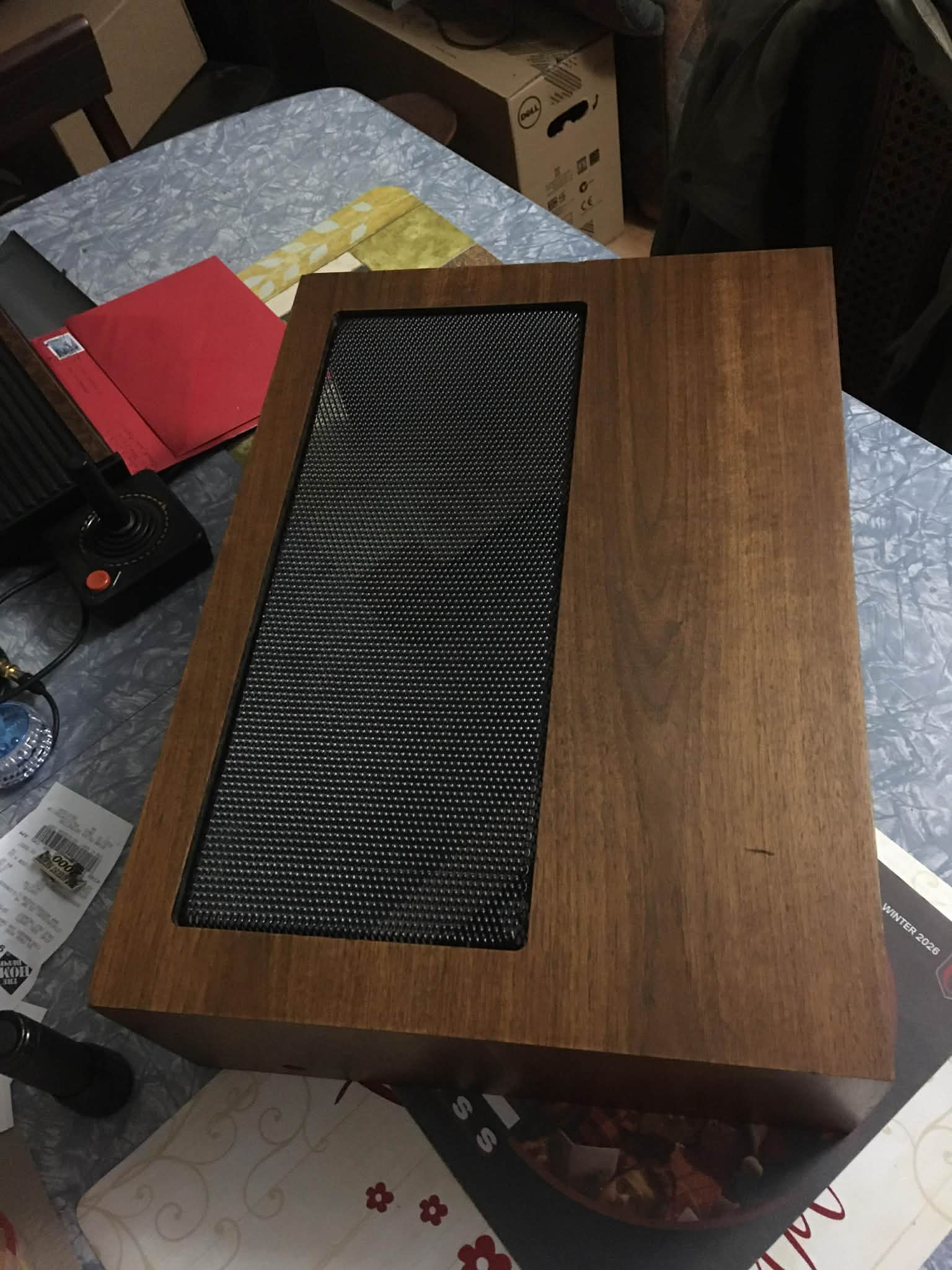

I measured the rail voltage under load today, and with strong bass, it drops to around 45 volts. While the set was playing, I also cleaned the wooden cover, removed the grille for a wash, and finished it off with a coat of Howard's Bee's Wax polish.
