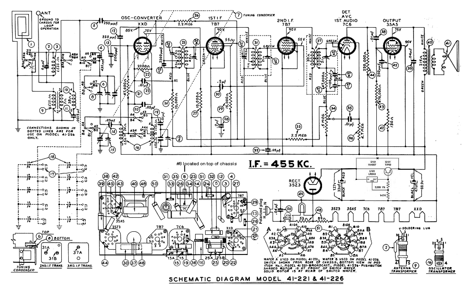

Yes I did. I always keep Artic Silver 5 handy for things like this and computer projects. It's really a must, especially with the mica insulators. Here's the modified 42-221schematic. It also has a couple of labling errors fixed. They mixed up ID numbers on  the brocast and oscillator coils and also two components.
