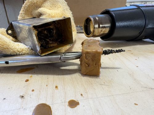

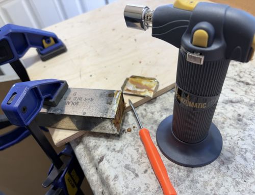

Hello Bob,

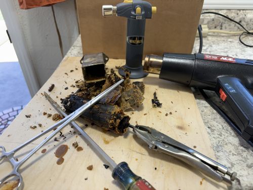

Nice job on your electrolytic can stuffing.

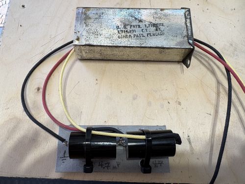

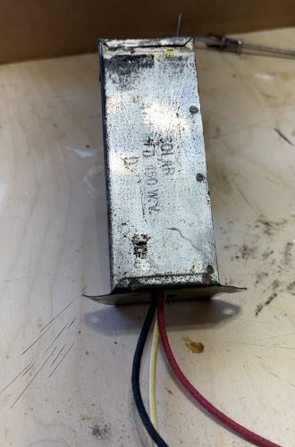

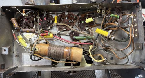

I have the recap finished. The electrolytic cap box went back in with no problems and the removal of those old tacked in caps opens up the underside. I only recapped. The two 500kOhm resisters are about double what they should be but I left them in until my order comes with a 2 watt 500k to replace the big one. All the others are close enough.
I put the tubes back in, including the 2A5 that tested "Bad" (but only just) and powered it back up. It does indeed still play. I only have a 10 foot antenna wire on it but it still picked up one local AM station. The station from my SSTRAN at 1130 comes in very clear as you would expect. I will swap out the two bad resistors and put a new 2A5 in when they arrive. Still have some chassis clean up to do as well but its always nice when they play first time!

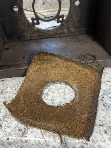

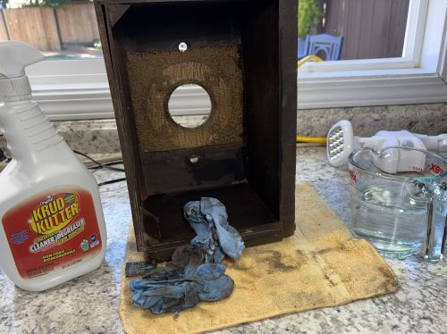

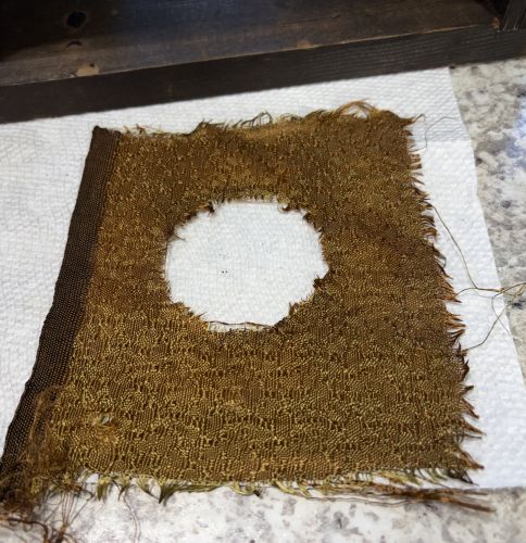

 That's good guys! Started cleaning up the cabinet so I could work on it. A diluted solution of Krud Kutter in water to get the major grime off, particularly on the inside of the cabinet.
The grill cloth came off with a gentle warming and then pulled it off the cabinet slowly. It did pretty well and then a wash with warm water and some Dawn with gently swishing by hand and it seemed to clean up pretty well. I'm not sure if I'll use it or put in a new piece. Its pretty fragile even though it doesn't look bad. I also washed the Crosley cloth I had on reserve but it disintegrated on me. I'm 1 for 3 in washing grill cloths successfully. I think in most cases the fabric is just rotted with time.

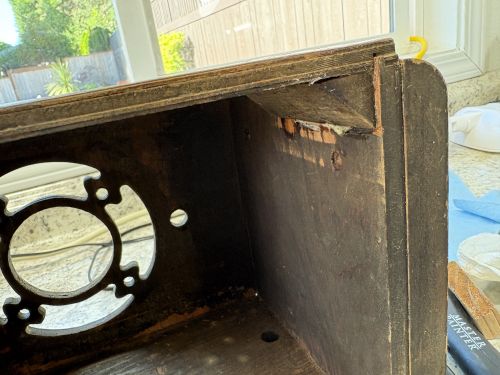

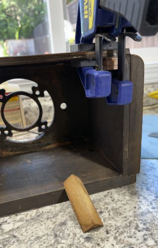

Next up was fixing the delaminated wood in the upper right corner facing the back. I got the glue block off with some heating via heat gun and a putty knife. It was not too firmly attached. Scrapped off all the old glue from the cabinet and block then took a two step approach to glue up. First the delaminated top wood was glued and clamped and after it dried the glue block went in.
Next I'll start taking off the old veneer and stripping off the old black finish on the sides and bottom. I think the veneer has had some problems in the past as the top has 6 small brads nailed in to hold it down that will have to come out. I can't imagine they did that at the factory.
