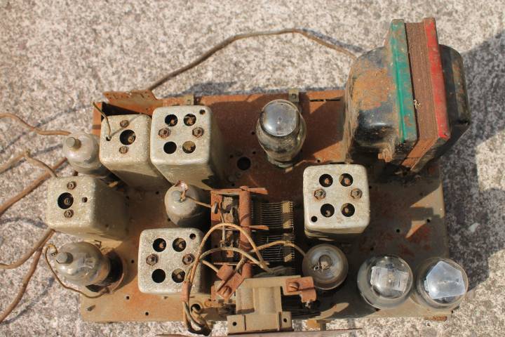

Hi Again Folks.
I have just acquired another Philco 98.
This time it is a Series1.
It had been in the same family here since new.

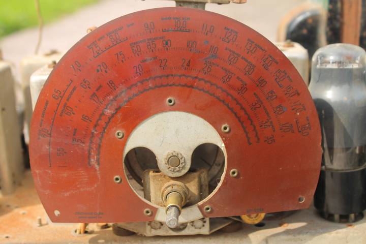

I attach photos of top and dial.
Rider pages 8-90. 8-91. 8-92.

This series 1 has a three gang wave band condenser.
The shadow meter is missing presumably removed at some repair.

Don't know if I can recover this one yet. It has been got at by the salt environment here. Not good for the coils etc.
The Cabinet is also full of lodgers. The speaker is kaput, no shadow meter. I will know more when I ohm out the rest.
