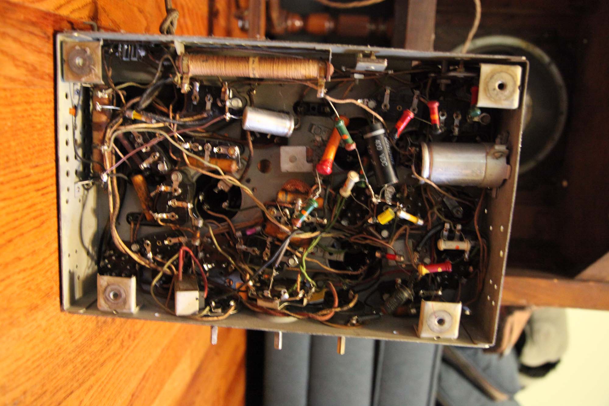

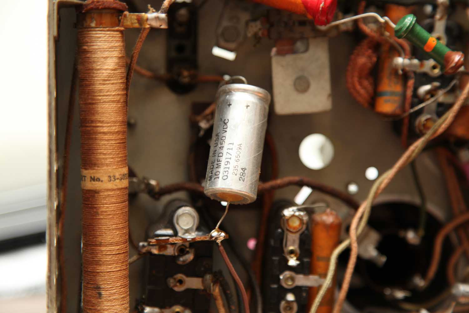

This is the bottom view. Now this is a good one: this cap, which leaked from both ends, instead of being removed, or at least isolated by cutting wires, was left untouched and fully connected... And this cap simply soldered in parallel to it in a convenient place. Some weekend warriors..... Lesson to everyone, especially those who just start restoring or simply buy restored radios from someone: DO NOT rely on a previous guy knowing what he was doing and actually understanding the principles EVEN if he somehow "fixed" the radio and made it play. Check, check, and then check again. Only trust yourself. PS> You can also trust Ron, and to some degree the rest of us here
11-03-2012, 10:22 PM
It looks like a previous repairman paralleled some of the Bakelite block capacitors as well, hopefully they disconnected one end of each before doing that.

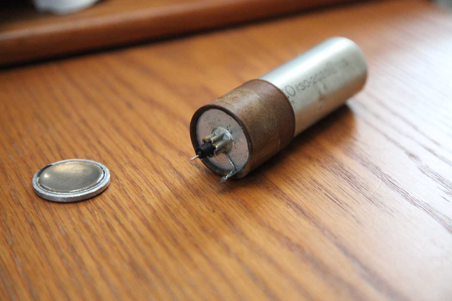

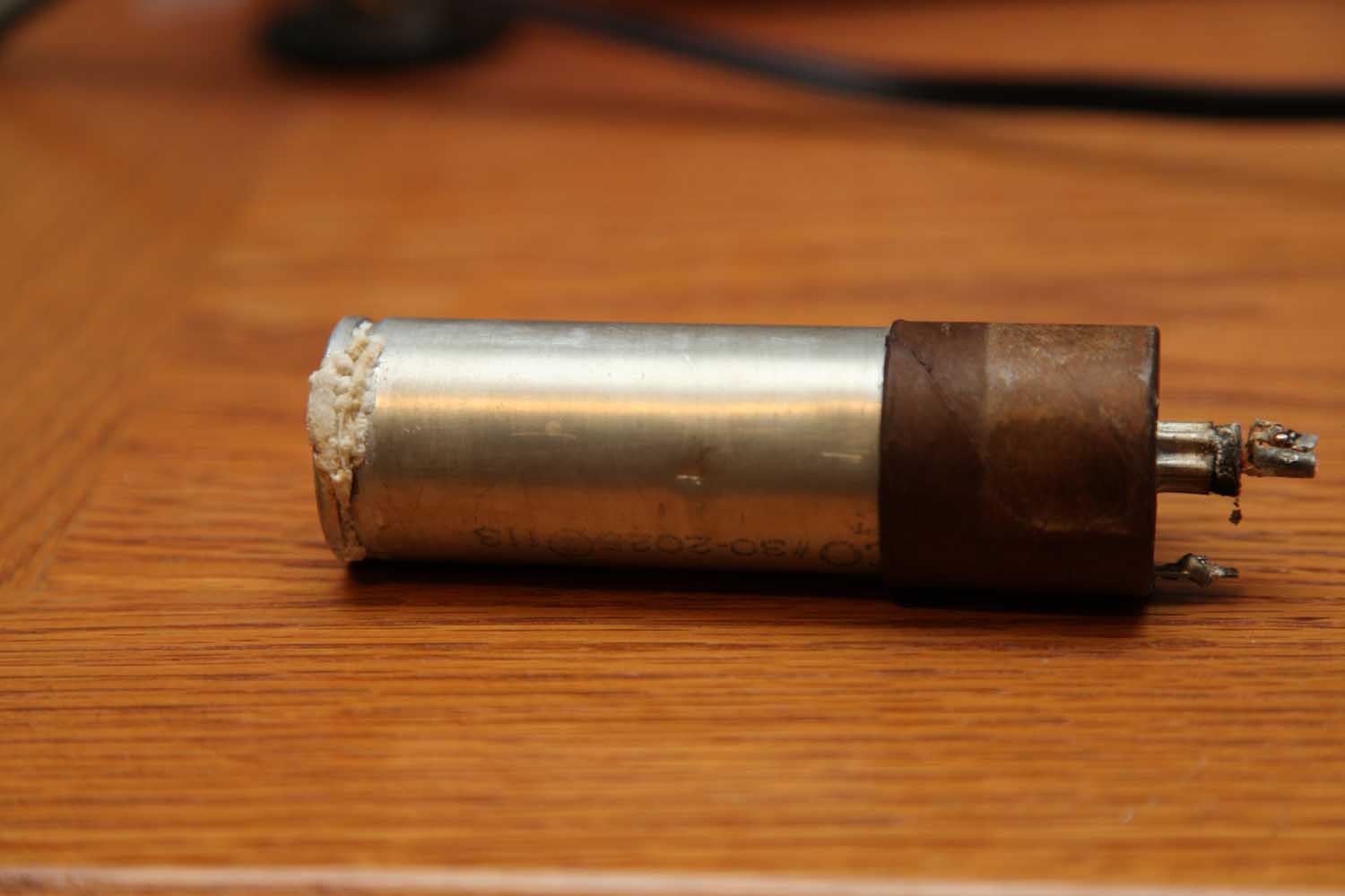

Here goes the first cap restoration.

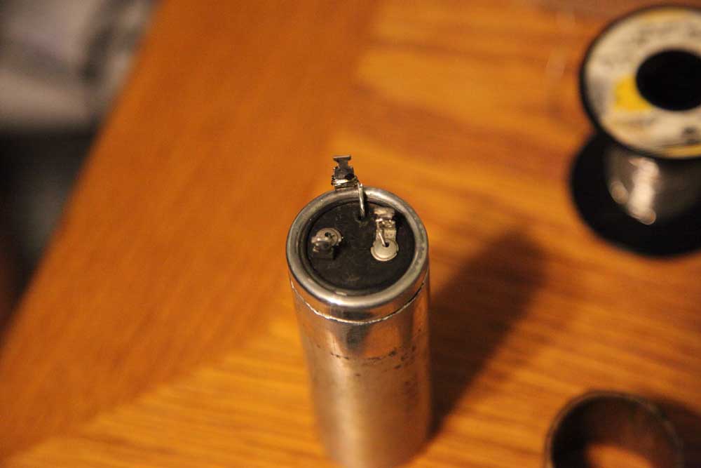

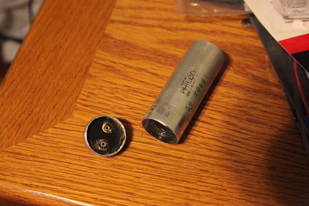

The "Rabied" cap. It was connected and powered whenever the radio played. The newer cap was installed simply in parallel. Considering that my meter still showed 6uF and the new cap is 10uF, summarily they created a 16uF (and dangerously unreliable) capacitor which is twice what's required (8uF). Took a hacksaw and simply took off the cap. Highly recommend for this type caps. Some liquid escaped. I washed the whole thing with dish detergent, and then heated up with a Milwaukee gun and left to dry. Took the newer cap that used to be in parallel, made sure it measures as required, and put it inside. It is a larger type cap but still a good one, 10uF 450V. Since the body is minus and then insulated from chassis, the negative wire from the inside cap can be bare. The central positive pin is covered with two heat-shrinks, thinner and then thicker, then wrapped in the insulating tape, to create a diameter that will go in where the rubber gasket was before. This will create enough dielectric strength for 400V and quite more. Attached the cap. The cap sticks well even with no adhesive, this is why I like this method. And the seam cannot be seen unless specifically looked for. Same cap from the front.

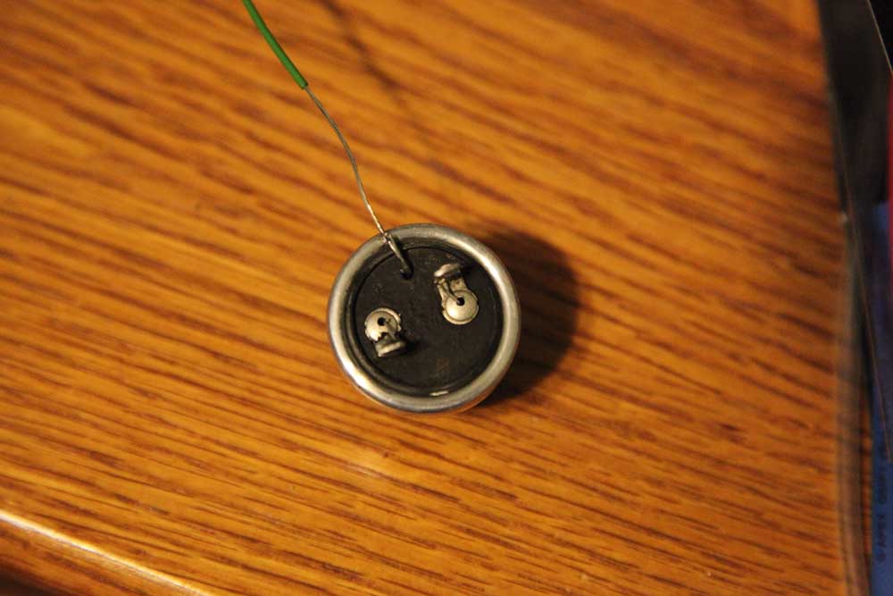

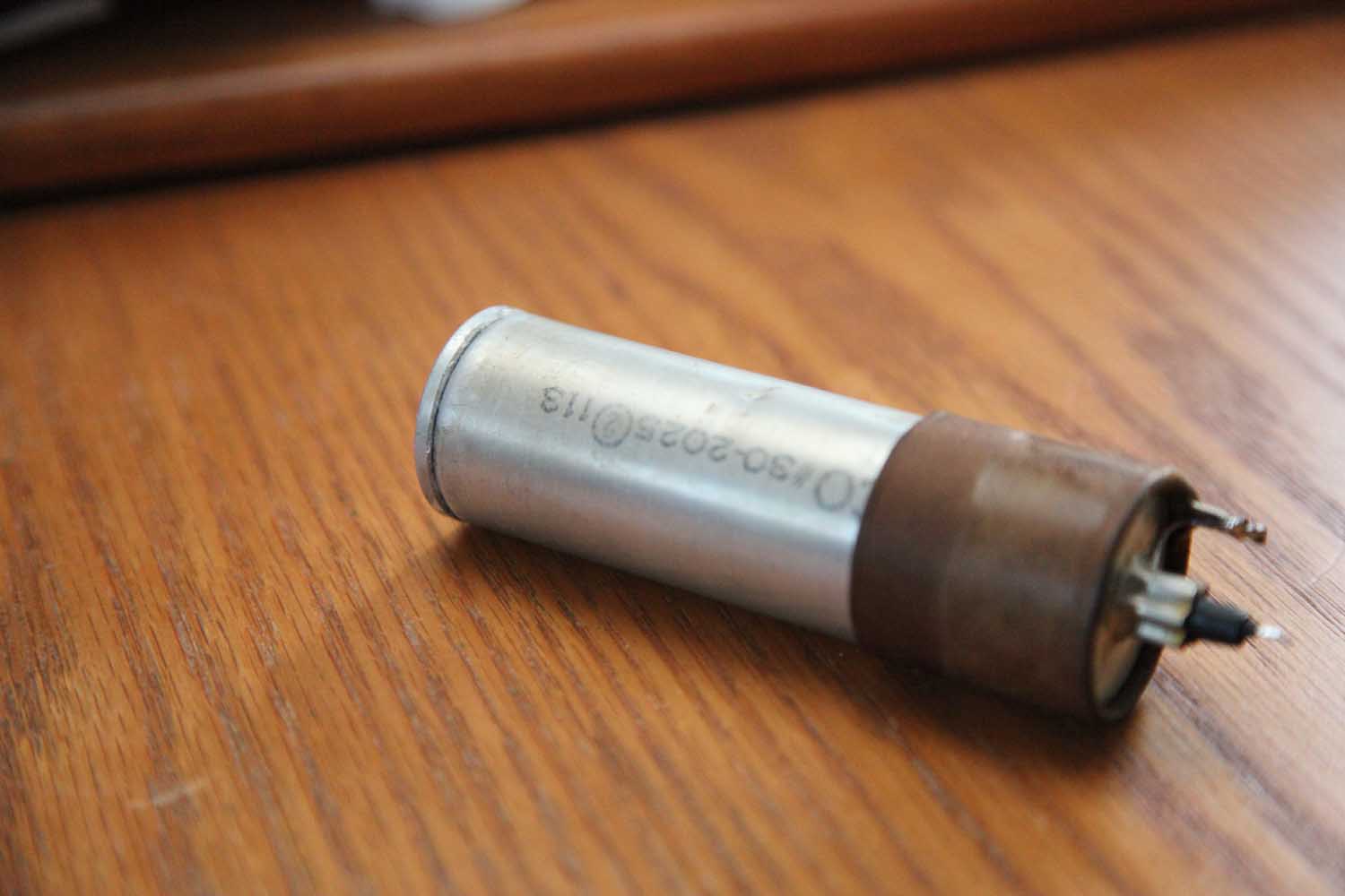

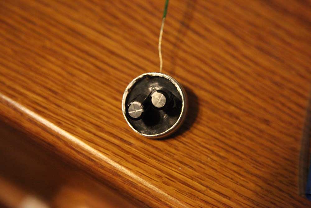

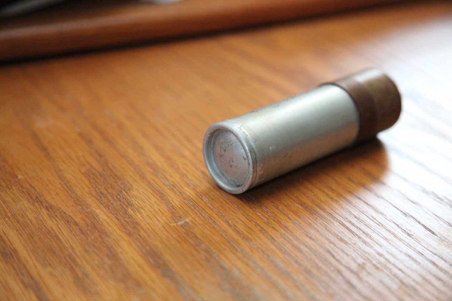

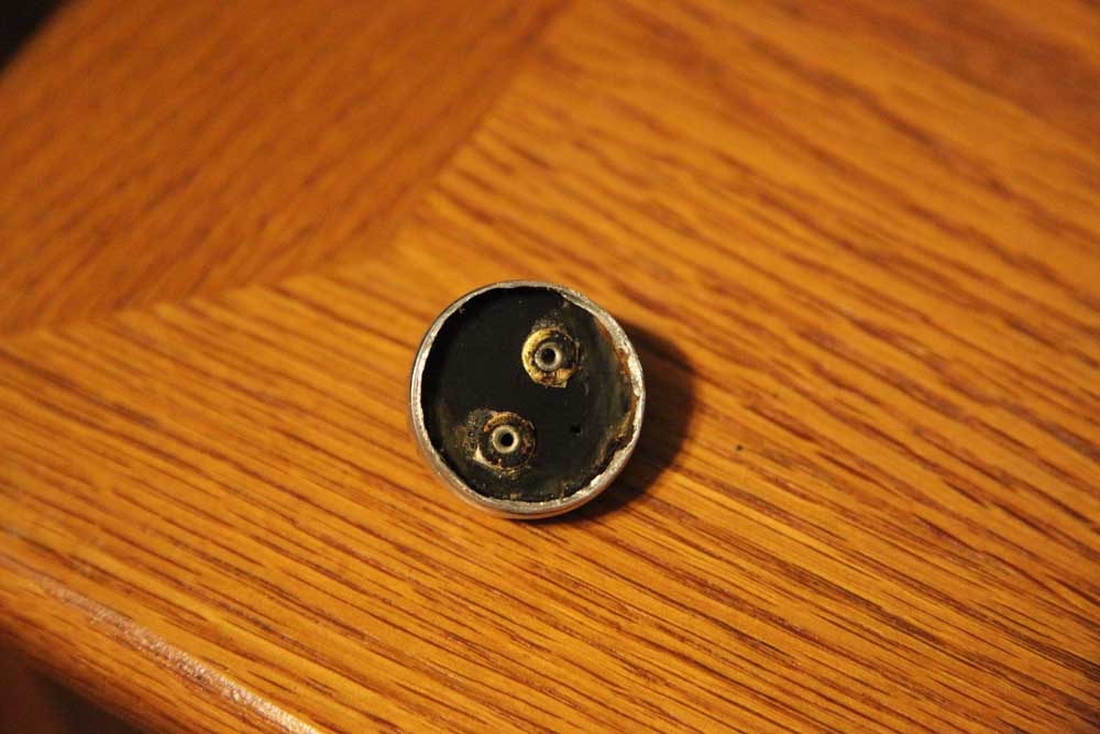

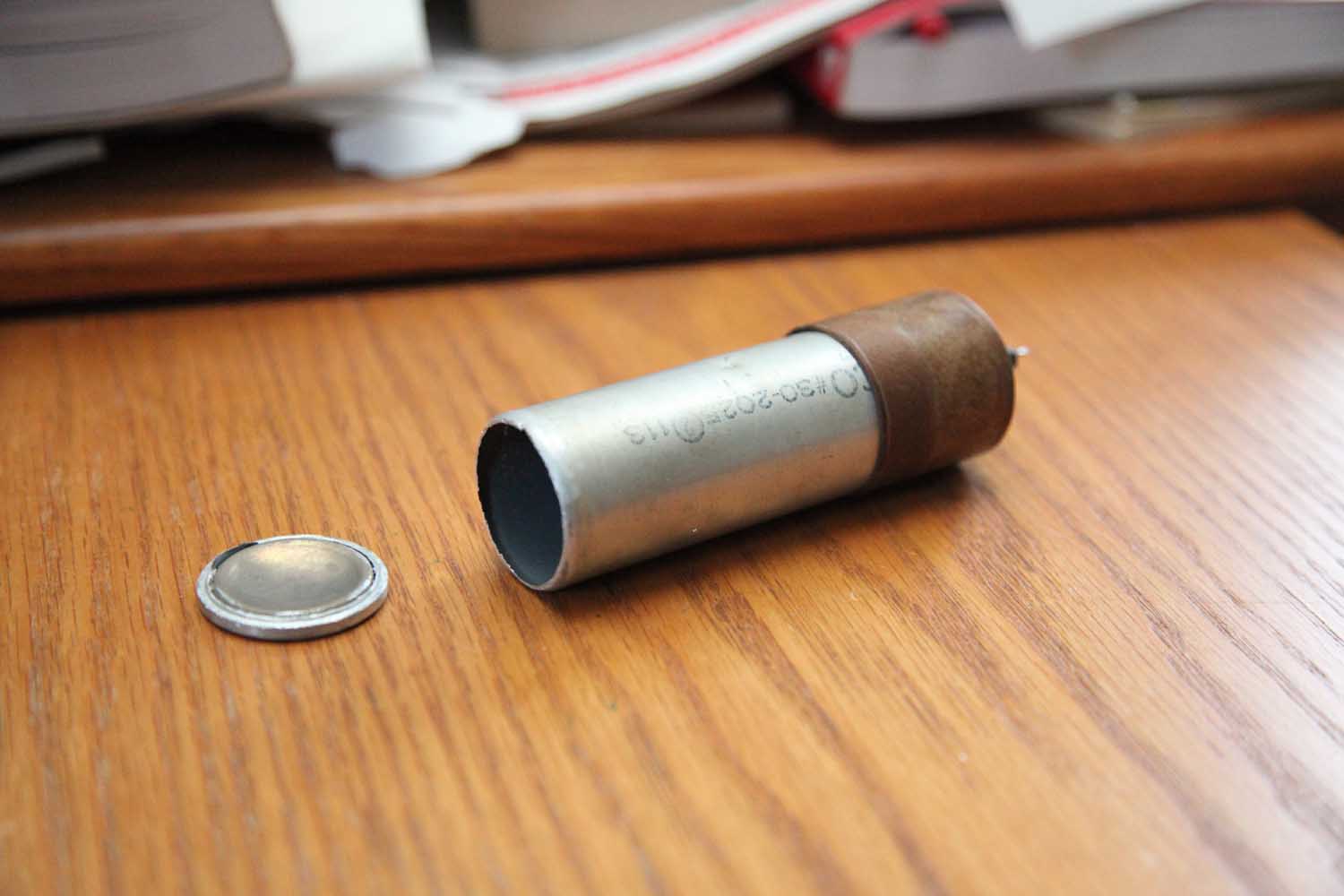

These caps, with a groove at the bottom, a the easiest to stuff.
This one is a dual one with both minuses connected to the aluminum can. First cut off along the groove, closer to the top part, so the bottom has the narrower part left. The top part should have the remnants of the bend removed, with deburring tool or exacto knife, remaining a perfect cylinder. After cleaning and gutting, drill holes in bot rivets and an extra one. Insert the stuffing, threading both pluses through the holes in the rivets, and the minuses connected together and then soldered to a common wire - through the extra hole. This is how it looks from the other side. After that, upon putting some epoxy, glue or JB Weld upon the internal walls of the top part close to the edges, insert the bottom part in it. It will go in as the narrow part still remains. Why putting epoxy on the inside of the top and not outside of the bottom? Simple. The top would start pushing the epoxy off of the bottom part, so you have a mess to clean off then. On the other hand, if epoxy is inside, it is pushed inside and all looks clean, nothing at all to wipe off.
