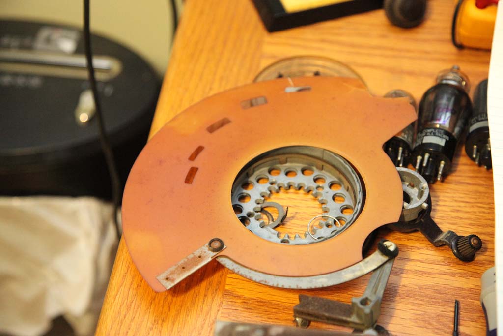

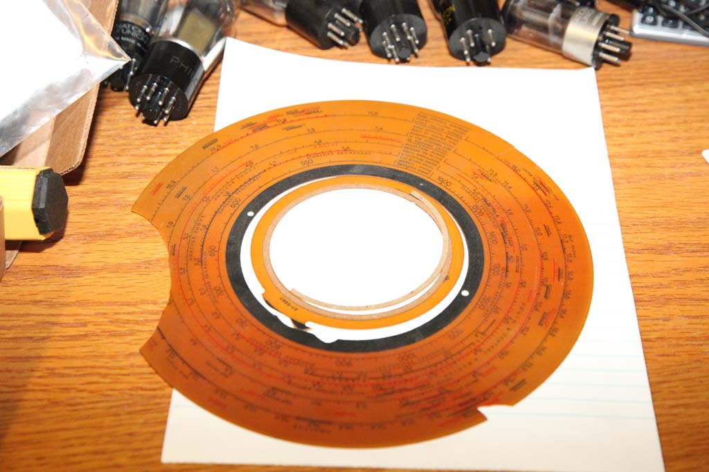

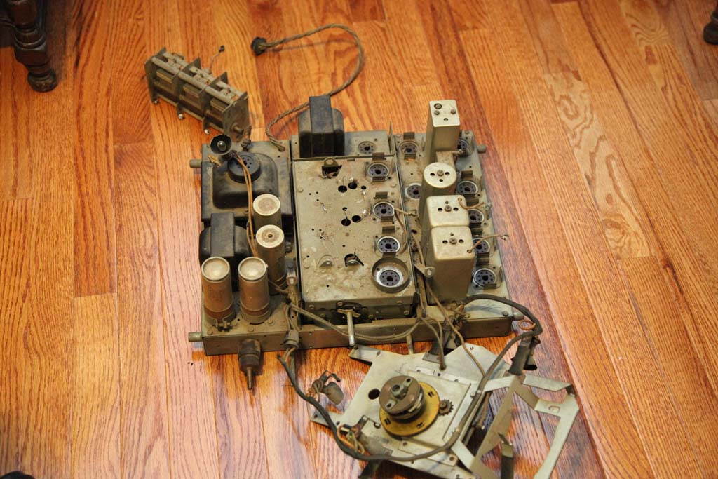

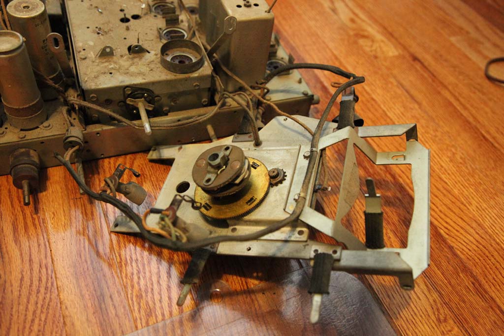

OK, tool apart the tuning mechanismus, boy that's a real....clockwork.

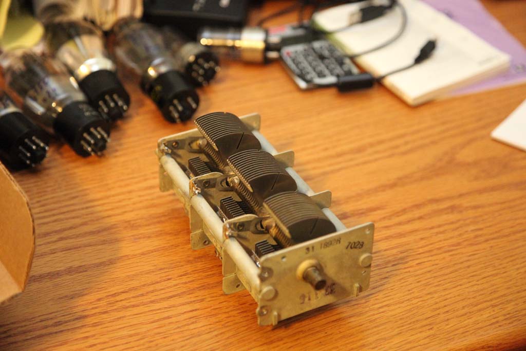

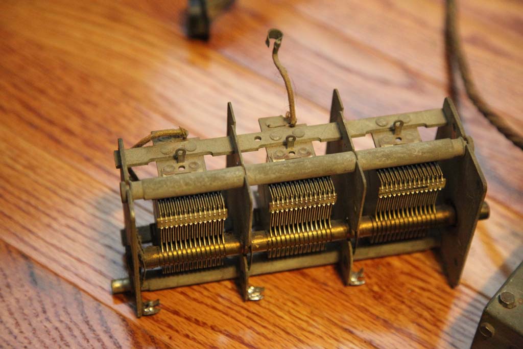

I did it because I want the cap out and I want to throw it in my dishwasher.

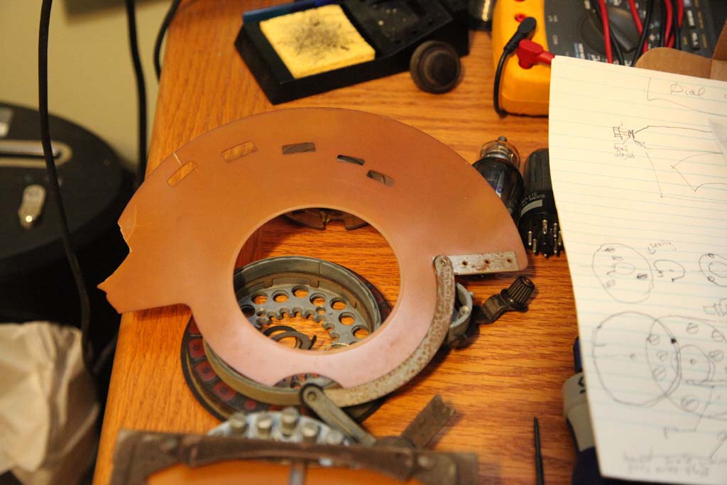

The dial is not just cracked, the attachment of the dis to the hub is broken so I am not even sure I can restore it....
The thing is dirty as sin!
That capacitor is indeed solder well.
Now I could use some instructions while disassembling and assembling it back.
Does anyone know of any drawing I could use?
I was making a drawing as I was going along with taking it apart but I am sure there will be some questions when I will start putting it back together.

Mark Oppat makes some beautiful repros of these dials. I recently bought one of his for my 38-690.
Yes, Brenda, thanks and I do think with damage this extensive I will have to go to a repro.
After all this will be a major effort to fix this thing, so might as well make it just a tad easier on myself.

In the meantime, here's the tuning cap I just put through my dishwasher.
Just add some lithium grease into the bearings.
