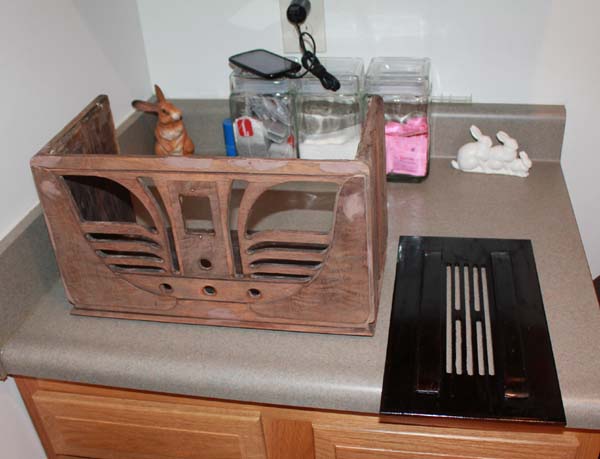

A friend and I made that. Actually, he did the making... I used photoshop and a picture of an original top to determine the sizes and spacing, then I drew a lifesized replica on a piece of paper. My friend used a router and a bandsaw to create the parts for me. I believe it's as close to a duplicate of an original as possible.
The top piece was originally tongue and groove, and he could've replicated that too. Problem is, the original tongue is broken off inside the groove on my cabinet. We tried chiseling it out, and we tried melting the glue but we were afraid of doing more damage to the cabinet. So the new top will be braced with some triangle wood stock. It should work out fine. I'll be working on it tomorrow.

On the other side, someone had done a very rough job at attempting to chisel out the tongue. They started in the center and worked out about 3 inches in each direction. The edge was uneven and looked like a screwdriver had been used as a chisel. As a result, about six inches of the top of the groove was missing (see bottom photo on first page).
My friend used a sharp chisel to remove the rest of the top edge of the groove and smoothed out the previous work. This resulted in us having to add 1/4" to the width of the new top... and move the slots off center accordingly. But, the good news is that the new top can be square, there is no "notch" on the corner (again, as seen in bottom photo).

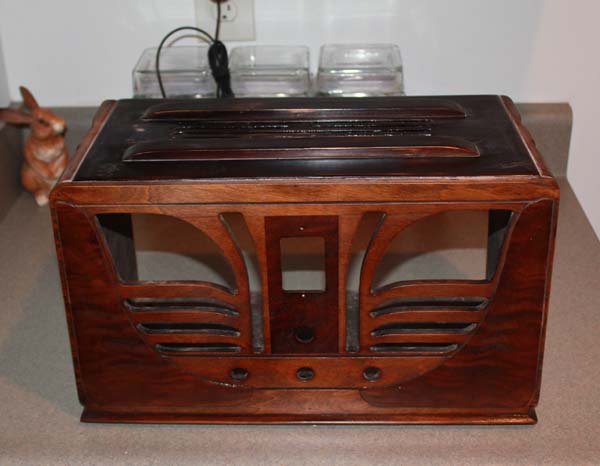

I finally made a little progress today. Here is the radio with veneer repairs complete and timbermate wood filler added to the needed areas. Surprisingly, it didn't need much of either.

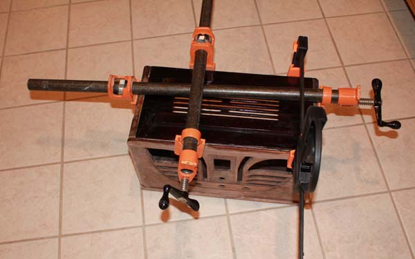

Time to take a deep breath and jump in. Top is glued and clamped into place. I'm sure you've noticed that it's been sprayed with lacquer. That was for my own piece of mind... it'll be redone when the cabinet is finished. Still got a ways to go before then..

I held my breath and removed the clamps this morning. All is fine. Last night I took Arran's advice and added some wood blocks under the inside edges. I'm thinking of adding some small wood screws for extra strength. The downside of screws is that, because of the confined area in the cabinet, it will be very difficult to drill straight holes. I could use self tapping wood screws, but they can cause the wood to split. The cabinet seems very solid as it is, and the clamps only had to pull one side in about 1/4".. sooooo.. I dunno.. we will see..

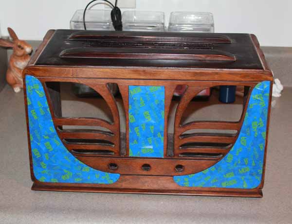

All taped up and ready for the second color. I don't know if this is how Philco did it. If so, I hope the guy who had to tape these everyday of his life was well compensated. I usually use Frog Tape, but 3M Scotch's has some new fangled super sticky edge tape.. and I decided to give it a whirl..hope it works out!

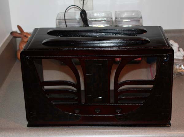

A couple of coats of Extra Dark Walnut on the entire cabinet.
I searched every photo and every post about 45's that I could find... some people do these 45's in ebony or black, but from what I can tell, extra dark walnut is the original color. So that's what I went with.. if it's wrong? .. then it's wrong.. I like it and that's what matters. Extra Dark Walnut it is..

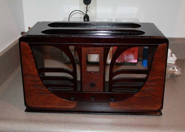

Voila! .. Tape removed. Looks good to me. Next up, pre-cat clear, a decal, more clear, then the yellow/gold stripes. Hope it looks good to you guys. My camera doesn't take the greatest photos.
