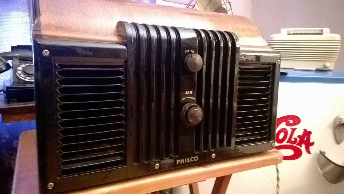

looking good

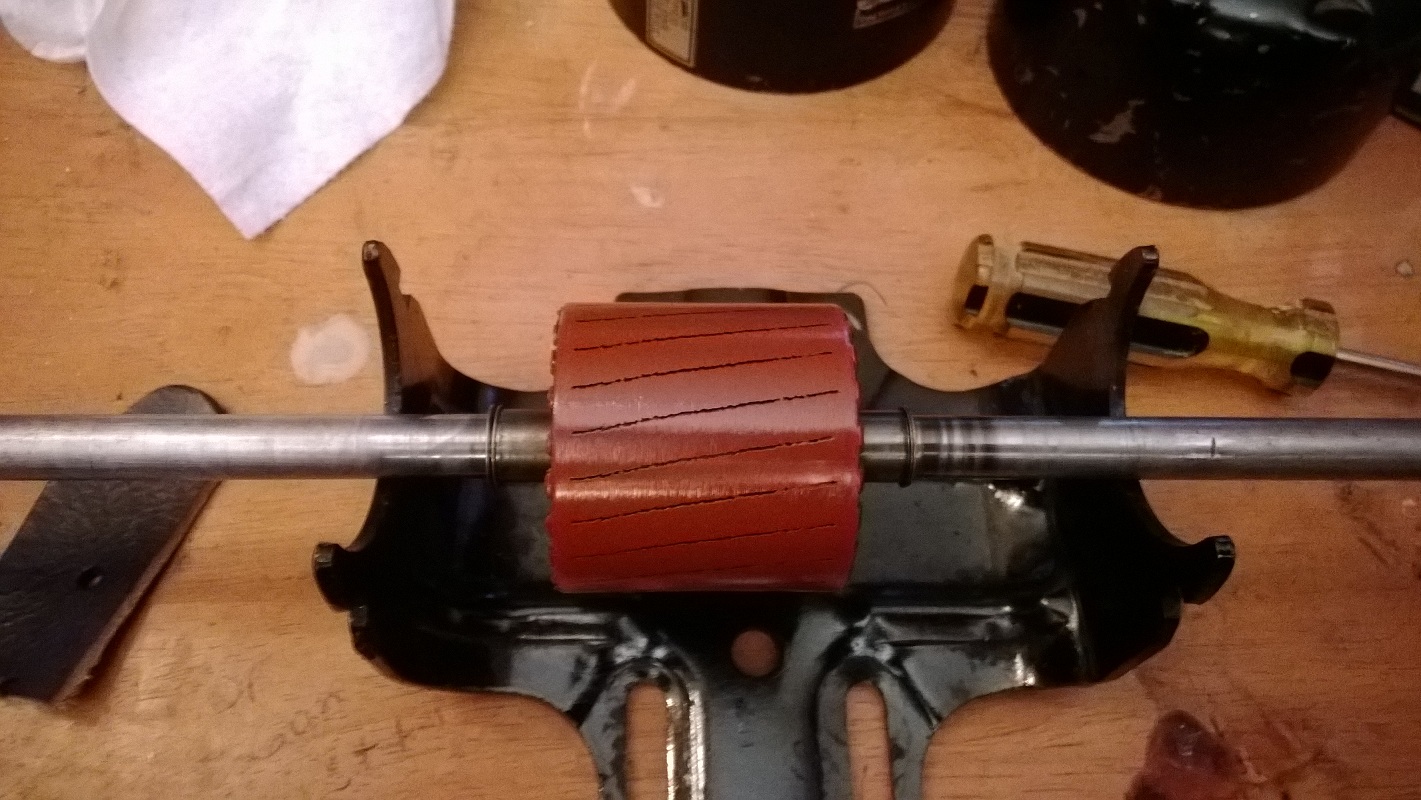

red lacquer finish .

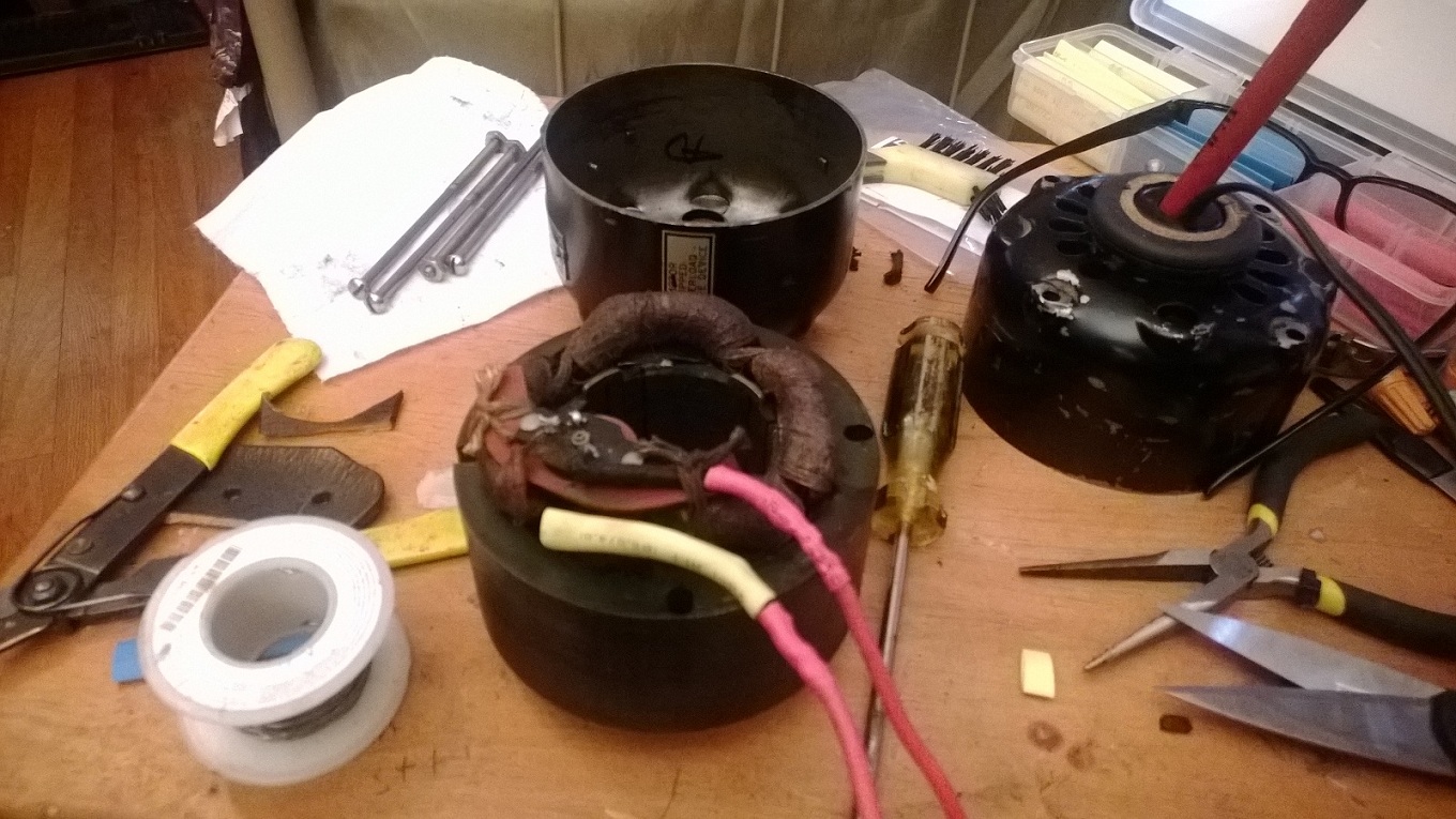

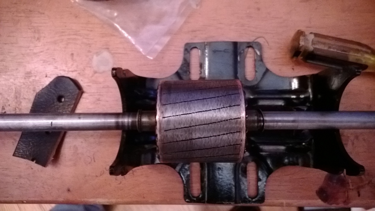

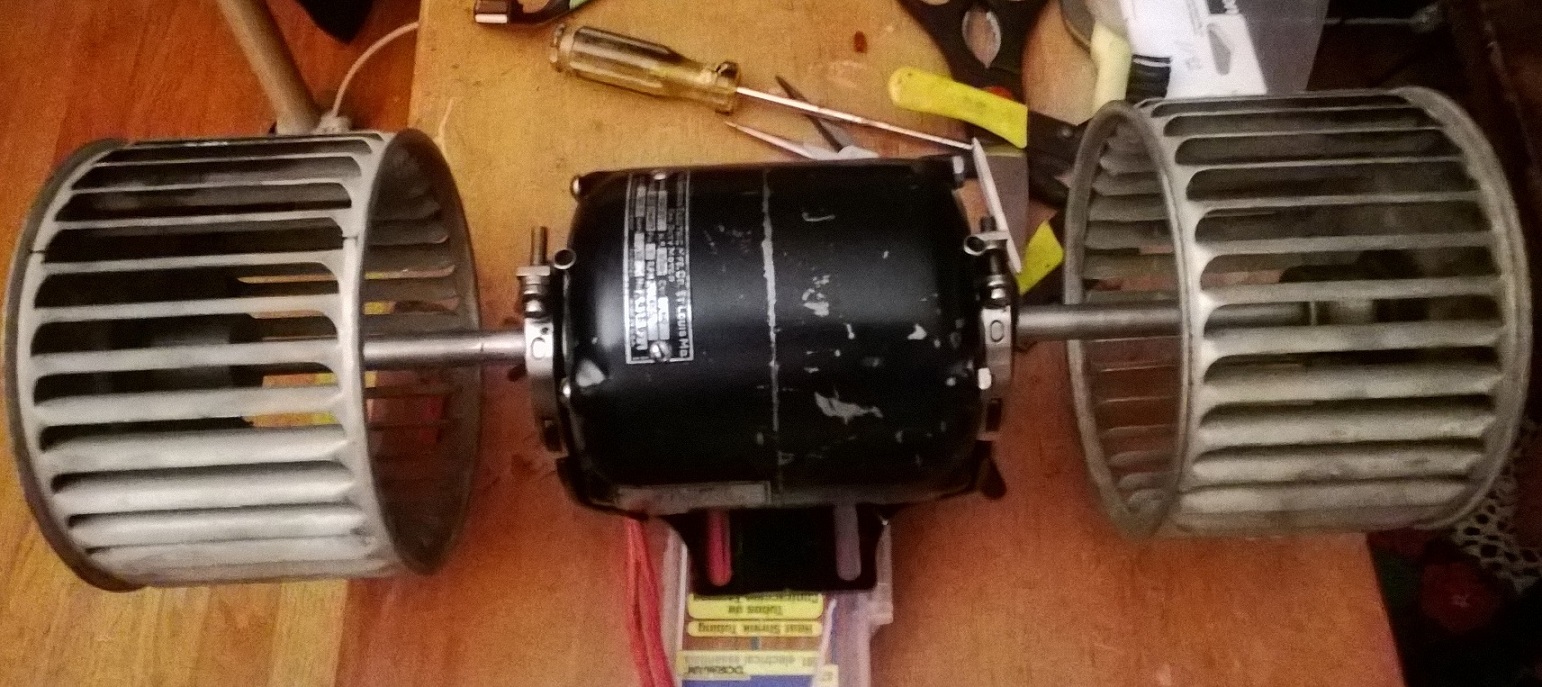

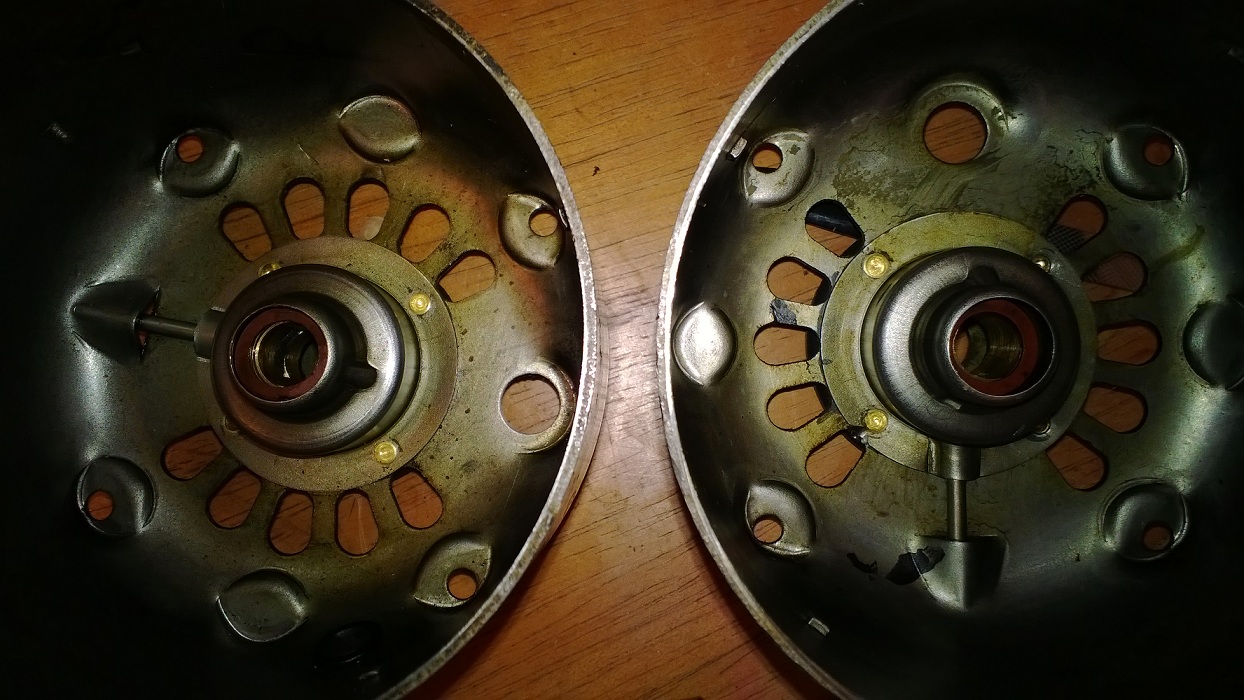

new bushings and felt oilers and rivets .

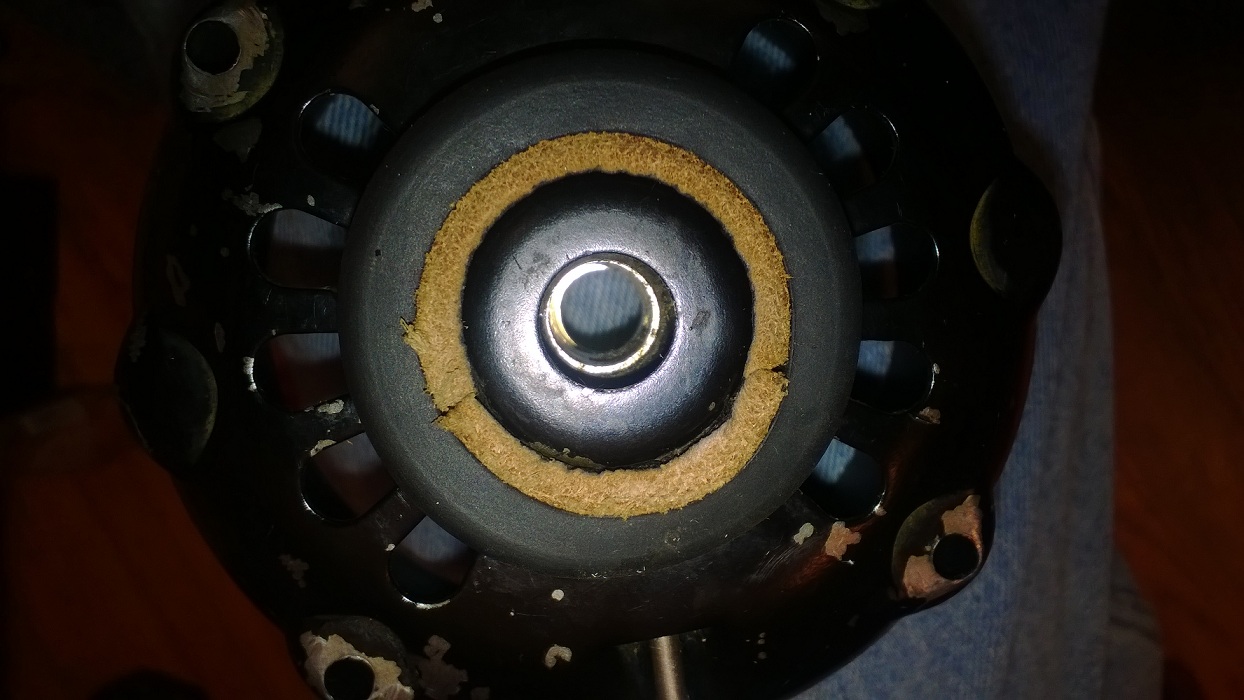

the rubber mounts were suppose to be the same size on both ends but one cap end was a good bit smaller ..an old leather belt solved the problem .
new head wires and drummed sanded the stator with 220 .
ready to go back into the box .
It's up to you of course but I think that some medium walnut, dye based, toner would even out the lighter walnut veneered portions of the cabinet. Nice work on the motor repairs by the way, and fixing the broken grill bars in the front.
