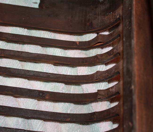

This is from inside the cabinet. The front of this cabinet is 3/8" plywood, covered with veneer. The delamination is the back layer of the plywood. It swelled up and bent the wrong way. It's not a big deal and it's less than 1/16" thick, but the grill cloth lays up against it, so we gotta fix it ASAP...

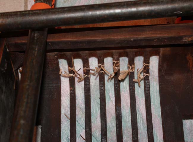

I repaired it by slitting each piece and removing a 1/16" slice, straight across. Then I glued each one, and clamped them with trash bag twisties.... They aren't really weight bearing structures, but each bit of wood adds stability to the grill. Plus, I want them flat when I install the grill cloth.
... and now we gotta let it all dry. We'll see how it comes out tomorrow..

I'll be removing the clamps in a few minutes. The cabinet has been clamped for about 18 hours, so I'm hoping it holds.

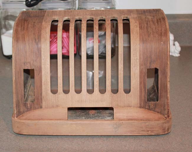

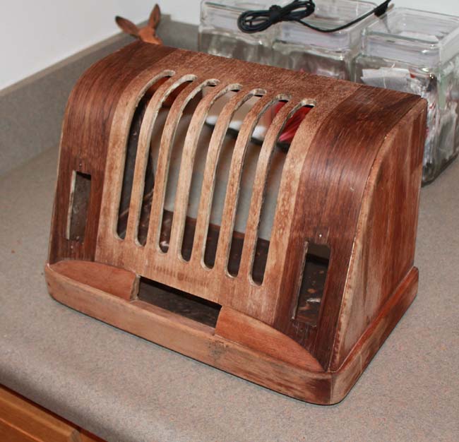

Clamps off. Everything looks fine as far as our repairs go. I do see some issues to correct. I refinished one of these same radios before, and noticed some things with the grain in the veneer. Somehow, over the years, the grain in this wood swells and becomes uneven. On this cabinet, the colors are also uneven. Maybe the water I used caused some staining, or maybe because the radio was in the mud?. .. I dunno.
My camera washes out certain colors, and brightens them up, so you cannot see it well.
My solution was to lightly sand the entire cabinet. Normally, I never sand an entire cabinet prior to refinishing. This is an exception. I want to highlight the color differences in the two veneers, and I don't want to worry about trying to hide discoloration. Anyhow, light sanding with 220 solved both problems. The veneer is now evenly colored and smooth. Next step is grain filling...

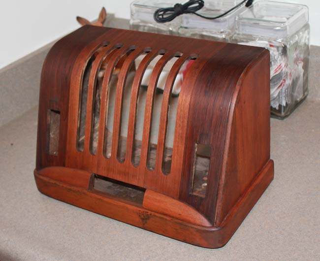

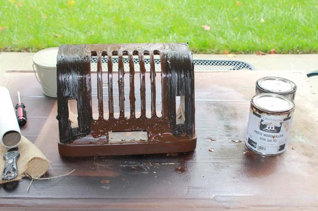

I've got the cabinet slathered in grain filler. I used two colors - Dark Oak and Dark Walnut. Both by Constantines. Again, the end goal is to emphasize the colors of the two different veneers on this cabinet.
Now for some opinionation...(is that a word?)
I think a radio like this was a cheap radio back in 1938. I don't think GE or Philco or any manufacturer used grain filler on cheap sets. So normally, I don't either. It's just a personal thing with me. I want them to be like they were when they were new. Keep that in mind if you use my techniques on your cabinet. I'm not going for perfection.
This radio gets different treatment for two reasons - It spent time outdoors, so the wood was in worse shape then when new.. and... this particular set has become valuable, so I want to make it look better than new.
I'll scrape off that grain filler now, and put it back in the can. Then rub down the cabinet with burlap. Then it'll need to dry all night. ..

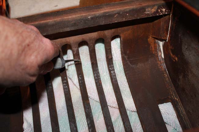

One more pic... here it is after using the burlap cloth and a dental pick.
Yup.. I said dental pick.. Sometimes little things get overlooked on forums because it's hard to post each little step. If you are doing this for the first time, you will find that grain filler gets into every crack, crevice and joint. Once the cabinet is clean, and I mean really clean... you gotta go over it with a dental pick (or similar tool) and clean out all of the corners and crevices that need to be sharp. The only place grain filler needs to be is in the grain... Now it needs to dry overnight..
