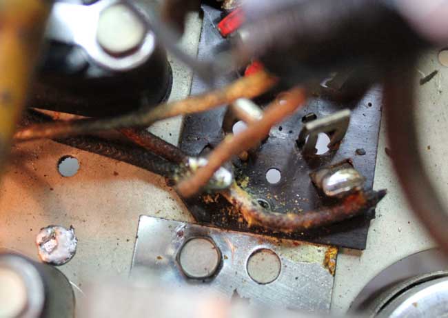

LAS, yes, I tested all the tubes. The 80 tested out good with no shorts showing on my tester. I could search the tube stash and try a different one. Speaking of a short plate to filament, check out this photo...
The brown wire is running to plate. The black wire is filament. The brown wire is pinned up against the filament terminal by the black wire. You can see that I pulled it forward about 1/2 inch to see if the covering had worn off. I couldn't detect a short, but we are both on the same page.
That could be a high resistance short which would arc and put AC into the cap as the voltage is raised.
From your resistance measurements, there is no B+ short and the transformer looks OK.
So it seems that its either the rectifier tube or the shorting wiring which may be the problem?
Thank you for helping me and hanging in there. I guess I will reroute that wire, try a different 80, and see what happens. You can't tell it from the photo, but the covering looked solid. The distressed area is mostly from me pulling on it with the needlenose. It is pinned in there awfully tight though.. I don't like it. Thanks to everyone who helped, you guys (and gals) are the best.

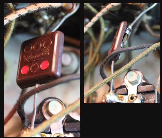

The only other thing that looks suspect is a micamold cap (see photo) that runs from the ground lug on bakelite block no. 7, to the bandswitch. Don't know if this could cause the issue, but I figured it was worth mentioning.

PuhPow: That mica cap should be easy enough to check. I've not seen many of these, but to me the shot of the underside looks a little strange. Can you disconnect one end of it and measure capacitance and continuity? This might provide an additional clue...
Ok, will do. I think I found a wiring error. According to the schematic, both electrolytic caps positive leads connect via a 5k resistor (no 44 on schem) and a .05mf cap (no 43). The other electrolytic cap does run to a .05 cap (inside the condensor bank), but I can find no such connection for the overheating electrolytic cap. It just has two positive leads, one running to the speaker and the other to filament, which then continues on into the transformer. Whoever installed these old electrolytics made some changes.
Resistor 44 and cap 43 were eliminated in later production so their being missing is not significant.
